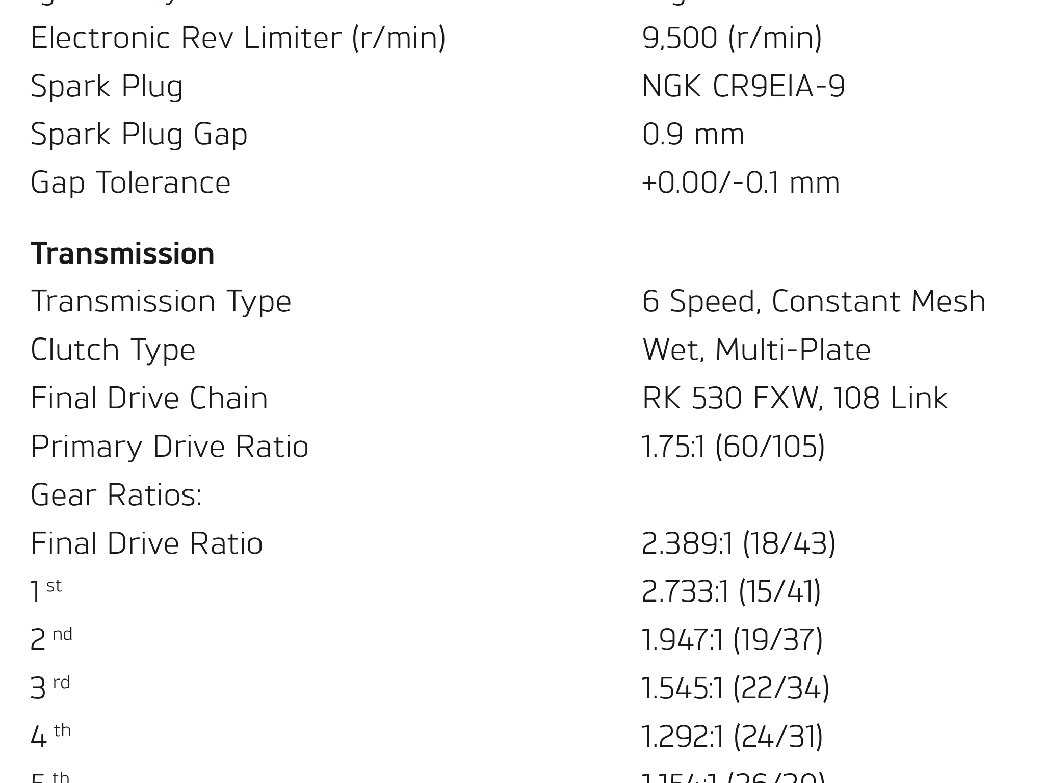

    Straight from the owners manual. My Street Triple had a RK chain as well.

    Thanks SteveRS, for interest this is what RK say on their website;
    Please use RK genuine cleaner/lubricant or equivalent product in terms of keeping quality of the chain.
    Please use a chain cleaner only for sealed ring chain. DO NOT use regular cleaner, which is not for sealed ring chain.
    Please DO NOT use gasoline, kerosene, break cleaner, carburetor cleaner, or anti-rust lube as these would harm sealed ring and shorten the lifetime of the chain.

    It's odd isn't it. Couldn't find any RK lube or cleaners for sale anywhere online, apart from a lube for karts. Was hoping to see what they are made of as the list of 'DO NOT USE' doesn't leave much and isn't always very specific.
