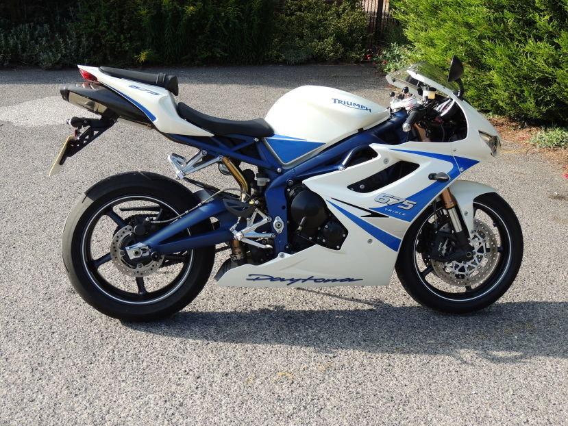

    Hello All, Names Lien and i ride a Daytona 675 2010 plate.
    new to this forum page and I could do with some help.
    Due to my circumstance I have had to leave my bike sitting for a few weeks and I come home the other day to find my bike making a high pitch constant whining. It hasn't been started in about 2 weeks battery is connected and so is an aftermarket tracker. Does anyone know what this noise could be ??
    I have had an issue with a intermittent high pitch beep which was just a 10amp alarm fuse but this is a constant high pitch tone (possible dead battery I'm not sure)
    If anyone can help or give some suggestions I'm all ears !
    Thanks in advance Lien!

    Sounds like the battery has been drained by the Alarm & Tracker (one of them is squealing). I had both on a KTM 690 I had, after a week the battery had been drained to make starting a pain!
    Get an "Optimate" charger keep the battery tendered!
    Nice looking bike!:p

    The is you very much. Thought it would be the battery being dead but diddnt want to fuck it up even more

    Hi Lien and welcome. Agree with Stripplemont on the battery being the culprit. Let us know if you sort it.
