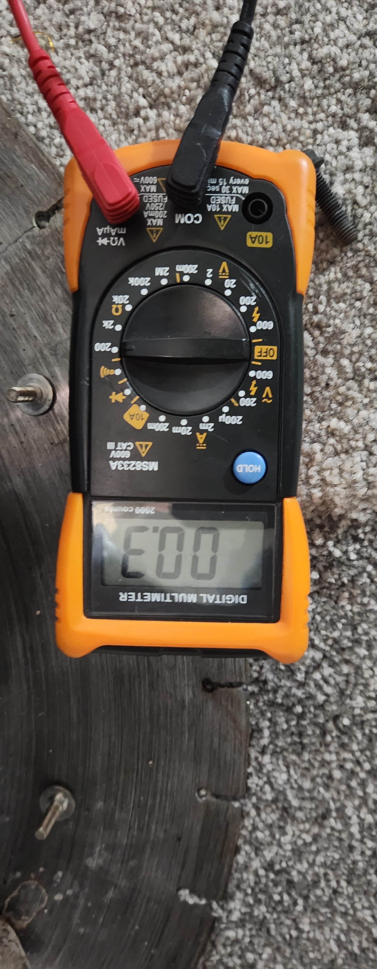

    I bought another multimeter so I could set the ohms manually and unfortunately the stator looks to be knackered too, the ohms are supposed to be between 0.4 to 0.6 and I am inly getting 0.3 (pictured below) and sometimes flickers to 0.4 so looks like I'm gonna have to replace both, I'm looking at the ultimate rectifier and a stator from a reputable company like Electrex World but stators all seem pretty much the same, thankyou again for all your help, I just wanted to give you an update and I'll let you know when they have been fitted if it works:yum
