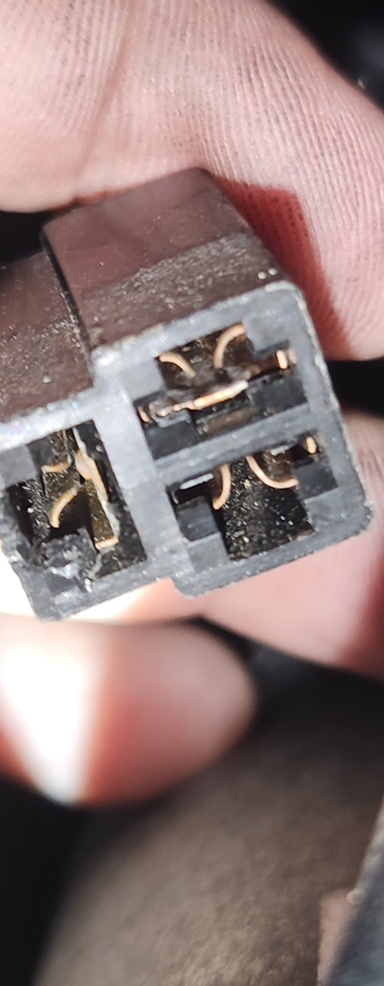

    You should be able to check continuity by pushing the needle point probes of your meter in to the outside of the plugs for the connections that aline. If that doesn’t work then pull the plugs apart and see that they are visible clean dry and free from corrosion on the inside.

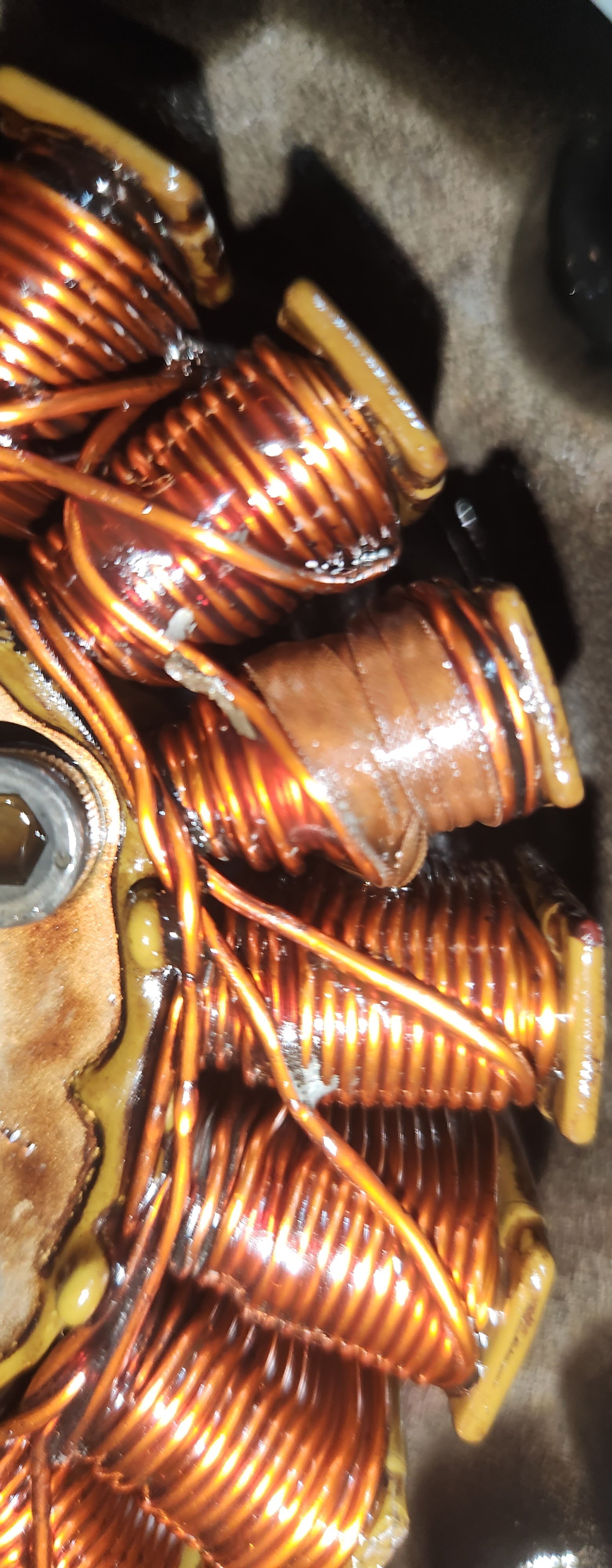

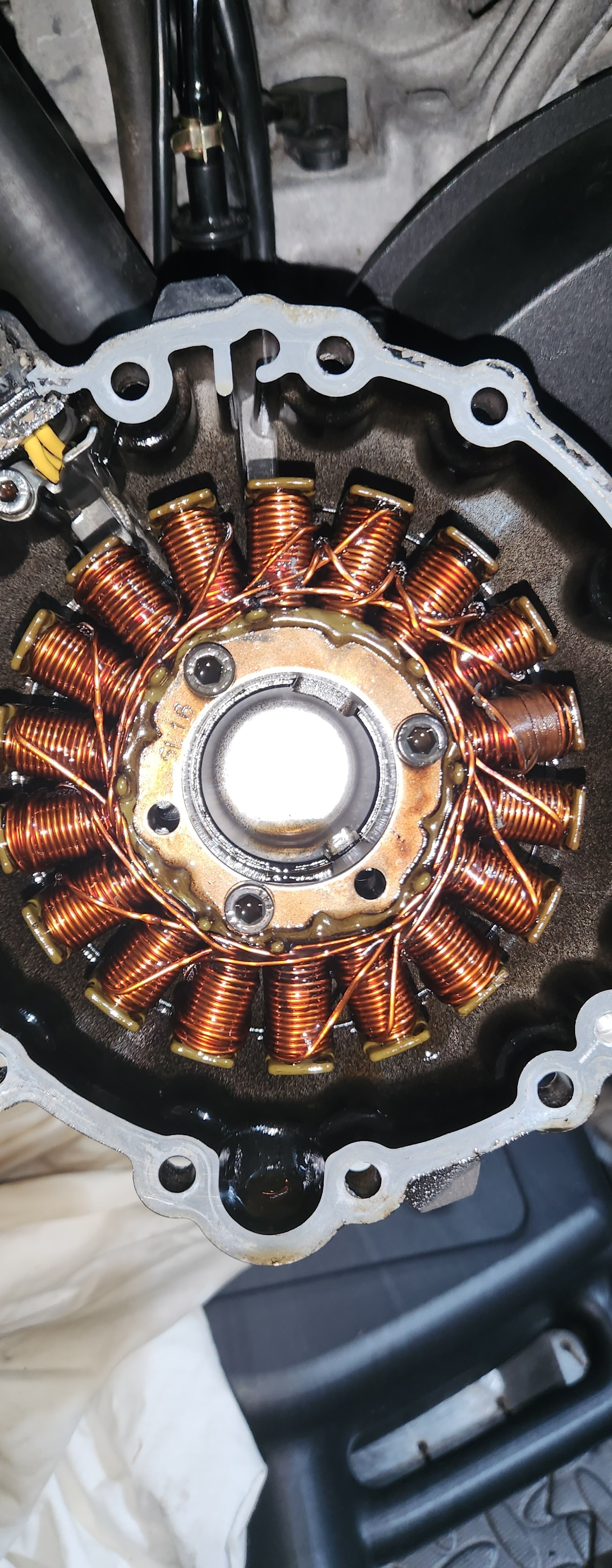

    I don’t know enough regards testing the reg/rec unit or alternator but if you remove the cover from the alternator it should look similar to the ones on eBay if alls well as in an even copper colour. If it’s defective you normally see a much darker brown or black area that’s burnt out and it smells like it’s cooked.

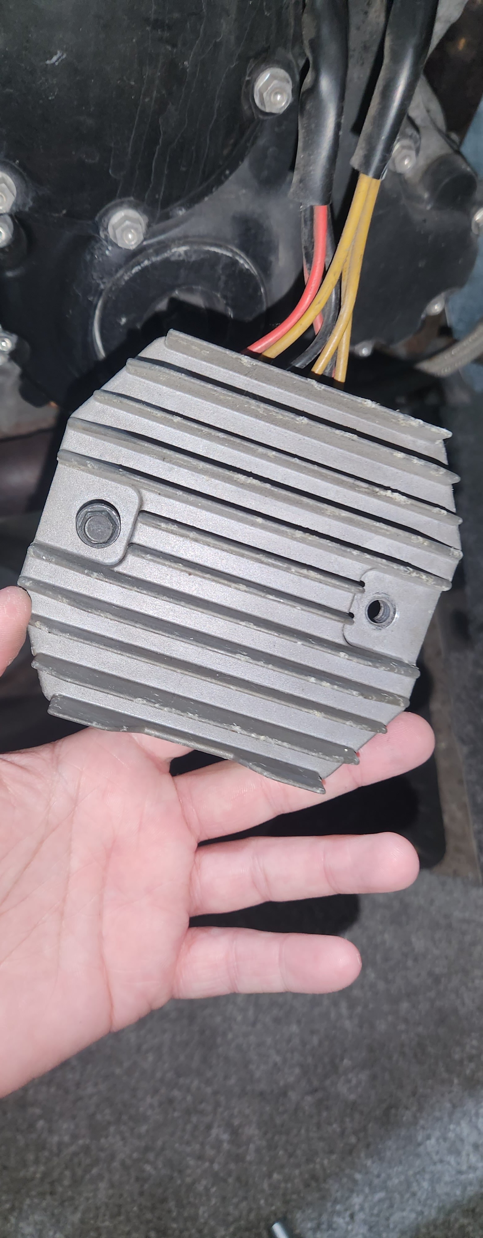

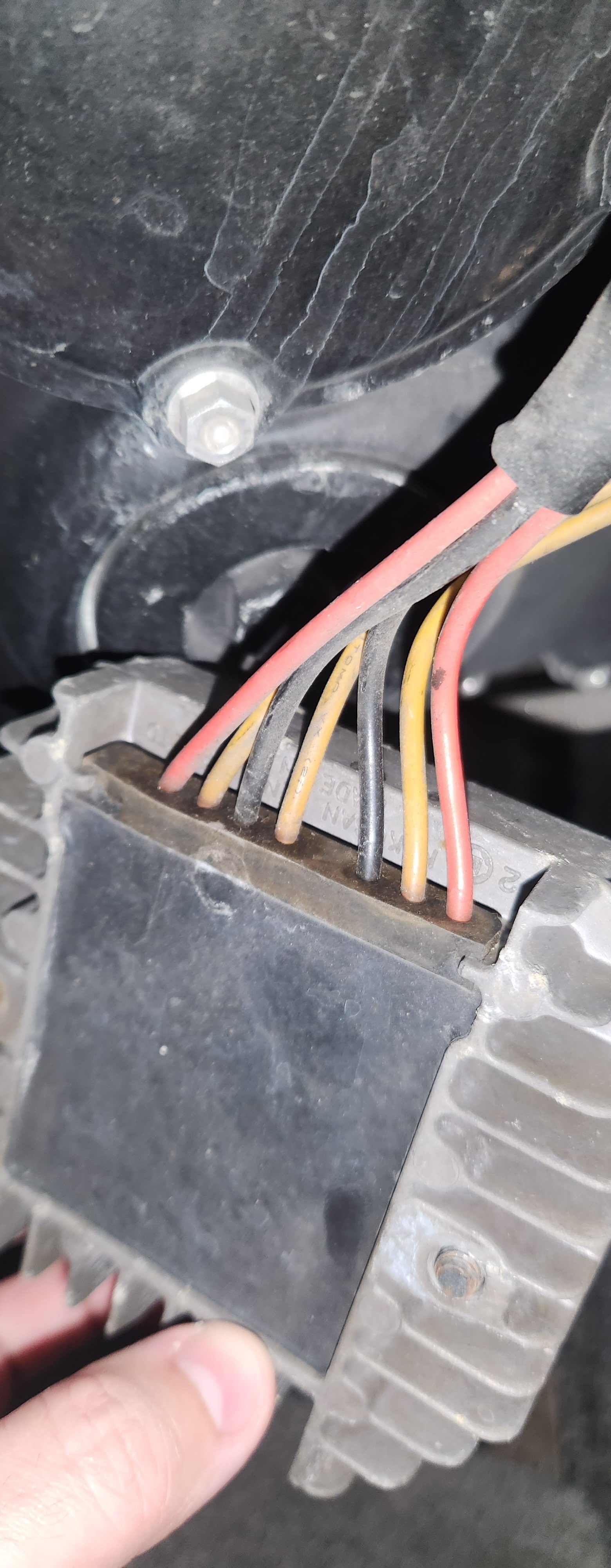

    That thing in your hand is the reg/rec. The three yellow wires should all be carrying AC being generated by the stator which is the brown coppery thing referred to by @Boothman if you trace back to the connectors you will be getting AC across any two yellow wires as the generating is 3 phase. Not sure of the value but around 200v is common. Set your meter nice and high, 750 or 1000 volt range is normally available. That way you're covered safely. More accurately, your meter's covered :p Also, set your meter to DC volts 20v range and you can check if DC is coming from the black and red wires. That's going to your battery to keep it charged. :)

    Thank you all for your continued help with this issue I took the bike apart today and tested the stator across the 3 yellow wires in the connector block (photo below) which has continuity across all wires but was getting either a very low Reading or no Reading when testing the ohms but the coil itself looks okay so is it possible that the coil is knackered without being able to see the damage because I've heard when the rectifier/regulator goes it can take the stator with it damage there that I just can't see, also I do have the manual and the Haynes manual and it's supposed to be between 0.4 and 0.6 which is not just a clarify my above point and the inside of the wire connections look pretty clean too so I doubt is that either

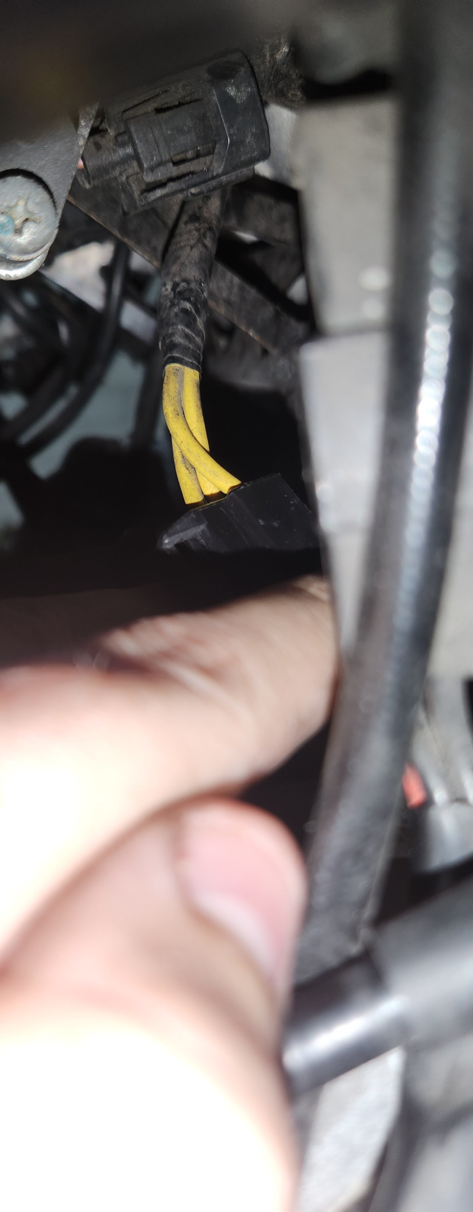

    Agreed mate, visually all looks good. Does that three pin connector have the yellow wires going into it? If so you can test the AC by starting the bike and reading across the alternator side of the wiring. Can run the bike with the alternator disconnected. Anyway, big bird for me shortly so l'll wish you luck and wait for your next report :)

    Yes it did have 3 yellow wired from the regulator/rectifier but I disconnected it to test it, not sure how to test the ac side as there seems to be no wired to test unless that's under the air box where the stator wire leads to, also doesn't feel particularly safe starting the bike with that hanging off and I've had to drain the oil to get to the stator so probably wouldn't be very good for the bike either surely, but thanks for the ideas and enjoy your big bird :cool:

    So it's looking like it could be the reg/rec at fault and you need to test it. MOSFET seems to be a good aftermarket unit if you do need to replace it.

    I have to say with the stator looking so clean makes me wonder if I tested it correctly, all I did was took the 3 yellow wire connector apart and tested it across the pins in each combination with the battery connected and the ignotion off, is that correct cos I don't wanna replace it if it's working but also don't really wanna start the engine when it has no oil in it now to test it while it's on incase I wreck something else, Is there another way or is it worth me connecting my battery back up and testing again, I can get a decent upgraded mosfet rectifier seperare from the stator if I can make sure it works but I don't want to put it back together and fill it with oil again to be able to test it if I then might have to drain it and take it apart again if that makes sense

    Damn wish I knew that before I was following a Haynes manual :confounded: it mentioned about if it was on a side stand then to empty it so I thought better safe than sorry, I have reconnected the battery to test the stator connections again cos it looks too clean to be broke, do I need to wait for a while to let the coils in the stator charge or can I test it straight away? Also is it still OK to do this test while the stator is outside of its housing like this (it's still connected)
    Edit - I just ReConnected the battery and try to retesting but I'm still getting no result it is showing it has continuity but is Reading zero homes so and starting to wonder if i'm doing something wrong or maybe that this multimeter is just not good enough, because it is an automatic multimeter it looks like it is set to continuity and ohms when I connect the wires then it also has a k next to the logo so I'm guessing that I am looking for 0.004 to 0.006 maybe

    Those coils don't charge up. Imagine it as the reverse of an electric motor. Rather than power giving motion, motion (engine rotation) gives power. No point testing without engine running :)
