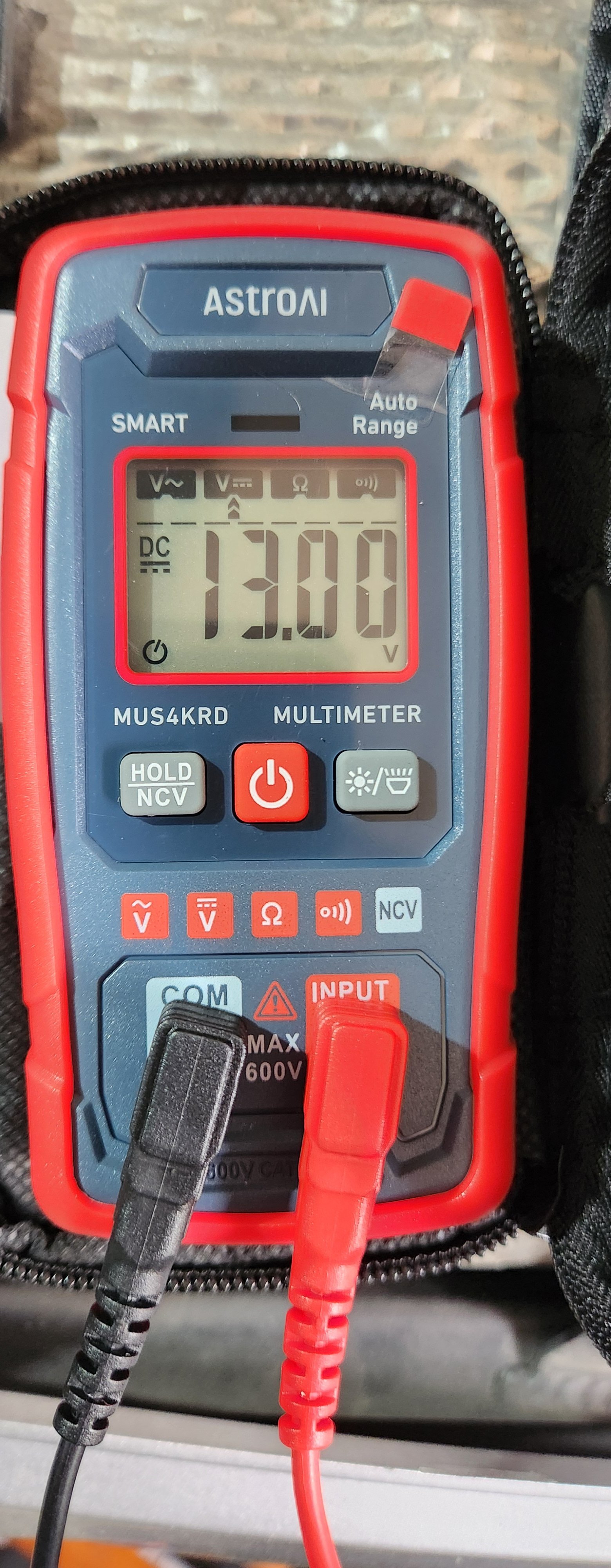

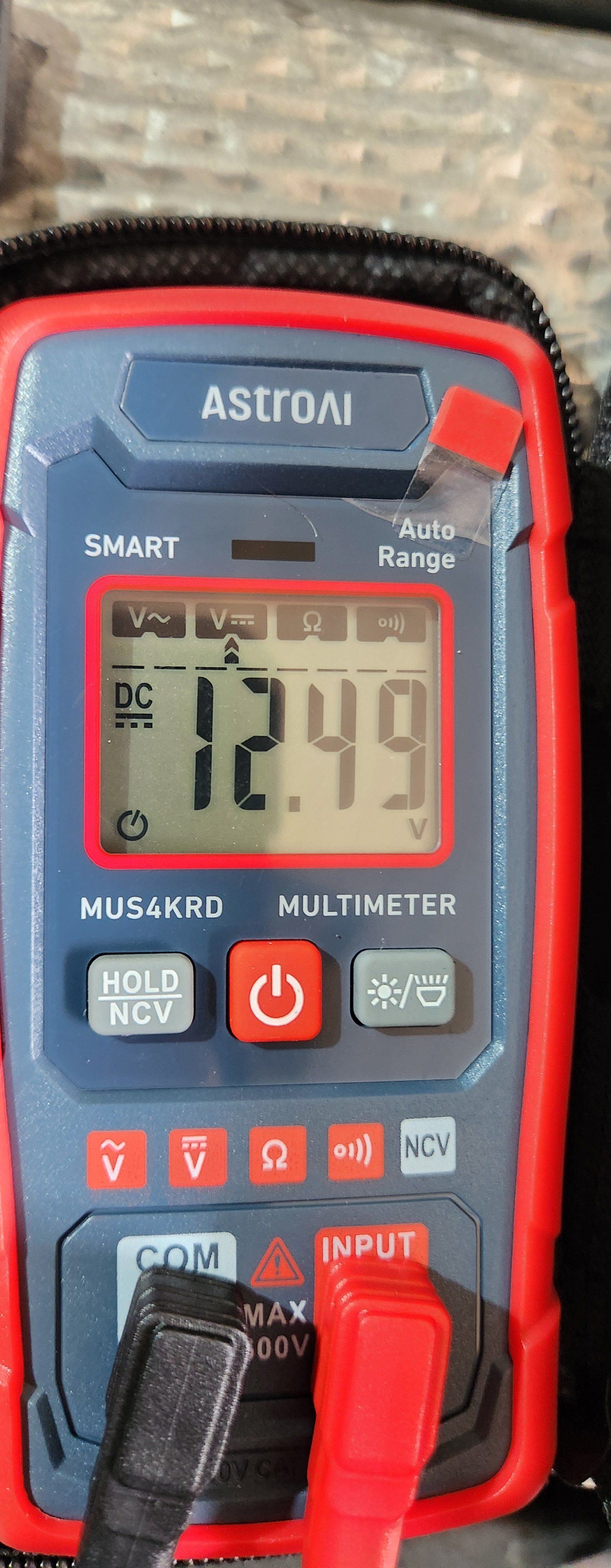

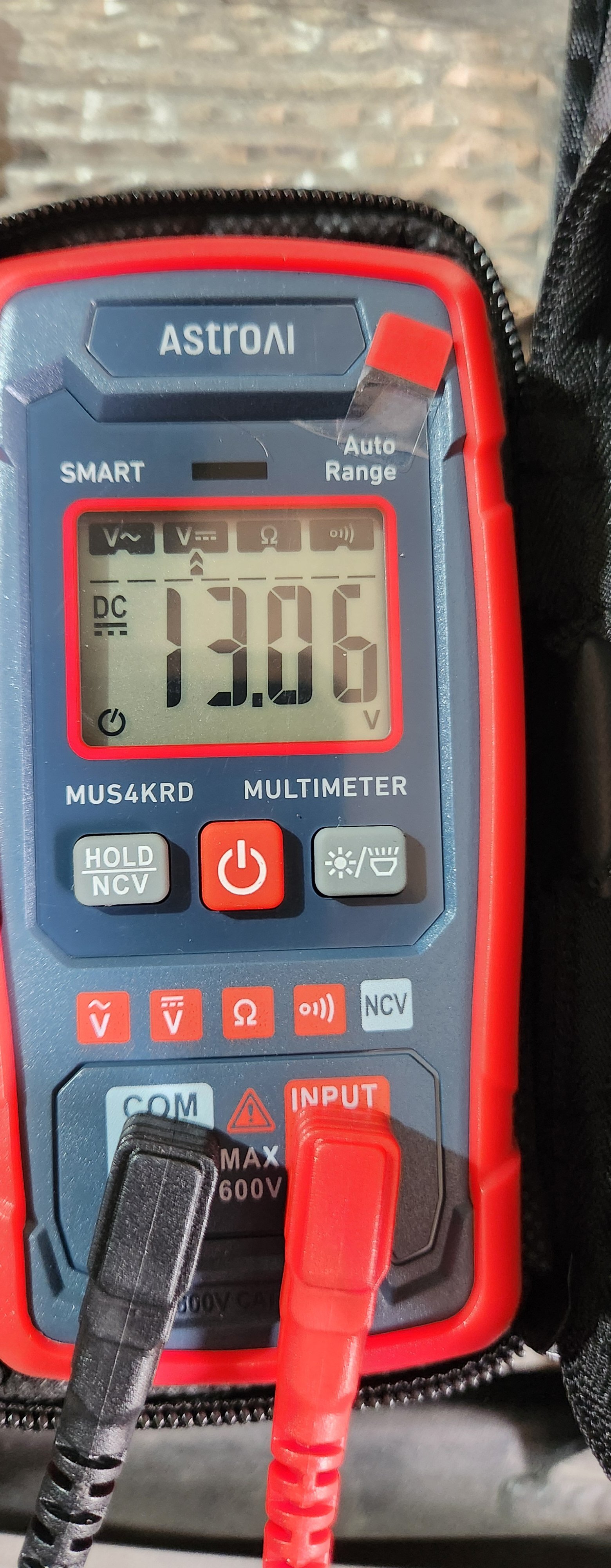

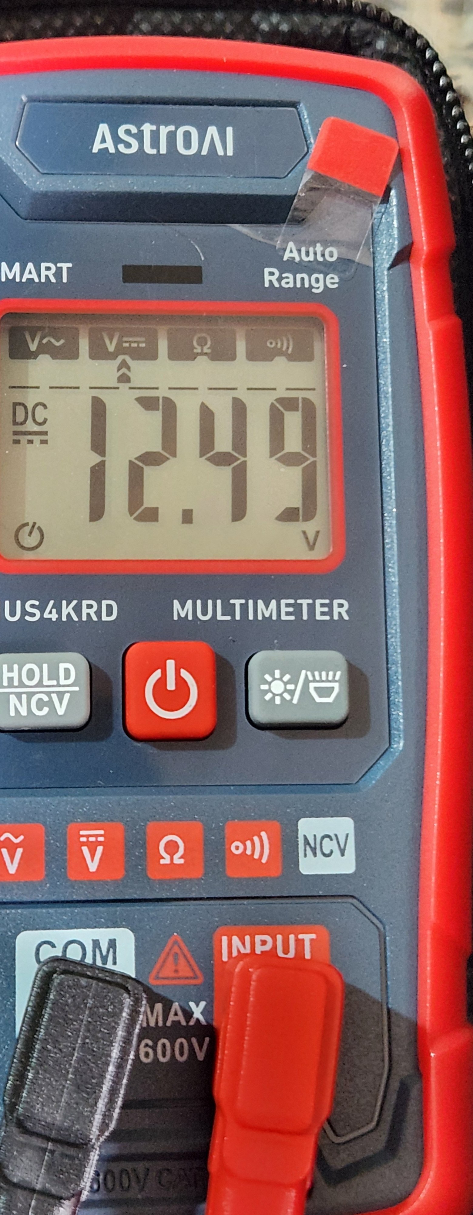

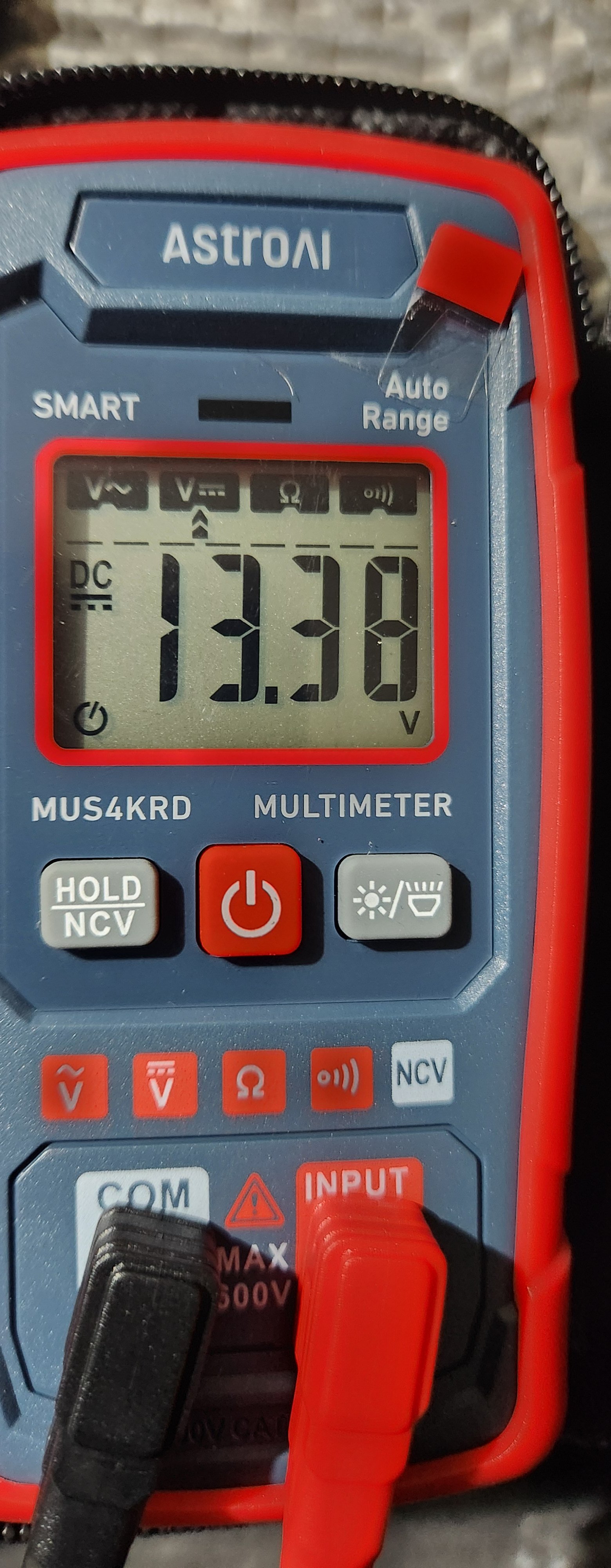

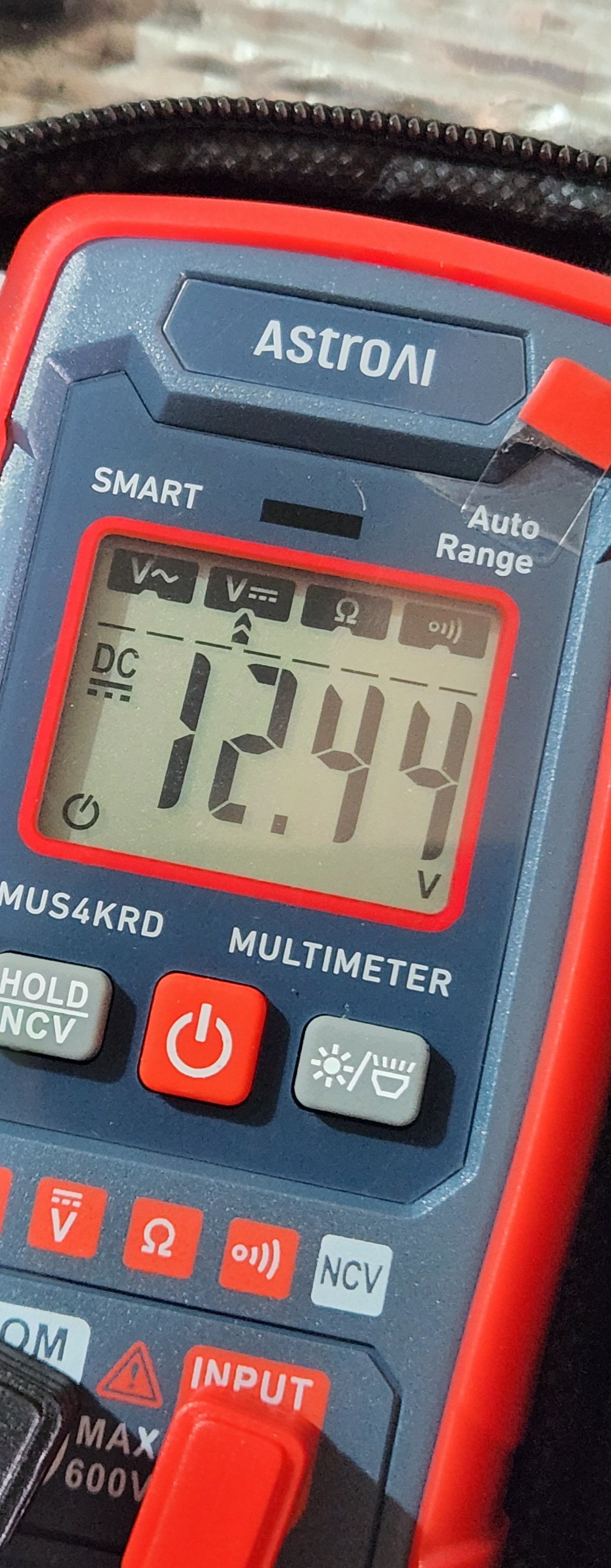

    I received my new dummy proof multimeter today and tested the battery, first pic is just after I took it off trickle charge 13.38v then I turned the bike on and got the second pic 12.49v then I waited till the bike warmed up for a few minutes and again got 12.49v and a minute or so later I got 12.44 then I done the test whilst reving which I took a video of, link is below
    https://youtube.com/shorts/Giy9wdNP0Iw?si=YBjJtpIvIQbt-fs4
    Then I turned the bike off and took a video of what was happening which also shows the battery, that video is below (just to say the part next to the battery was seated properly and did have a cover over it but I took it out so I could see the fuse which looks ok)
    https://youtube.com/shorts/1tWmjrOdWBw?si=OauOCRIFlsmDtLUT

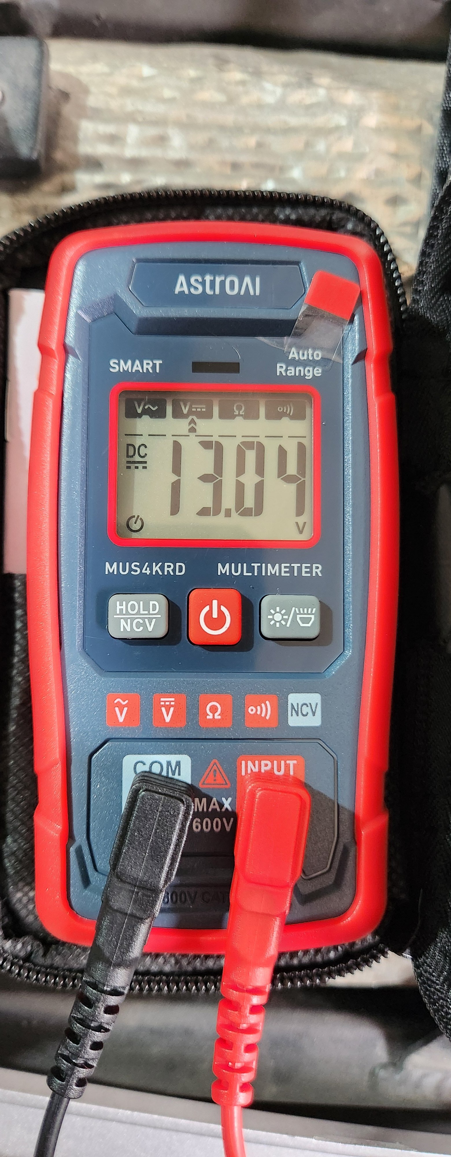

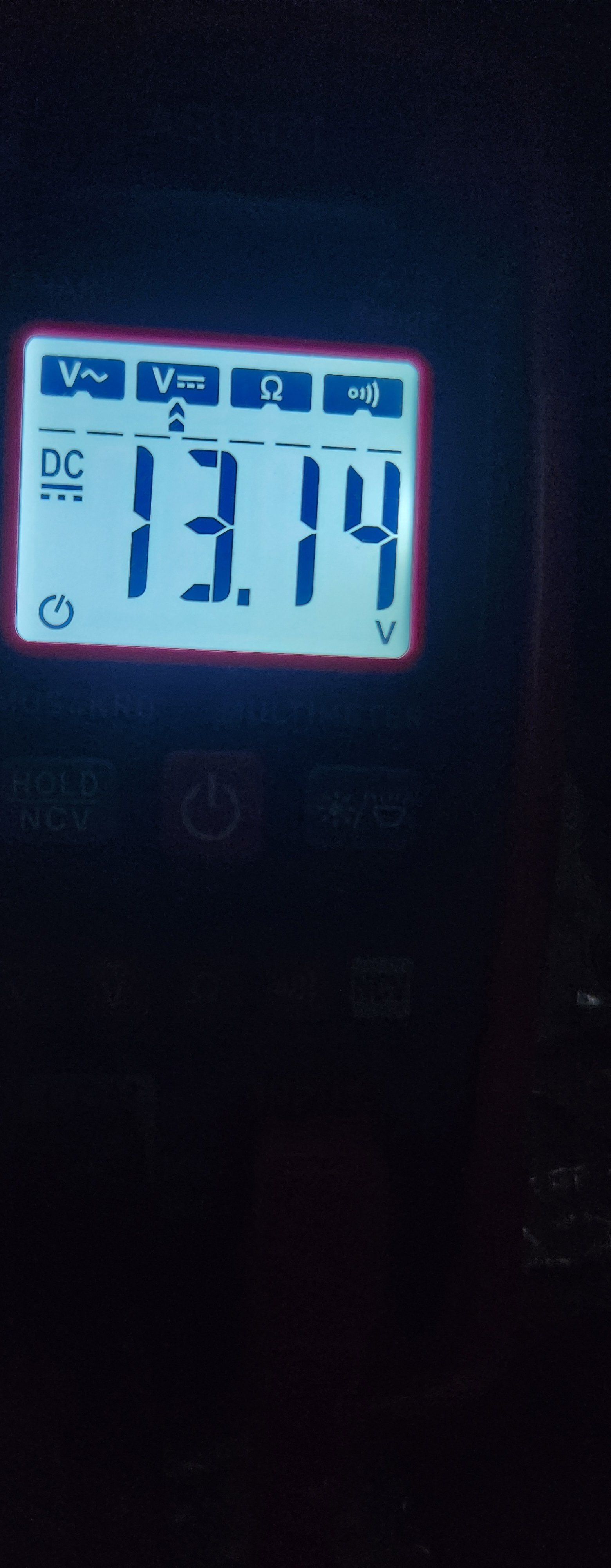

    Then the last 3 pics I took (about every minute of so) were of what was happening to the voltage while the bike was off and cooling down then the last one with the screen illuminated was after 15minutes.
    From what you guys have said it looks like the voltage is climbing even while off which confuses the hell out of me
    I hope this makes sense to someone but if there is anything I messed out which may help let me know please

    When you take the battery off the charger you should wait about 30 minutes before checking the voltage or you will get a false reading. It looks like the bike is not charging the battery so you need to check the alternator and the regulator/rectifier. I would first remove the alternator cover to see if there is any evidence of burnt windings. You need to consult a workshop manual or the Internet to see how to check the electrical components. The reg/rec seems to have been an issue on early models like yours as it was badly located and it was moved to a new location on later models. It gets hot and has a finned heat sink which ideally needs to be in the air flow to keep it cool. A Mosfet aftermarket replacement reg/rec seems to have been a common choice.

    Good info and the minor fluctuations after being turned off could just be temperature related. The main thing for me is when you reved the bike the voltage dropped significantly which (and I’m no electrician) points to no charge coming from the engine.
    You could take a picture of what’s happening at tick over, go for a 10 minute ride round back to your house and then take another photo of what’s happening on tick over to see how much the voltage has dropped after the battery has been running under load for that time.
    With the ignition turned off have you checked the plug connections on the regulator and rectifier to ensure they are clean, dry (with no sign of corrosion) in general good order and fully seated giving electrical continuity across each wire?

    I would expect a good fully charged battery to be at least 12.6v after standing for about a day but 12.8v would be better. The alternator produces AC which is then converted to DC by the rectifier to power the electrics and charge the battery. The regulator prevents the battery from being overcharged. The rectifier and regulator is combined into one unit.

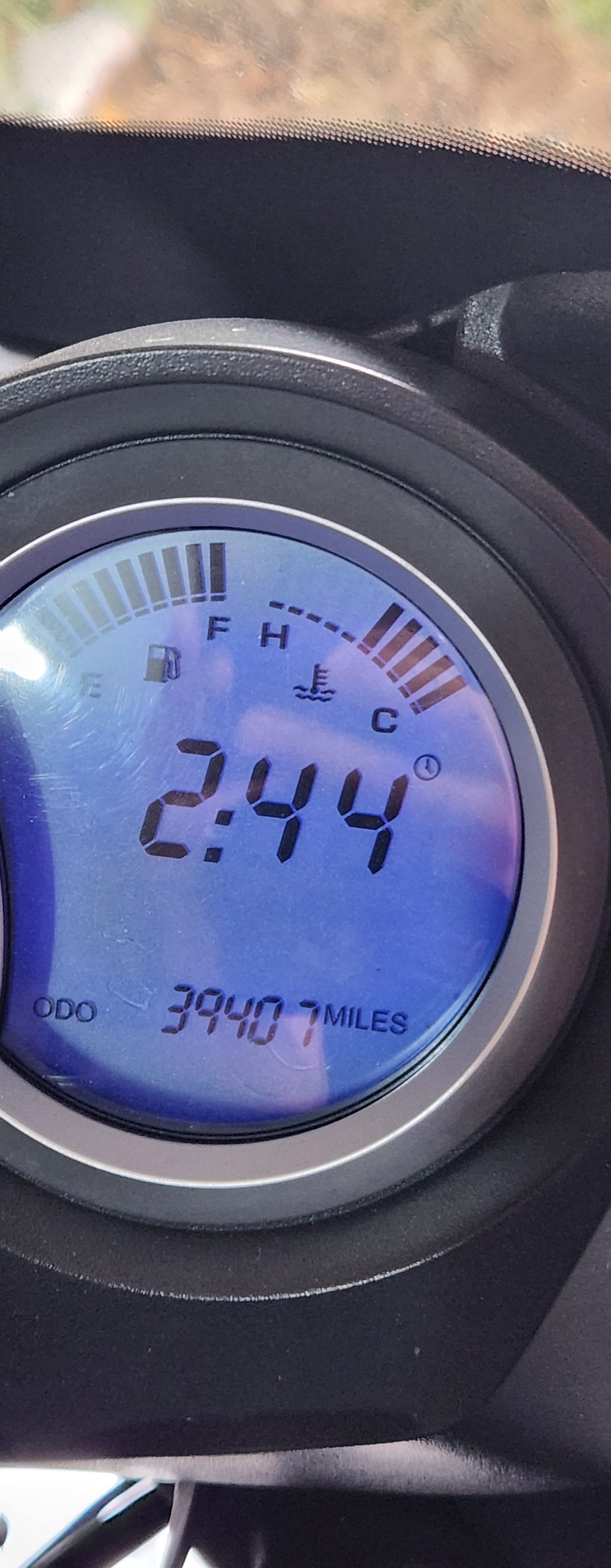

    Hey guys I have just redone the tests after still not being on trickle charge since my last test on friday and the results were
    13.13v before starting
    12.35v after starting whilst still cold
    12.30v after warmed up then the video shows me reving the bike and it cut out while I was filming then I took a picture of the dash after the bike had cut out (apologies for the talking in the vid I had someone help record to make sure I could film and hold multimeter secure whilst reving)
    https://youtube.com/shorts/WR3N7UiL3j4?si=hxos9mi_M45EgJ_e

    That looks like it's not charging. You'd do better to increase rpm and hold a steady engine speed rather than blipping the throttle like that. Around 3k rpm for 10 seconds or so, see what voltage it gives

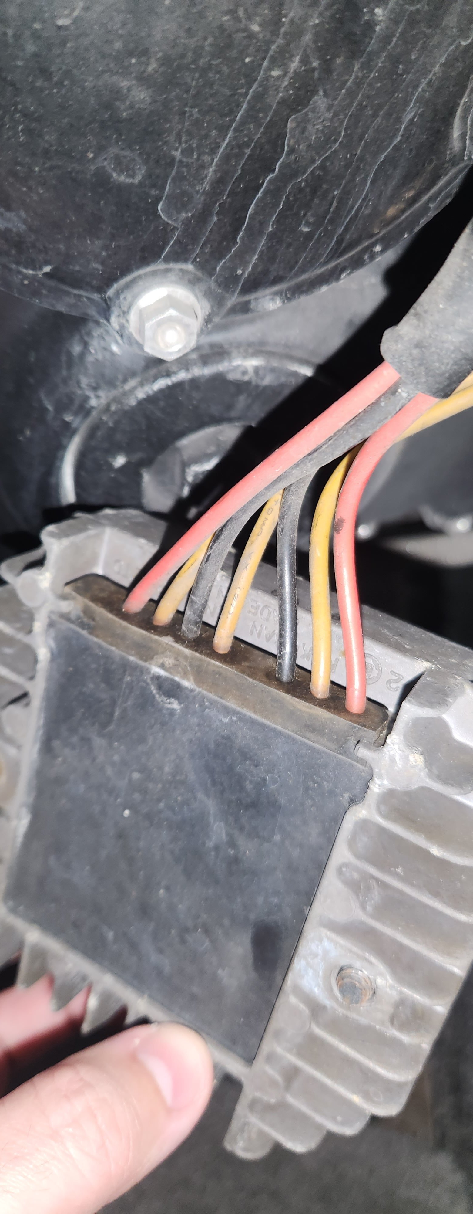

    Hey Boothman I managed to take the fairing off and took a few quick pics but looks ok tho the connections are dirty they are solid and clean on the inside, not sure where I would need to place the multimeter to do a continuity test

    OK so I think the main question now is, is there a way to test the stator/alternator (seems like the same part from most of the diagrams) and same for the regulator/rectifier or am I better off replacing both to be safe, in which case is there a preferred aftermarket one because i have found many on eBay but they seem a bit too cheap to be trusted
