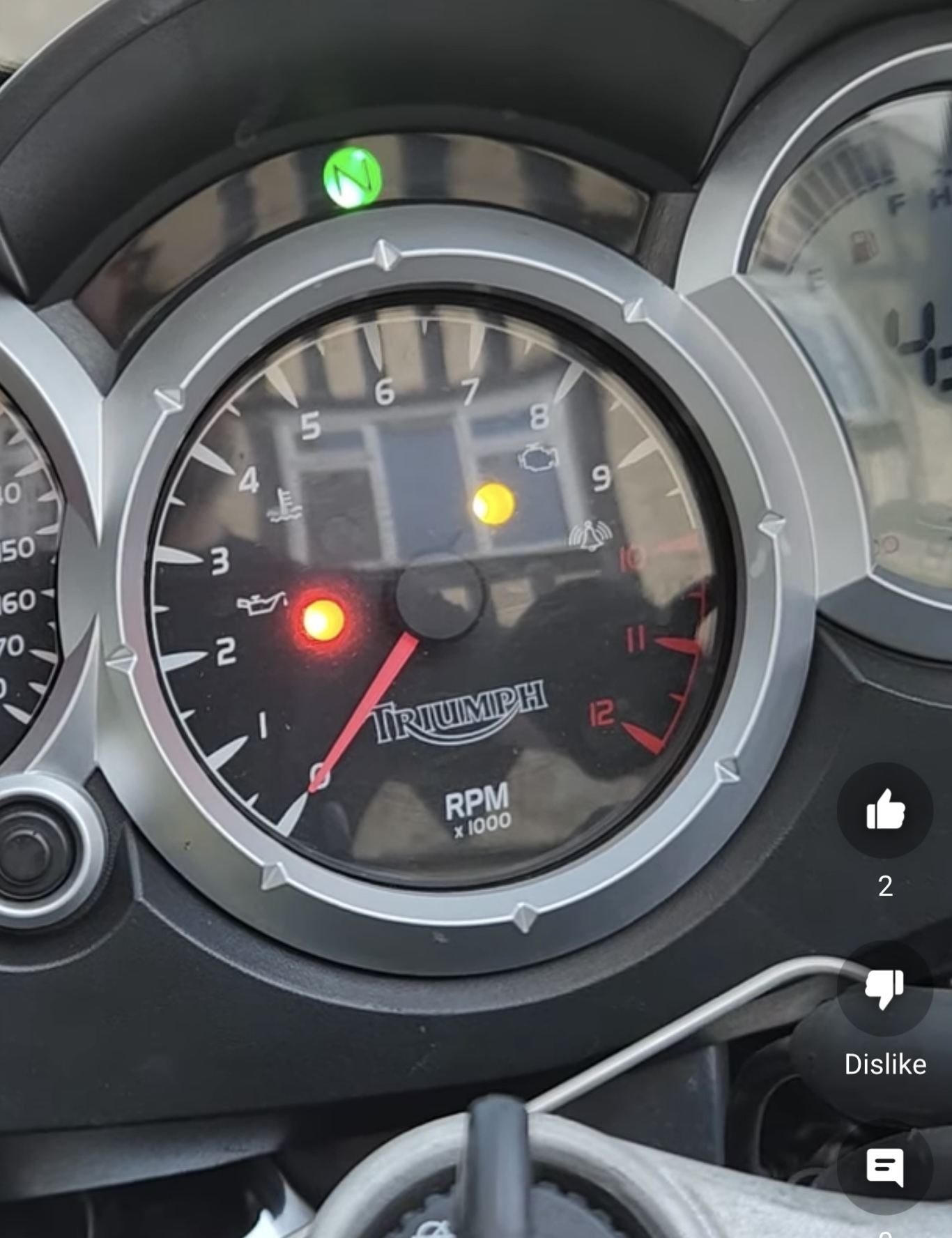

    Assume the MIL light is the yellow one (screen shot from @Tim - Sprint ST 1050 video) as from what I can see the tank is full so not a low fuel lamp or is it an ABS light.
    EDIT - Not fuel light as watched the video again and the low fuel light is next to the neutral lamp

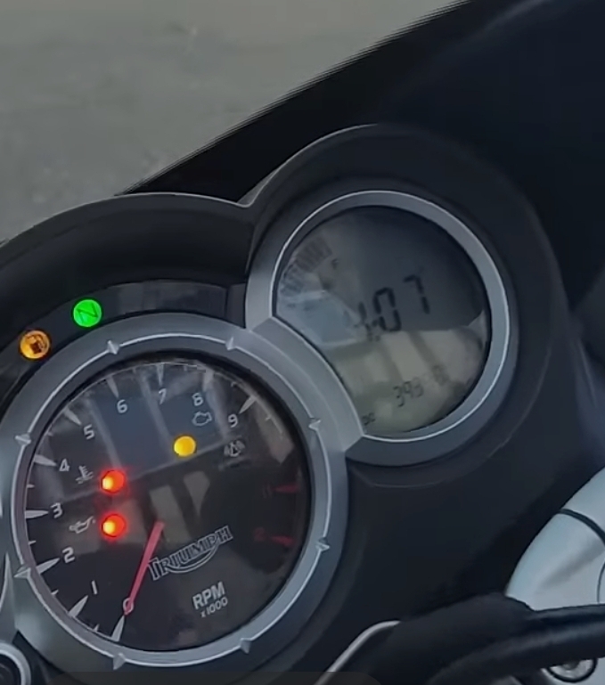

    Your correct it has a full tank tho after trying to start the fuel light does come on which you can see right near the end of the video after trying to start it the second time which I have uploaded a pic of
    Edit - not sure if thats supposed to happen when it doesn't start because the oil light comes on at the same time
