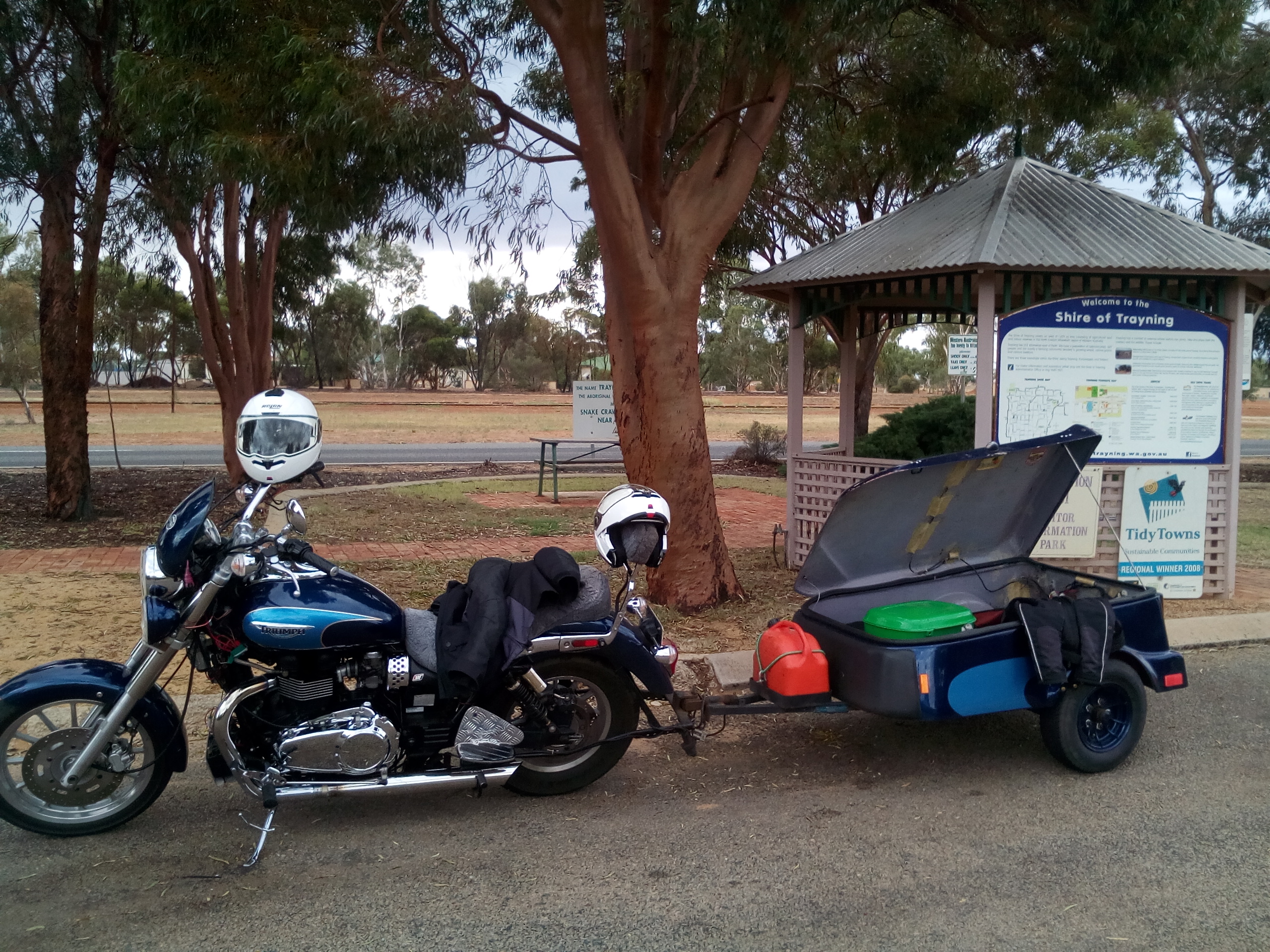

Hi "dilligaf", I see in another section you are going ahead with the trailer idea, hows the tow hitch working out ? If you go no springs on the trailer, use tyre pressures to spring/suspend the trailer. It's how the trailer in my picture above works! 6psi empty upto 12/14 psi fully loaded. If you inflate to recommended tyre pressures on the side wall of the tyres It bounces!!! Seen my trailer go 2ft off the the ground with 26psi ! Cheers capt.

Hi dilligaf, if you'd like I could take pictures or measurements of my trailer and email direct to you . if you are interested ? Cheers capt.
Cheers mate The car roof box and trailer kit when it arrives will dictate my measurements Until the kit gets here I'm pretty much stuck in limbo I have been studying your bike pictures and TEZs bike as well as others so pretty much gonna wing it Have a good idea how it's gonna look when it's finished and I'm aiming to use it for the farmyard rally in about four weeks time Fingers crossed but don't worry I won't use it until it's finished properly and I think it's safe to do so Thanks for your kind offer though mate Update Just had a text from courier Wheel kit sometime tomorrow Bring it on
