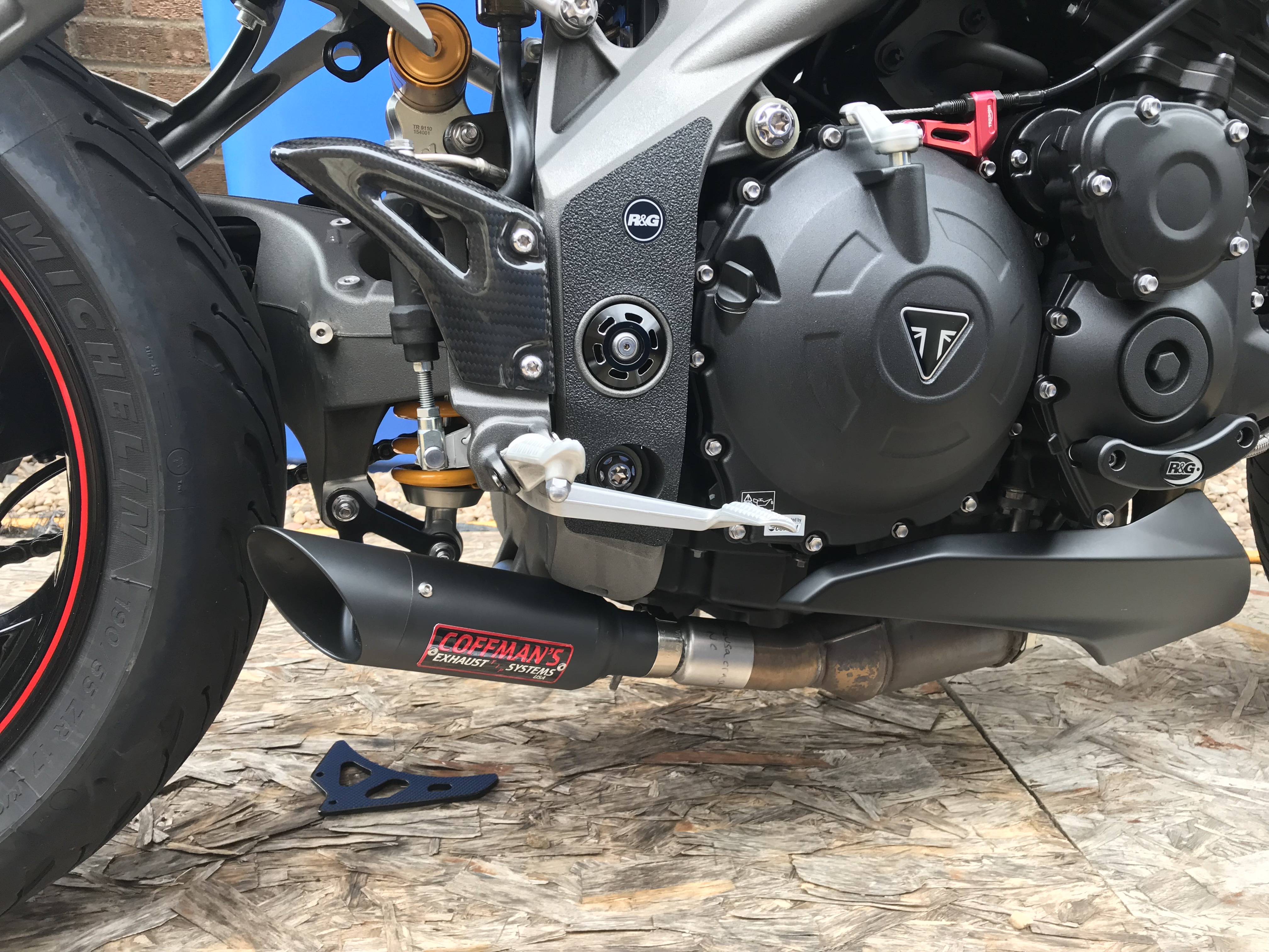

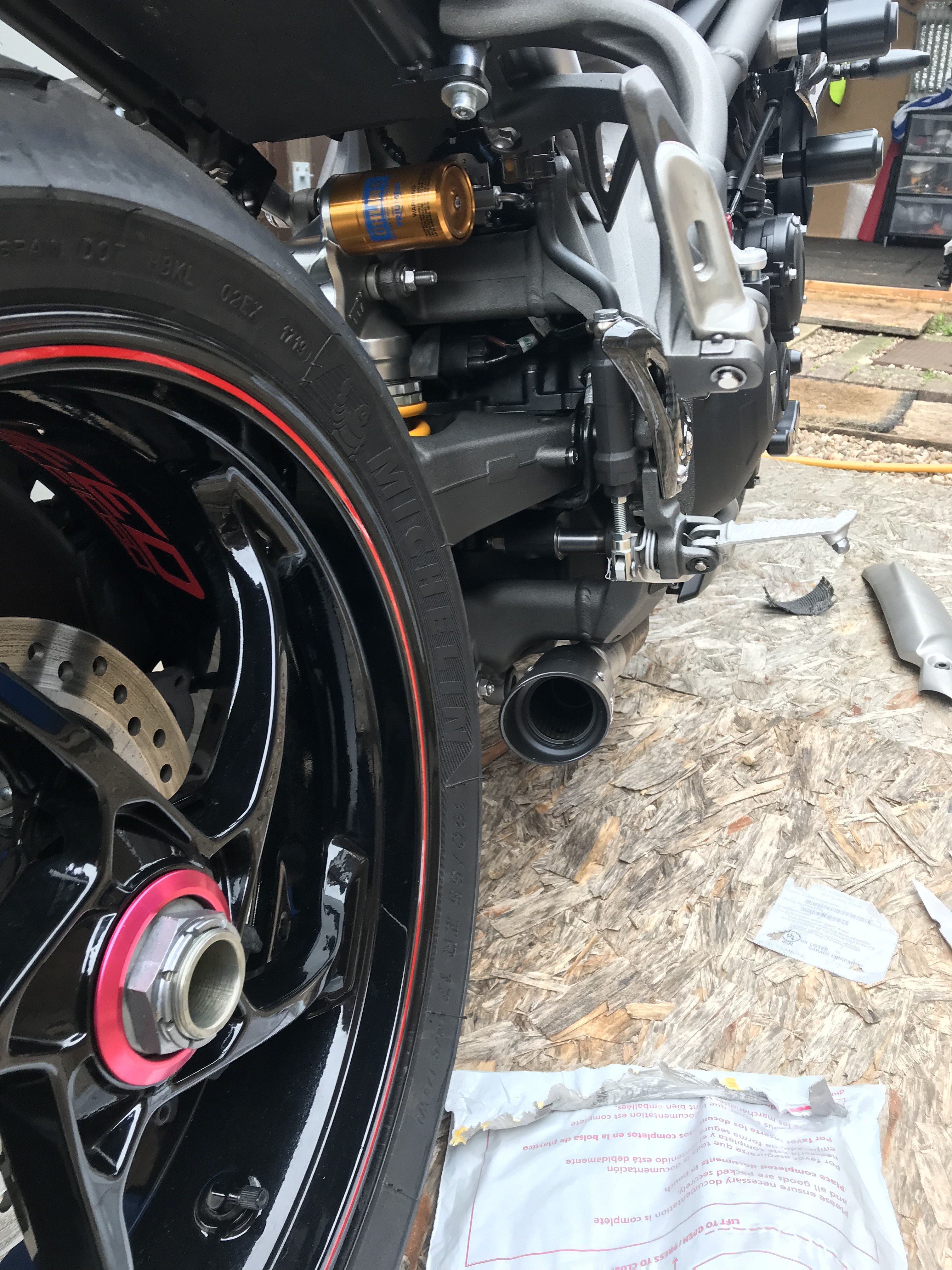

    Well, there's nothing wrong with the arrows exhaust but i came across a CBR250 R COFFMANS exhaust on ebay. Almost perfect condition so I took a risk and figured if it didn’t work out , I could sell it for £100 again to a honda cbr owner!
    I had these (X2) on the busa and they sounded amazing.

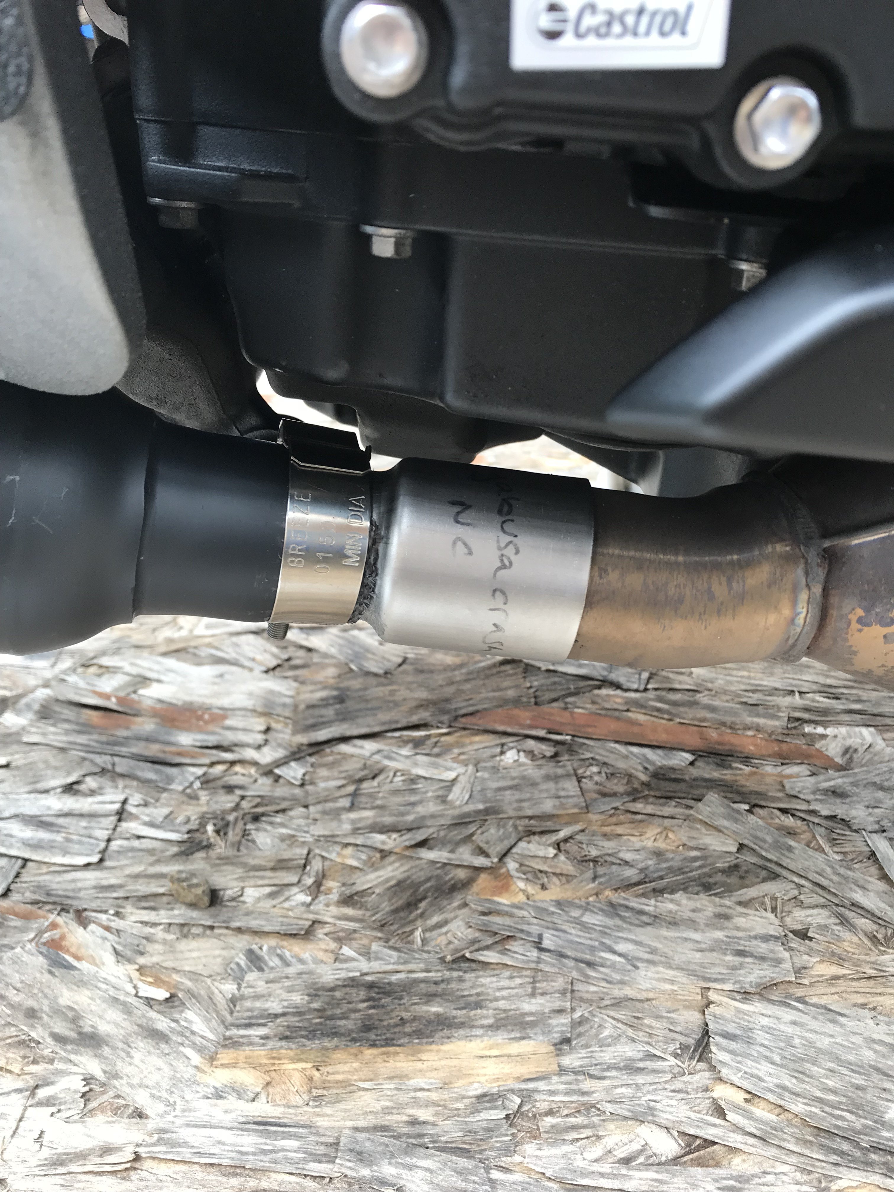

    It was a buy it now of £100 so as I knew that the outlet of the triple was 45mm and the inlet of the coffmans was 40mm, I had an exhaust reducer made (with a 10 degree angle to clear the tyre) to reduce it and had a split put in on the triple exhaust side (only!). 4" long also. All for £25! (also on ebay. Just email them a pic with measurements)
    Results are below and tbh, for an all in cost of £125, I really can’t be happier!
    The sound is amazing. Really is.
    Coffmans dont make one for the triple but do one for the speed. Well worth it but don’t forget import tax and postage etc!!

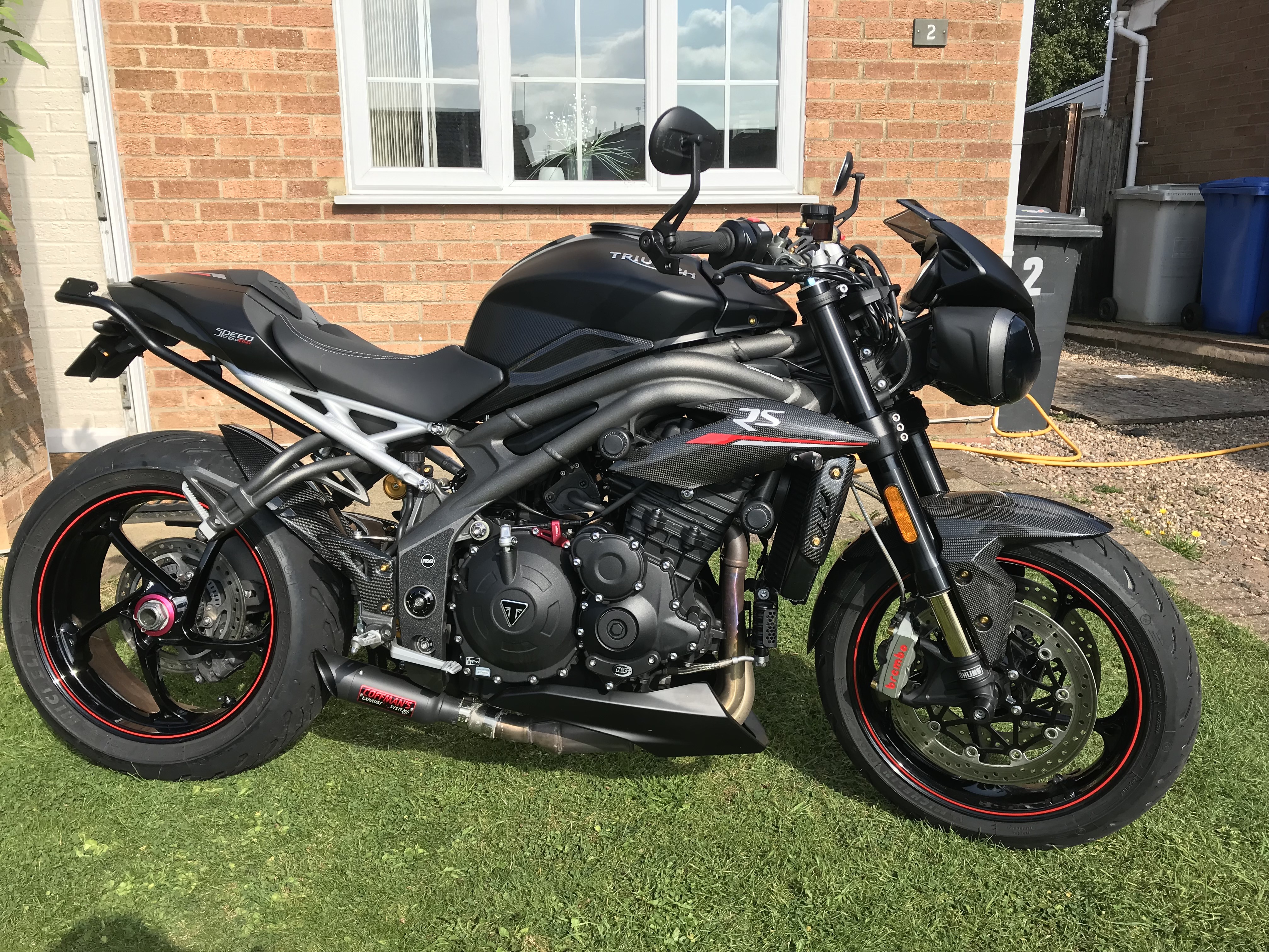

    Guessing the neighbours don’t approve was the pipe made specifically for the speed triple?
    Here’s mine..

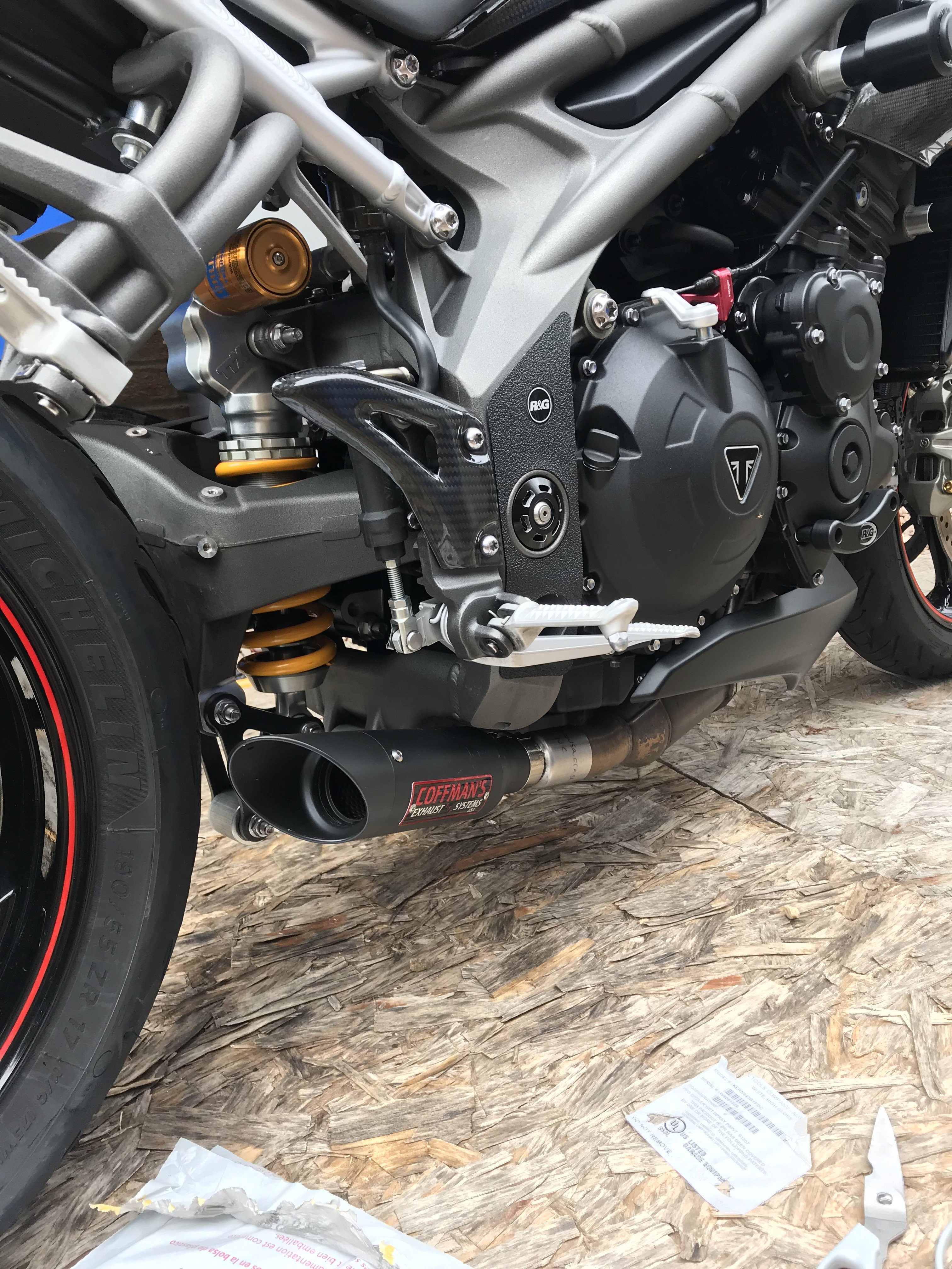

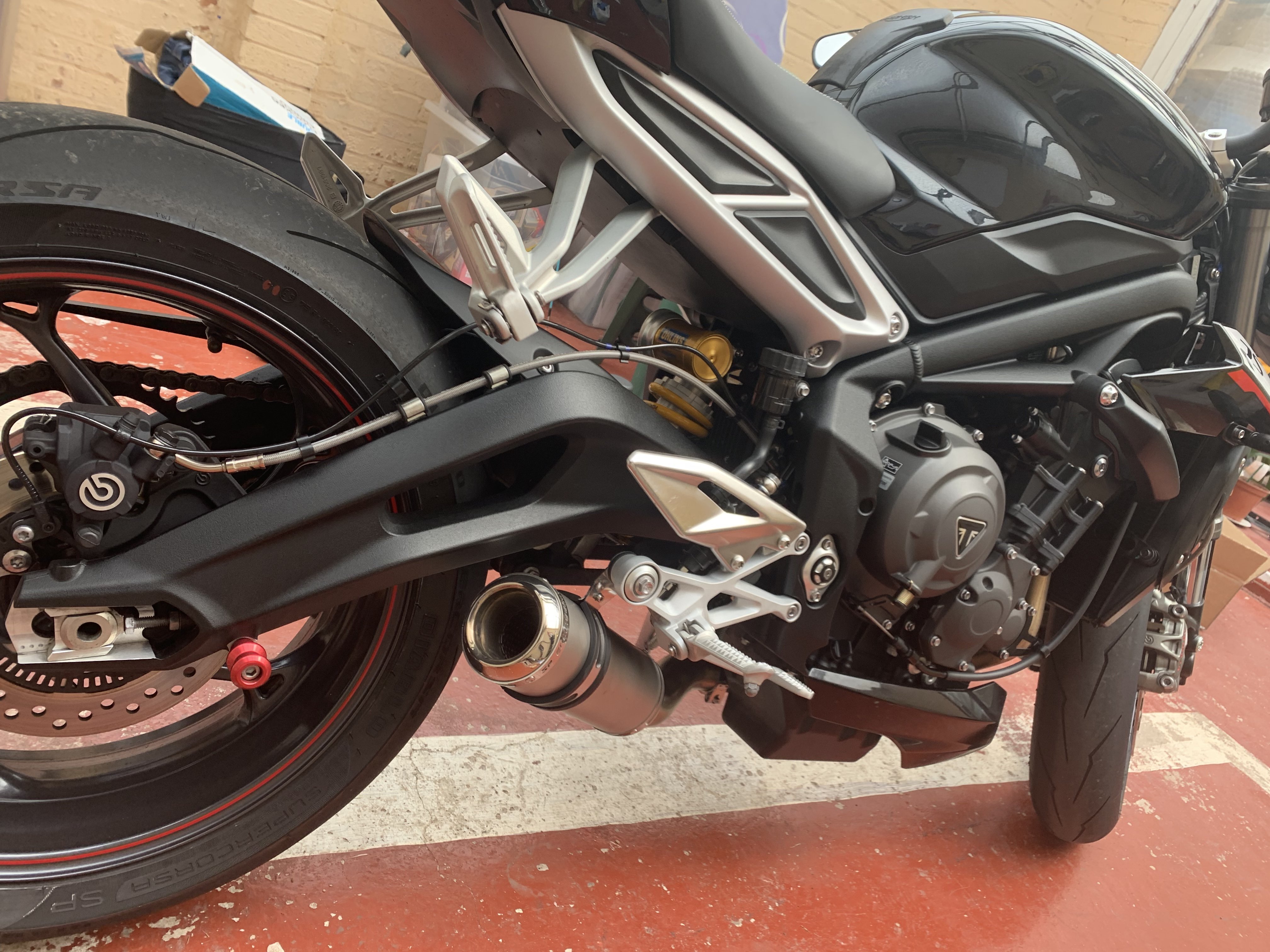

    Well, apart from the heat tape (still waiting for it to arrive) , the finished product!
    Baffle is in and its bloomin' lovely, with lots of pops and bangs when you roll off the throttle. Definitely lost a smidge of grunt though but as i'm not a loon anyway , so the noise outweighs it (IMO)
    Not everyones bag I understand but i love it.
    Just carbon infills to fit and then, that's it until next year (carbon wise)
