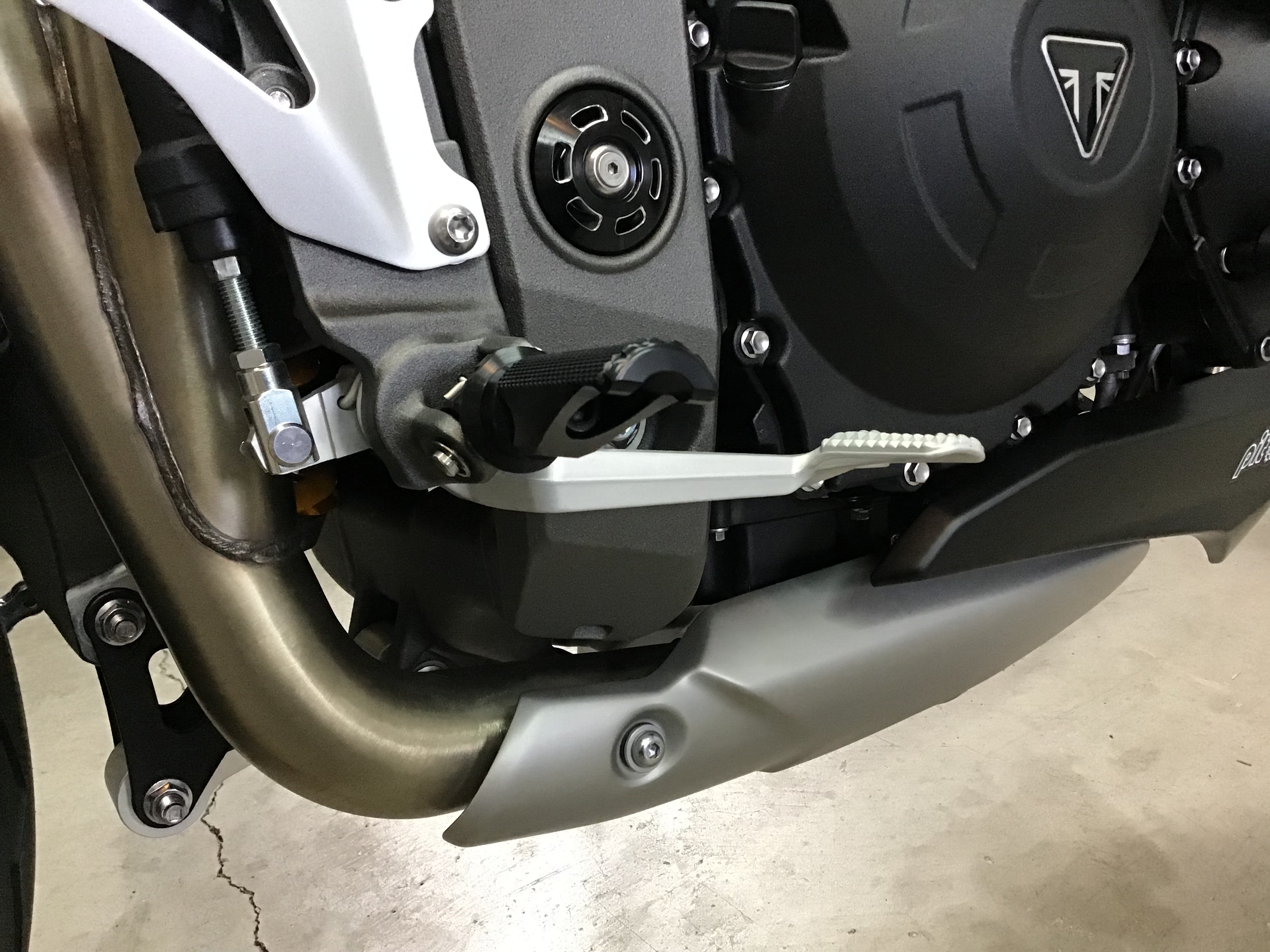

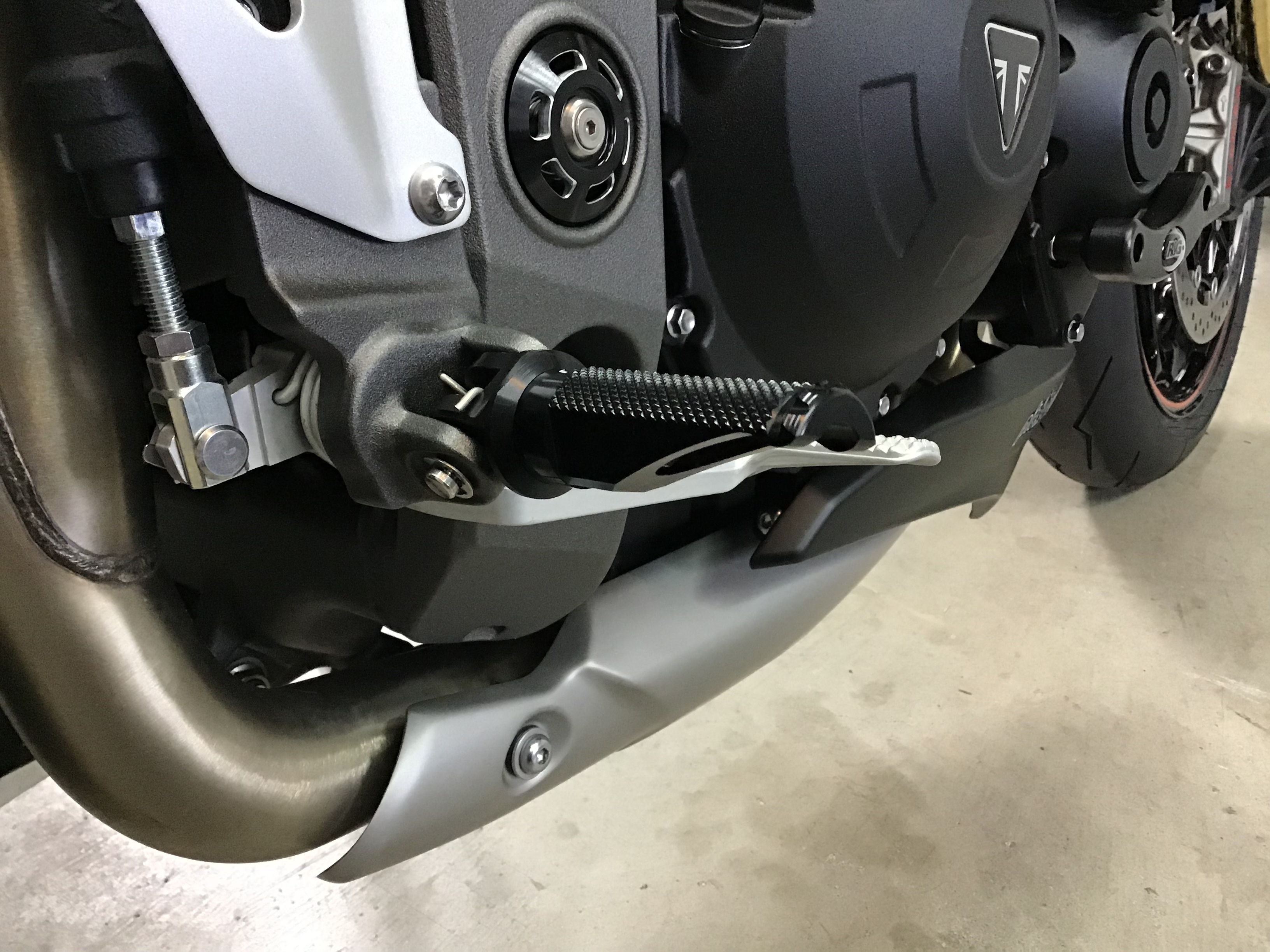

    Just took them off over lunch. 10 minutes. Did not need to remove the exhaust, but you better have a shallow ratchet and socket or you won't clear the exhaust pipe. Damn, looks good without the pegs.

    Not that I'm trying to copy you, but in case we ever ride together, they'll look different LOL

    Nice. Looks freaking awesome now. Love seeing all of the piping, very clean.

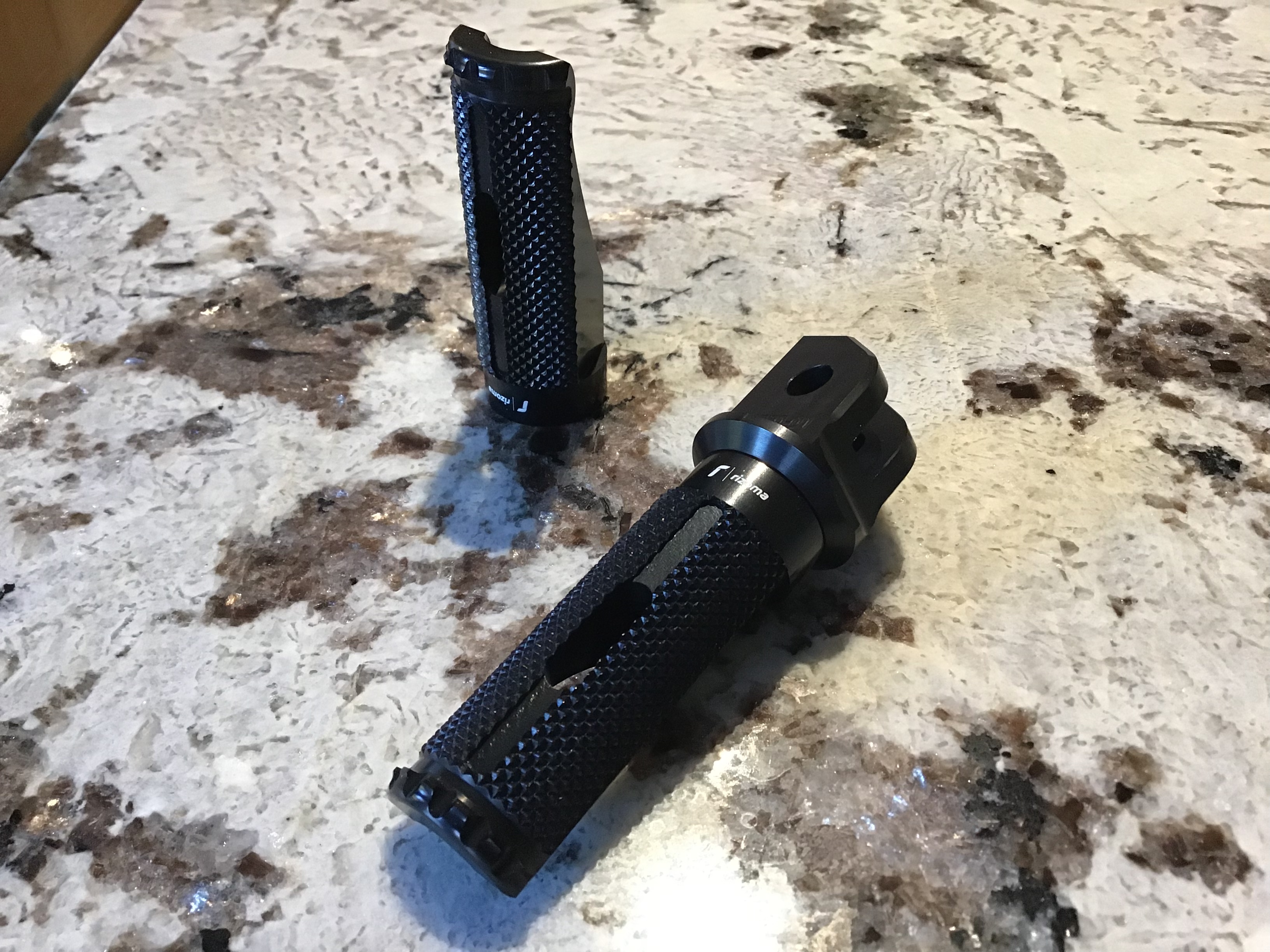

    Nope haven’t even ridden the bike yet :weary_face:. I hade the
    same problem with the pegs on my Street Triple as I couldn’t move my boots around on them. The Speed’s are the same so they had to be replaced. I replaced my Street’s with eBay pegs that are about the same knurling as the Rizoma’s and they worked really well. The Rizoma’s feel about the same with my boots on them, so should be perfect.

    Hahah, no worries. It won’t be long now. They say we are going to see upwards of 18 Celsius next week, so you never know. Yeah, those pegs are very nice indeed, from feel to quality machining, a top notch product.

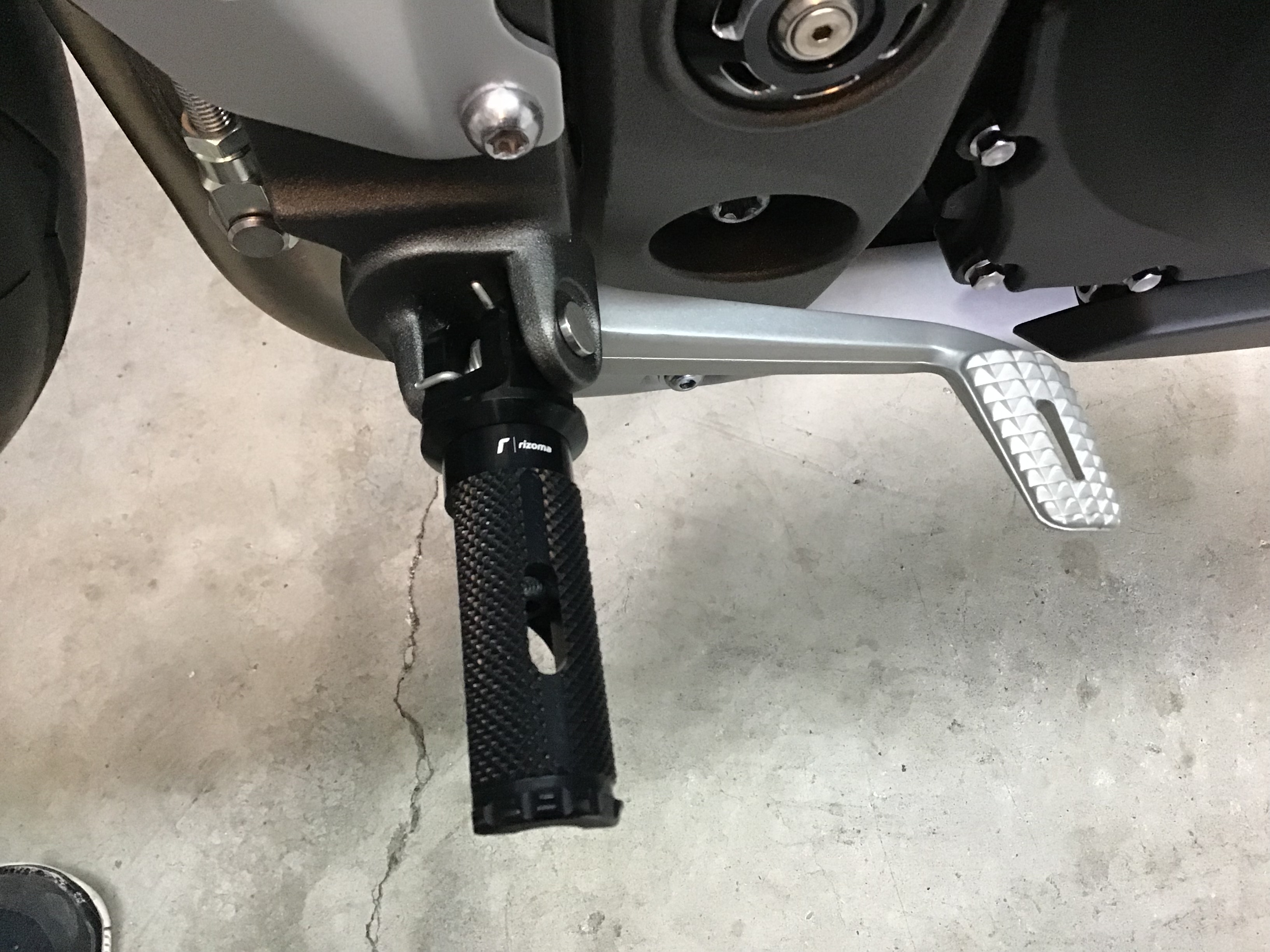

    Yup, one of the easiest mods to install. You’ll just have to decide how far to rotate them forwards. I guess it depends on where you have your shift lever adjusted to. I moved my shifter down from the stock position by one tooth on the splined shaft. So my pegs are rotated forward a few degrees. I’ll include a photo.
