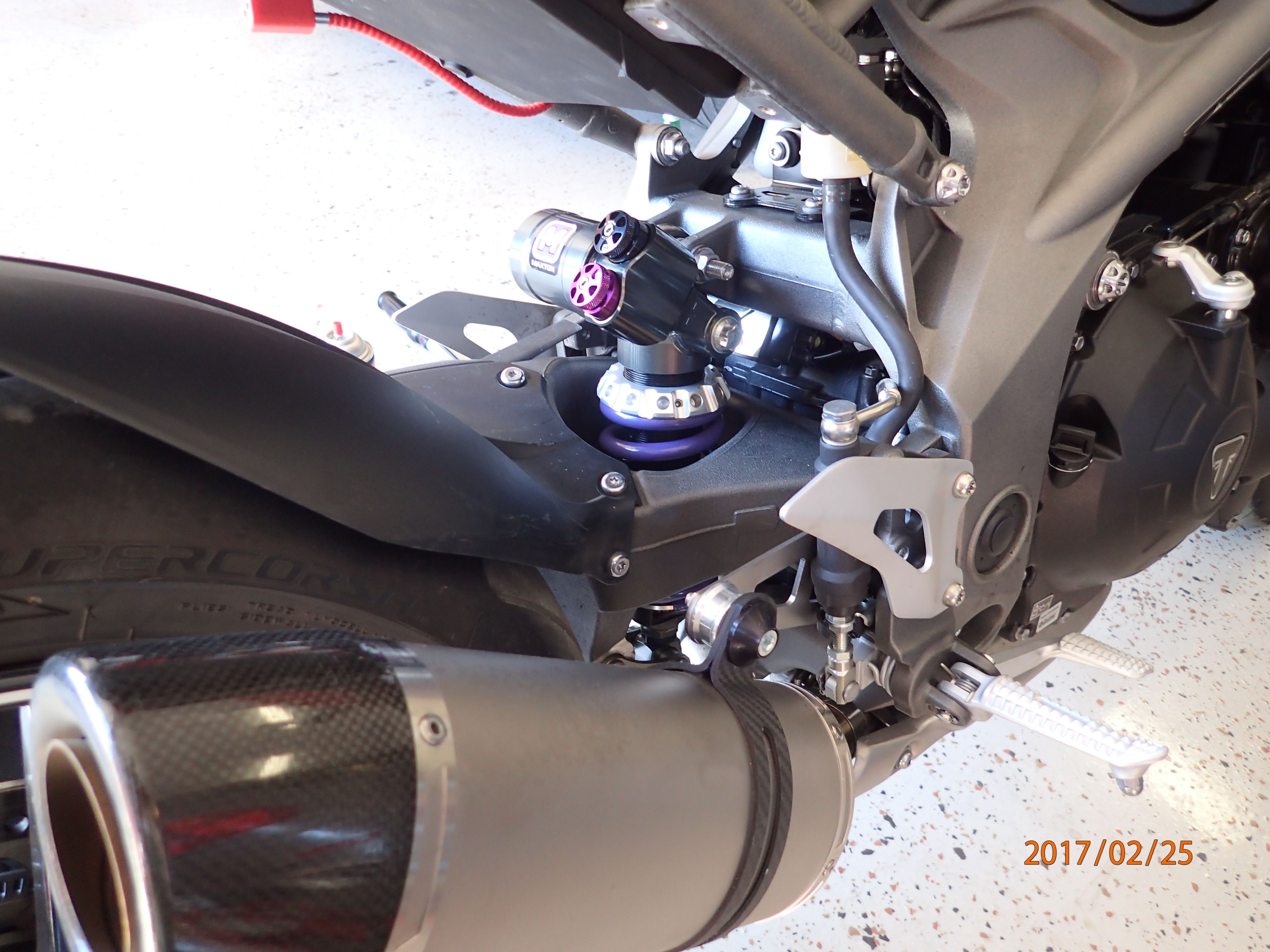

    P2250576.JPG P2250578.JPG P2250579.JPG P2250580.JPG P2250581.JPG P2250582.JPG Here goes, FULL DISCLOSURE - Tools are NOT King Dick, sorry for all you fans :).

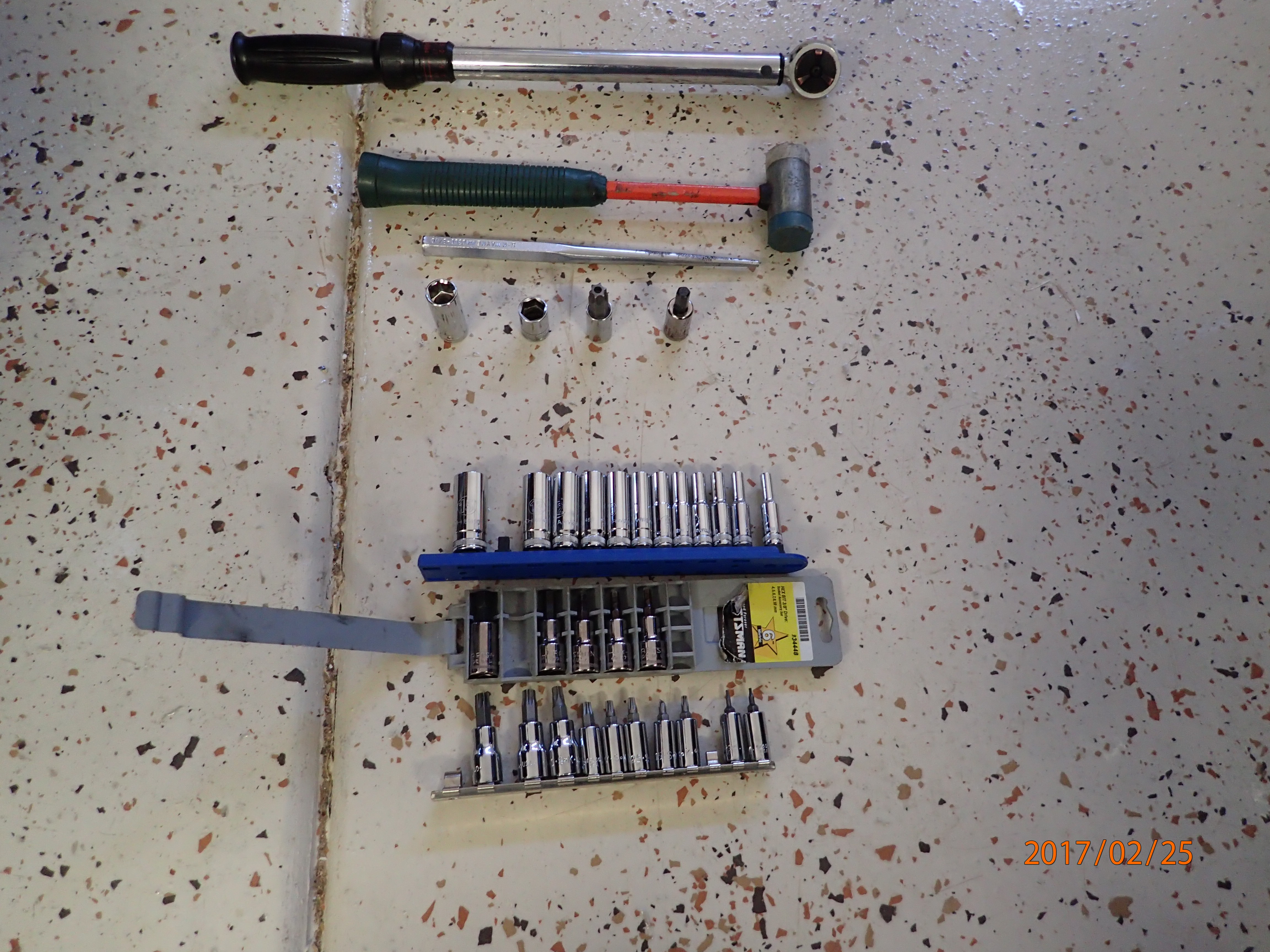

    Required tools are 14 mm spanner, 14 mm sockets (deep and regular), T55 Torque bit socket, 8 mm Allen socket, 3/8 drive ratchet spanner, 3/8 drive Torque wrench, and a punch and hammer to drift out shock bolts. I learned there is no level area to use a jack so needed a helper to steady the bike as it was raised and shock changed out. Used a 2 X 4 piece and a strip of 3/8 plywood to shim the jack to get bike decently level. Top shock bolt was an Allen head and bottom bolt was a Torque head....must be Triumph helping deter Maxton Shock thefts, lol. Why use two different designs?? Torque on nuts is 48 NM.
    The quality of the machine work is fantastic. Truly a functional piece of art! Waiting for it to warm up and road report to follow.

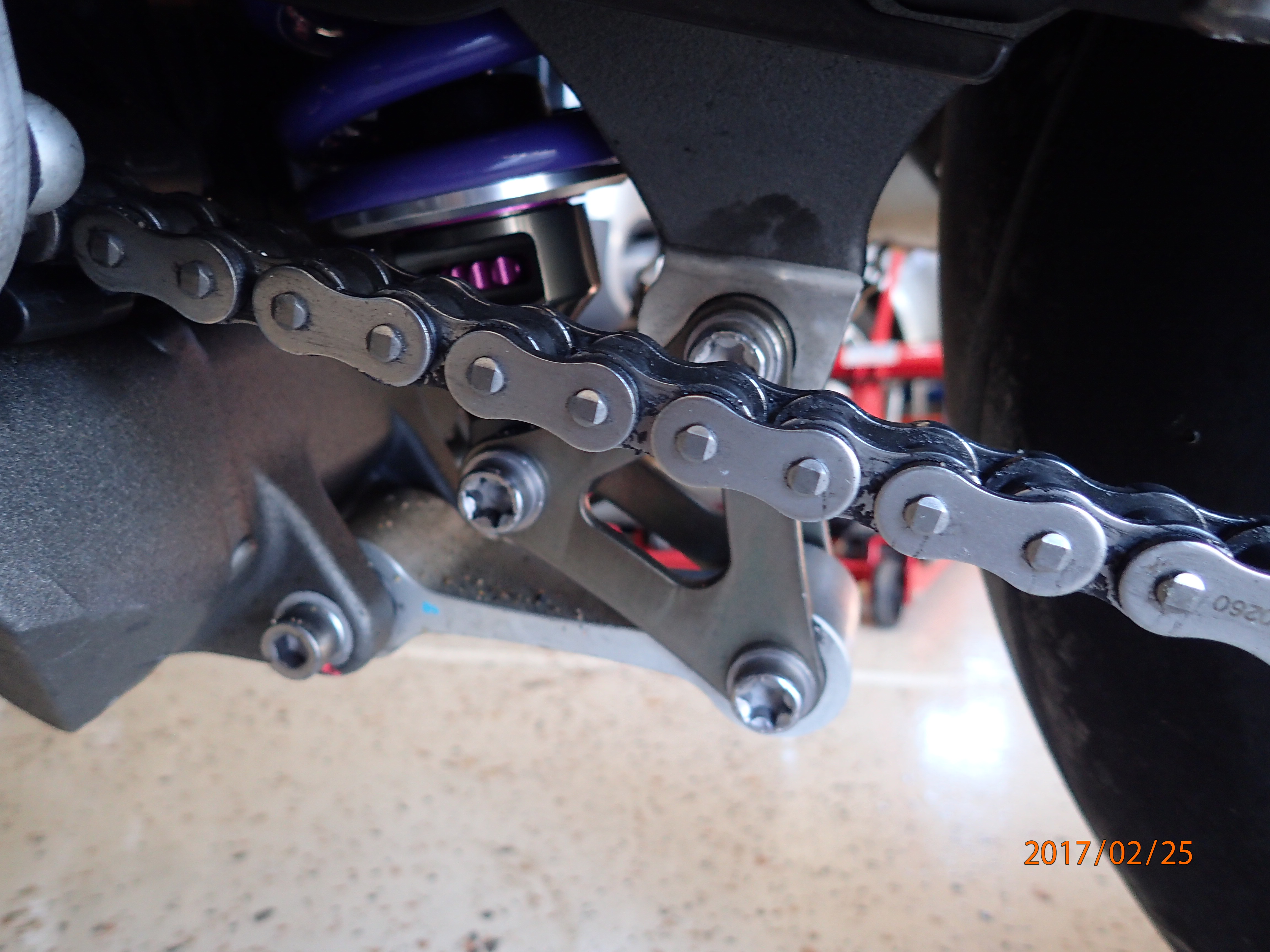

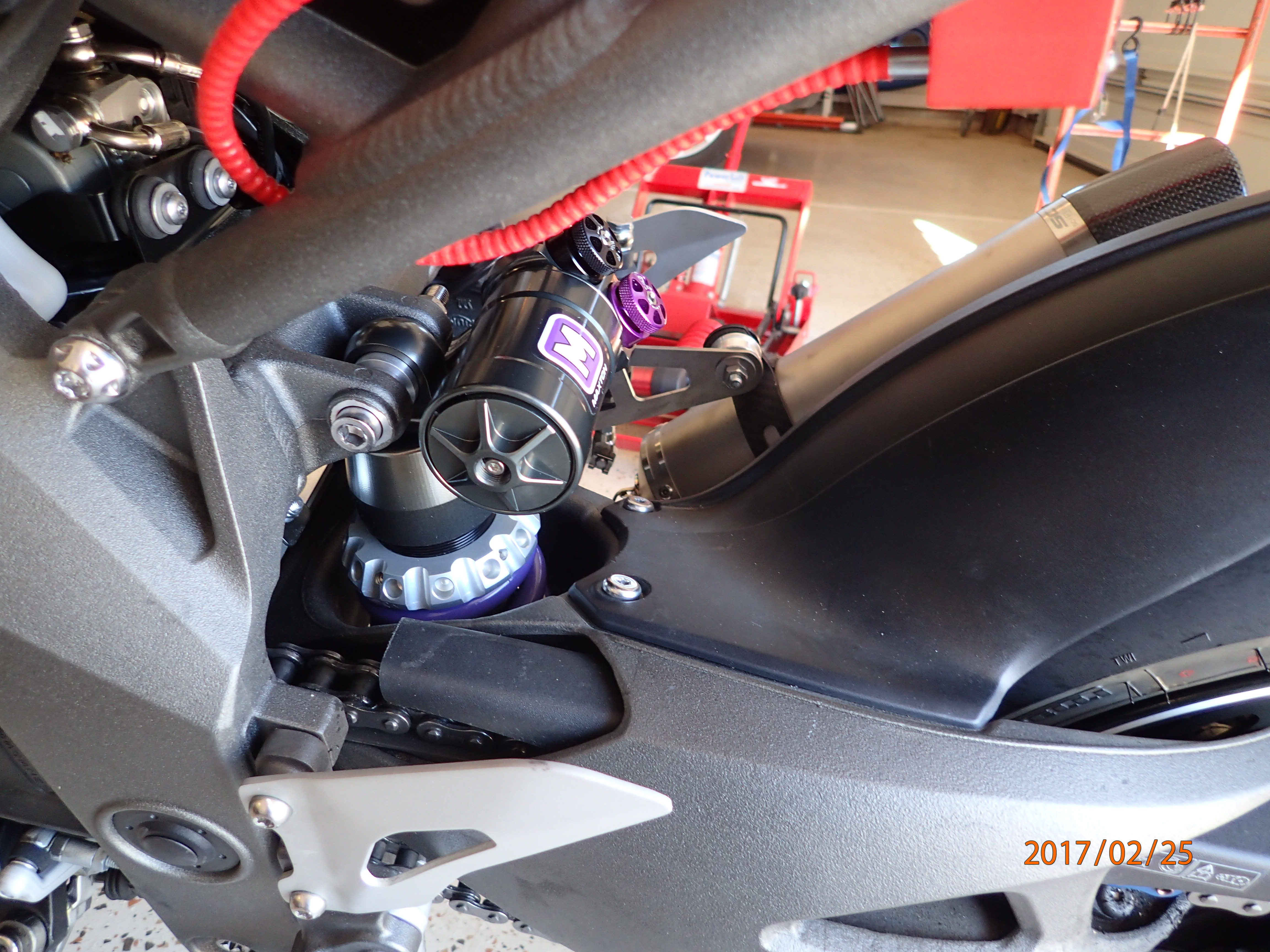

  6. desertspeedy
    desertspeedy Senior Member
    Jul 28, 2016
    437
    N. Phoenix, AZ, USA
    For those with an anal attention to detail - you shall notice a red cable with a red box on it in pictures 2 and 3 above. This is a pistol lock (all new pistols are sold with these generally useless items. I use it to secure my helmet to the bike. That is all :).
