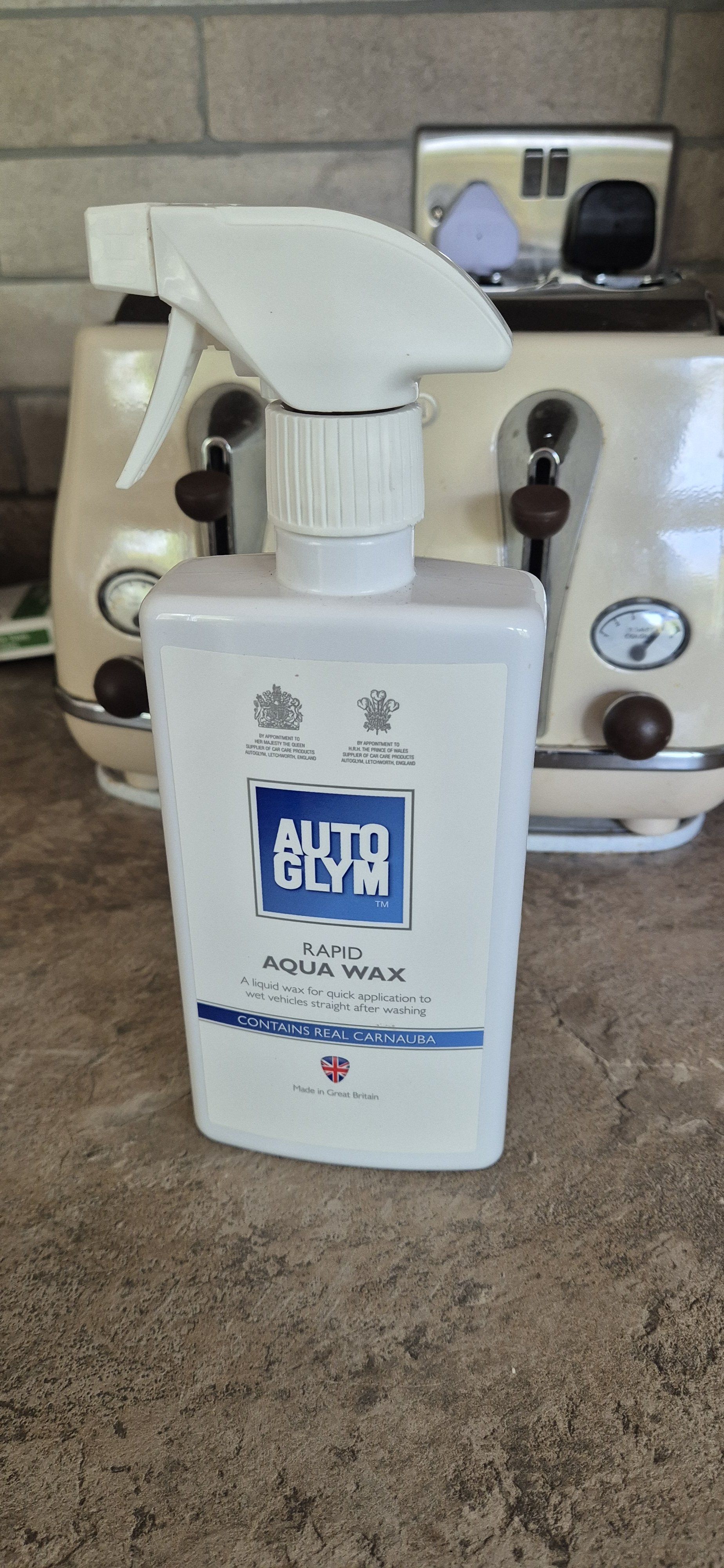

    I had the same marks on my matte gray speed triple, used autoglym rapid wax,always removed the marks and didn't change the paint, no shiny bits.Bike was immaculate when I eventually sold it.

    Interesting, that seems to be a Carnuba based wax that you'd expect to use on a gloss finish.

    Yip that's what I thought but was assured by owners of matte finishes that it wouldn't change the appearance, and thankfully it didn't, spray on and wipe off with a microfiber cloth, perfect result, I will attach pic of the product. 17131859988955315789735288674194.jpg

    Cheers, might give that a go then.
