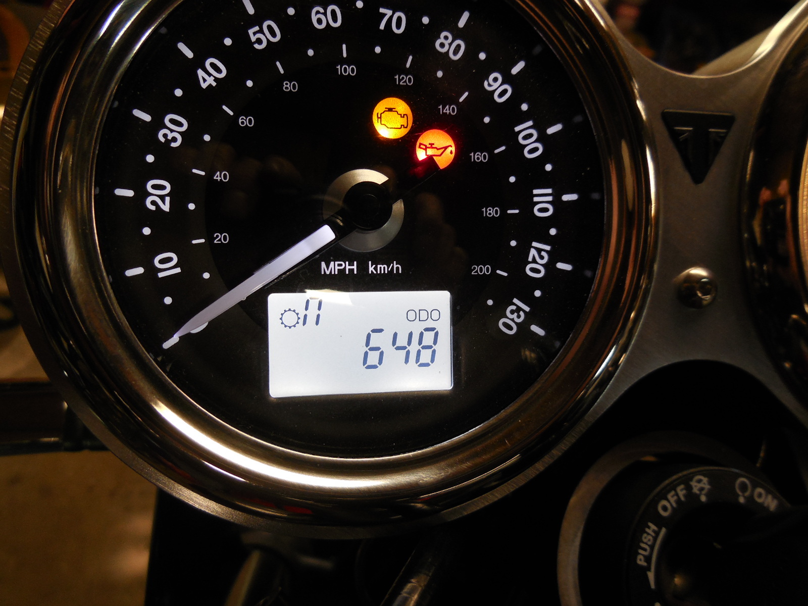

Is there a way to turn off the maintenance indicator without having to go to the dealer? I've gone over 500 miles on the new bike, but Covid-19 has pretty much shutdown all non-essential businesses here in Connecticut. I've done the oil change, adjusted the chain and given the bike ('19 T100) a once-over. Just need to turn off the indicator. Thanks

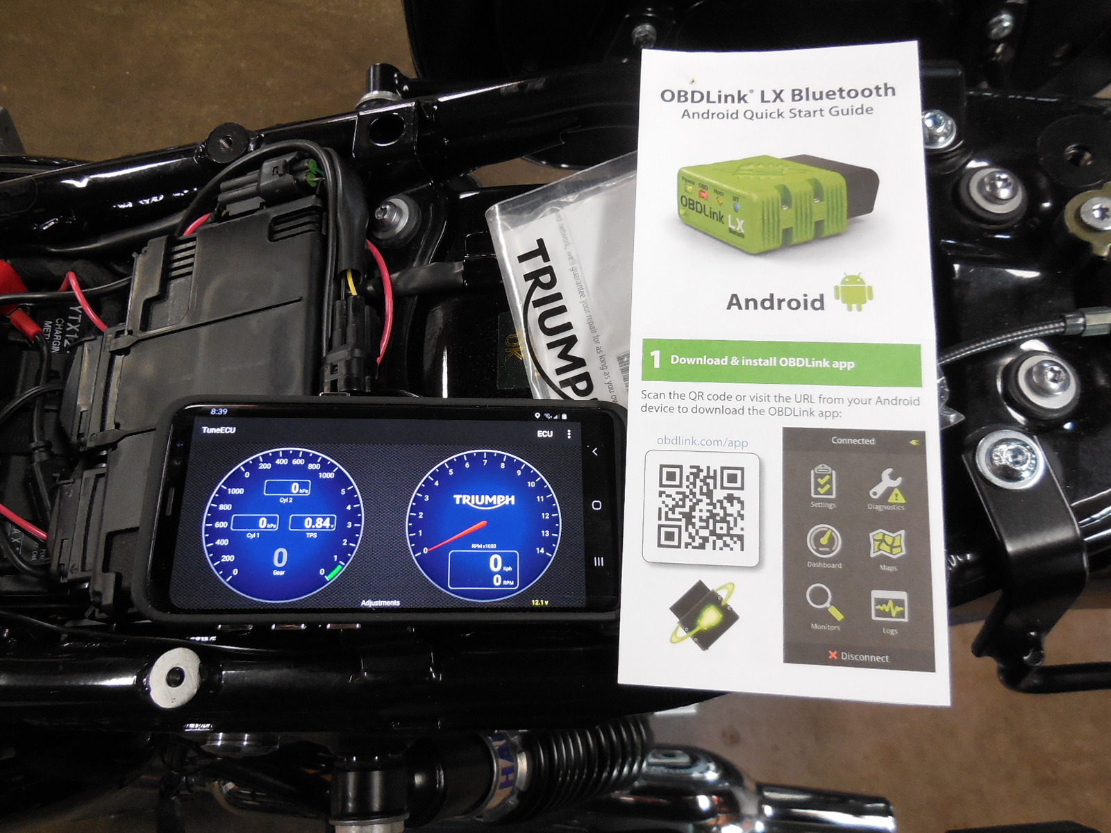

No simple way 3 choices 1. Buy Tune ECU https://play.google.com/store/apps/details?id=com.tuneecu 2. Buy DealerTool http://dealertoolcouk.ipage.com/ 3. Have the dealer reset it The wrench as a reminder of how much I saved doing it myself rather than the dealer doing the service. I will be getting the Tune ECU and the interfaces to reset the wrench

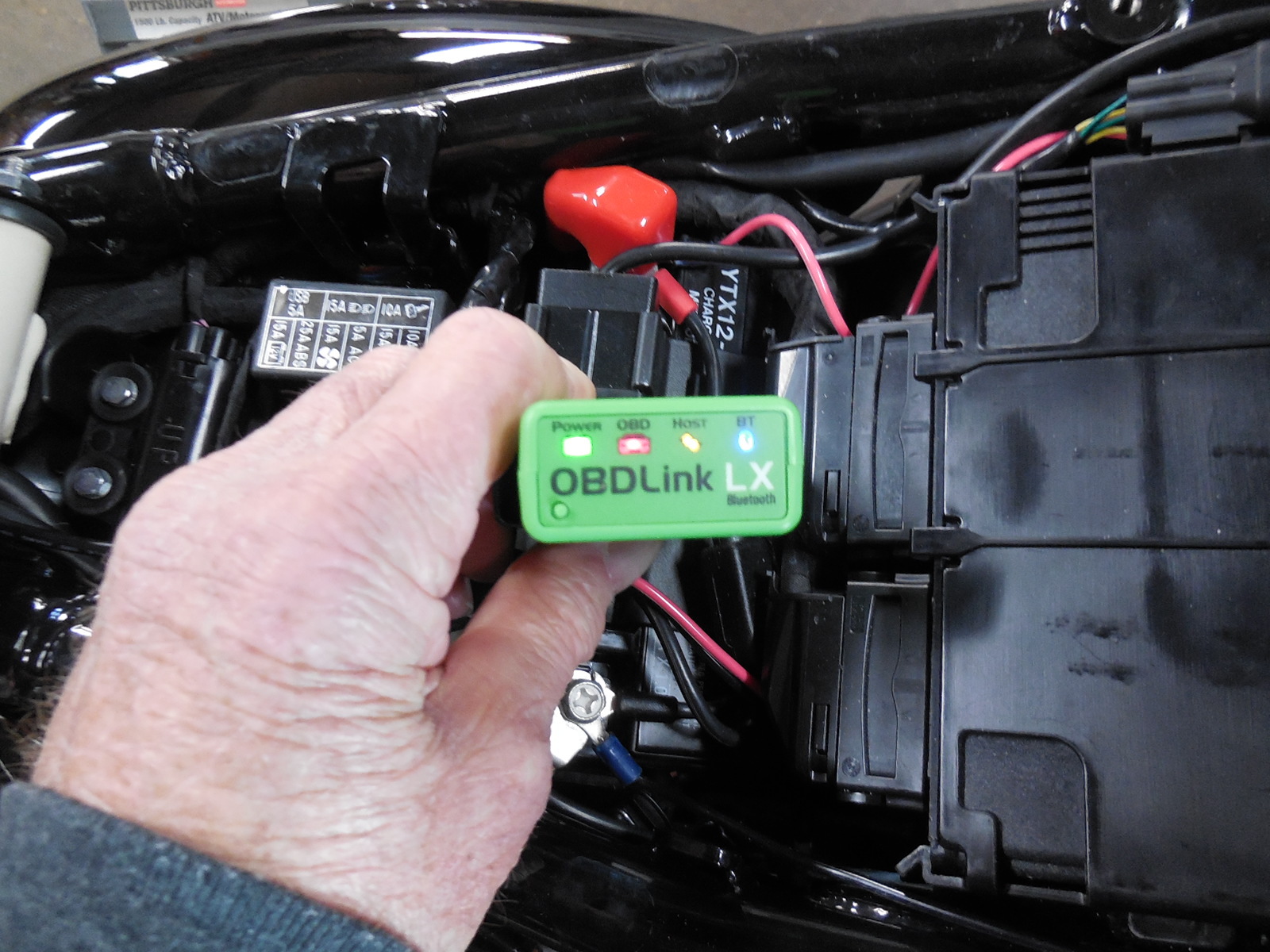

It's done!! Got my OBD adapter. So, went to the garage this morning, plugged it in, paired it with TuneEcu, and TAADAAH, reminder is gone! Many thanks Gents. If this 72 yr. OldPharte can do it, anybody can. My son calls me a caveman when it comes to technology (maybe I really am) but I didn't have to struggle to do this at all
