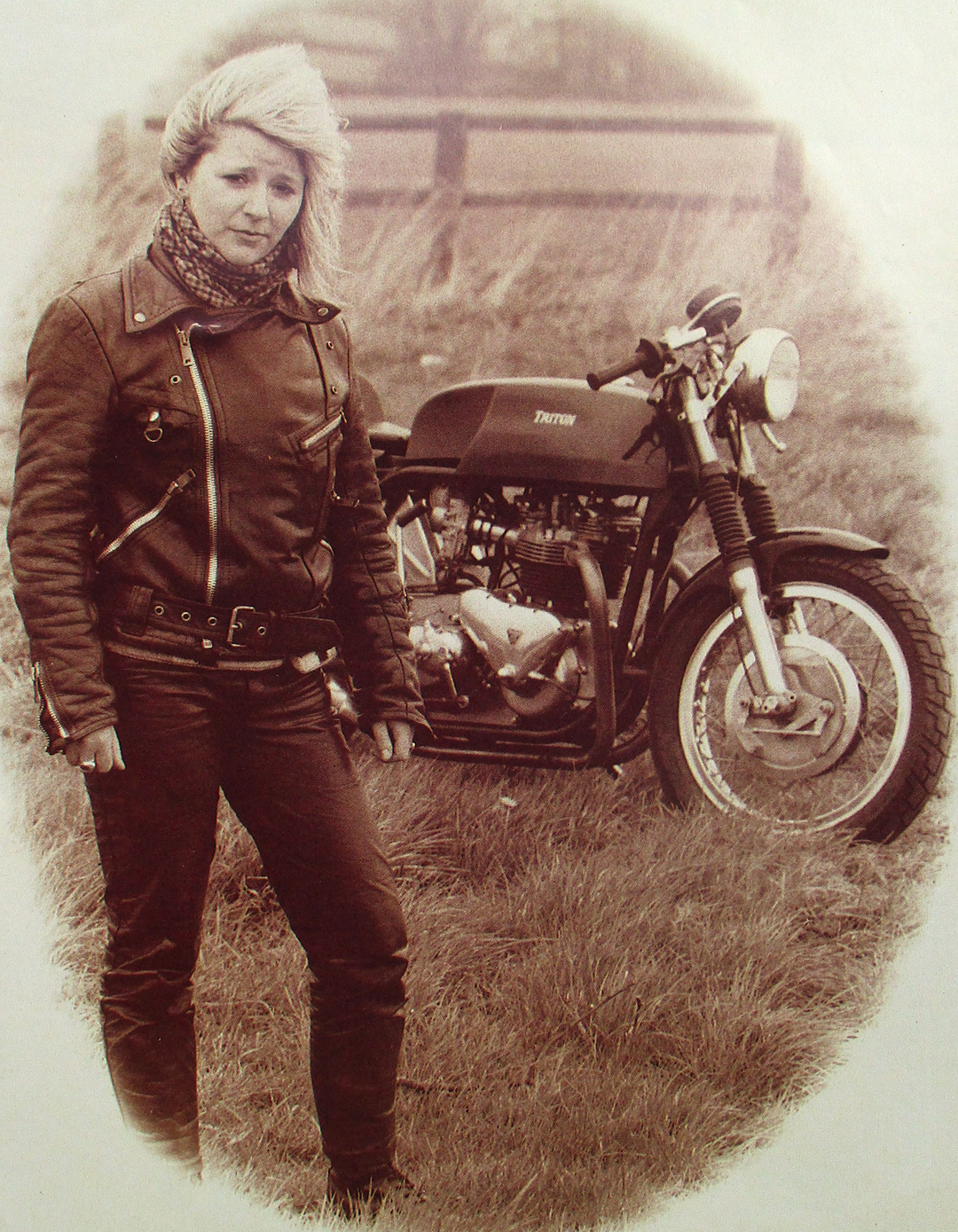

    Here's his wife and her Triton that they built together - note the long carb inlet taper into the head

  6. Sandi T
    24,370
    That's a great photo, @Iron. :)

    yes, it is. a cold windy day for the pretty lady, it appears. ml
