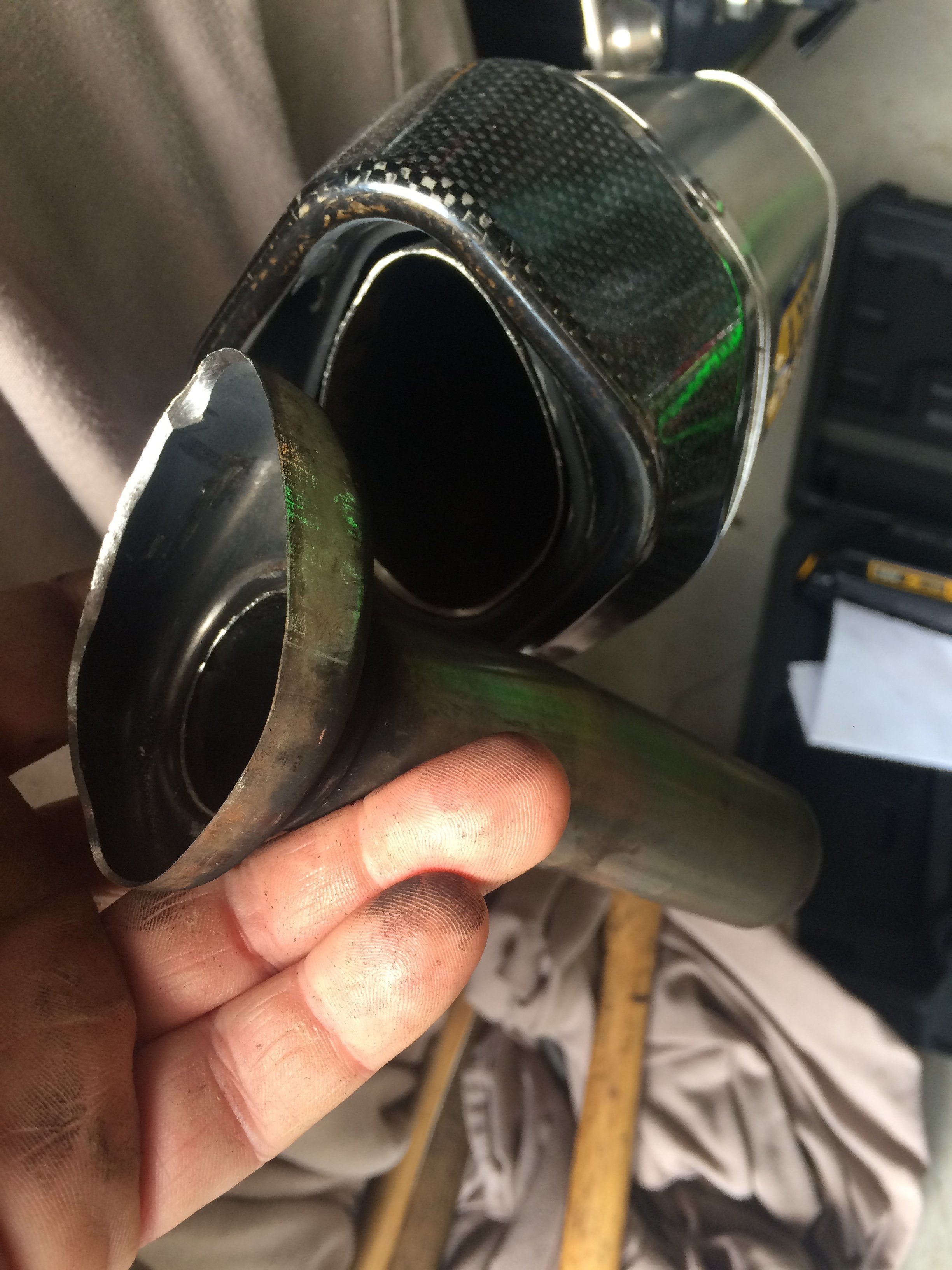

    Yes. I've just done it with my battery drill and angled grinding stone. Now I need to sort something to pull the baffle out with

    Use a hammer handle and move from side to side it should loosen and come out

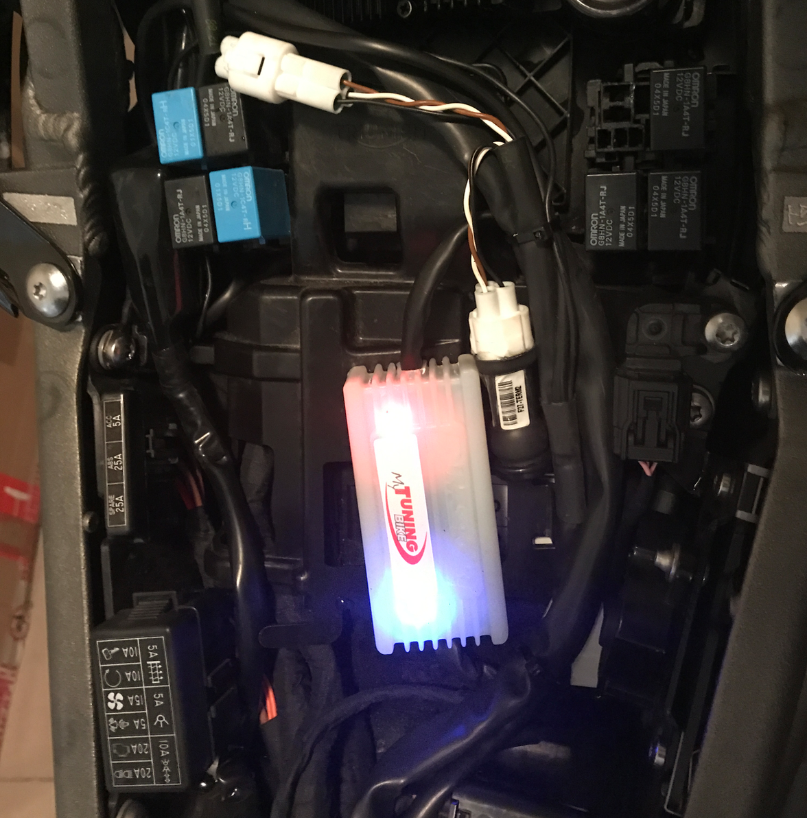

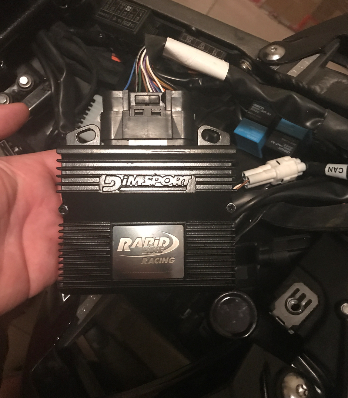

    Ok , I did it !!! I used both methods. First I tried with dremmel but i didn't see the line so I removed end cap and I used heavier tool ;)
    I think than the most important in Rocker description is to use hammer handle and to try often move side to side. It should be written by red bold font ;)
    After all i think that sound without baffle is great !!! I didn't noticed suffering midrange. To check it i gave my bike to local tuner and finally bought rapid bike racing with my tuning bike module :) So now i have BMC Filter, Arrow LowBoy (without baffle), and rapid bike :)

    What does the rapid bike allow you to do?
  8. _Paweł_
    _Paweł_ New Member
    Aug 17, 2017
    4
    Poland
    Hi
    It has planty of features. TOTAL control of air/fueling. For me most important was autoadaptive options but im also happy with for example engine braking setup. Big tool.

    The baffle is welded all away around, but you can’t actually see the weld. The end is double thicknesss, so you can separate the two by using a tapered grinding bit on a drill and carefully remove metal until you see a definite line all around which means the two parts are separated. Then wiggle a hammer shaft in the to loosen it and tease it out. This picture might help...
