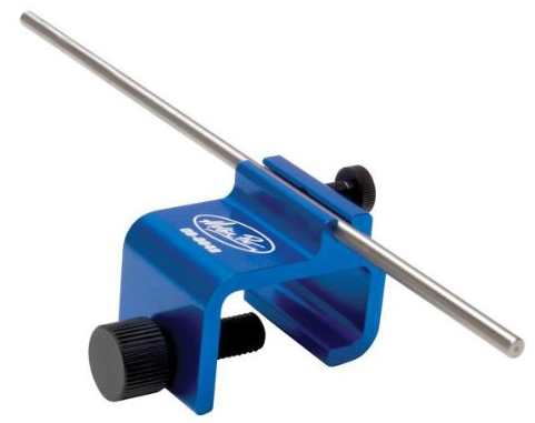

  5. BigCLM
    BigCLM Senior Member
    Nov 30, 2017
    969
    1,018
    San Rafael, CA
    Agree very simple. But one note. I use this tool to ensure the chain is aligned properly. Does not cost very much. I used the swing arm marks on my street twin to align, then checked w/ tool. It was not perfectly straight using swing arm marks alone. The tool is recommended for perfect chain alignment which will help get the most out of your chain.

  6. Aidan
    Aidan Well-Known Member
    Dec 31, 2018
    228
    185
    Good bit of kit. Where did you get it from, and what's it called?

    Until you get one, after adjustment stick the bike on a stand and get someone else to spin the wheel.
    You should be able to see if it’s a long way off
    #7

    mpllineman First Class Member
    Feb 12, 2018
    1,566
    826
    Pearl,Ms.
    I like these and use one myself!
