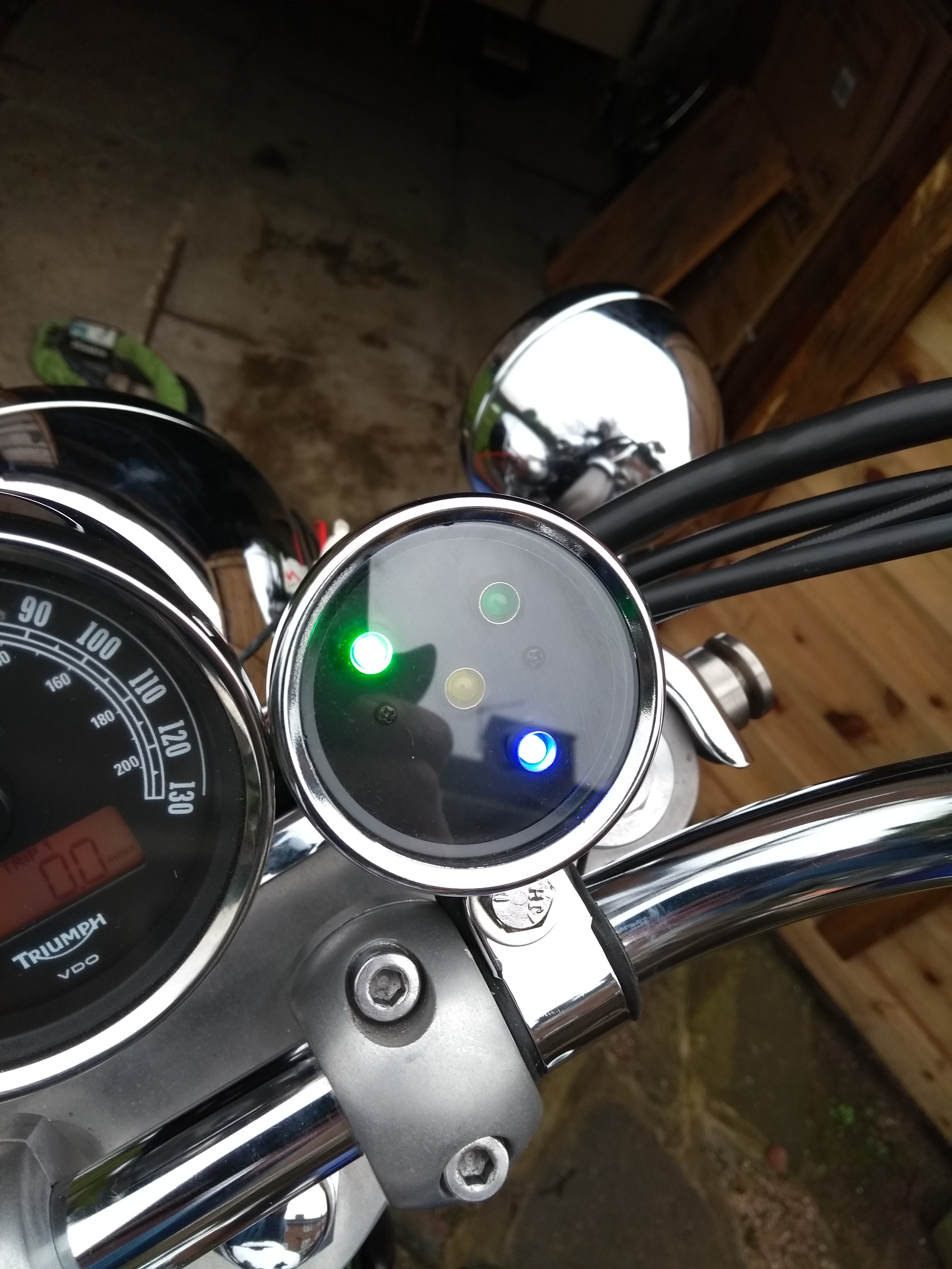

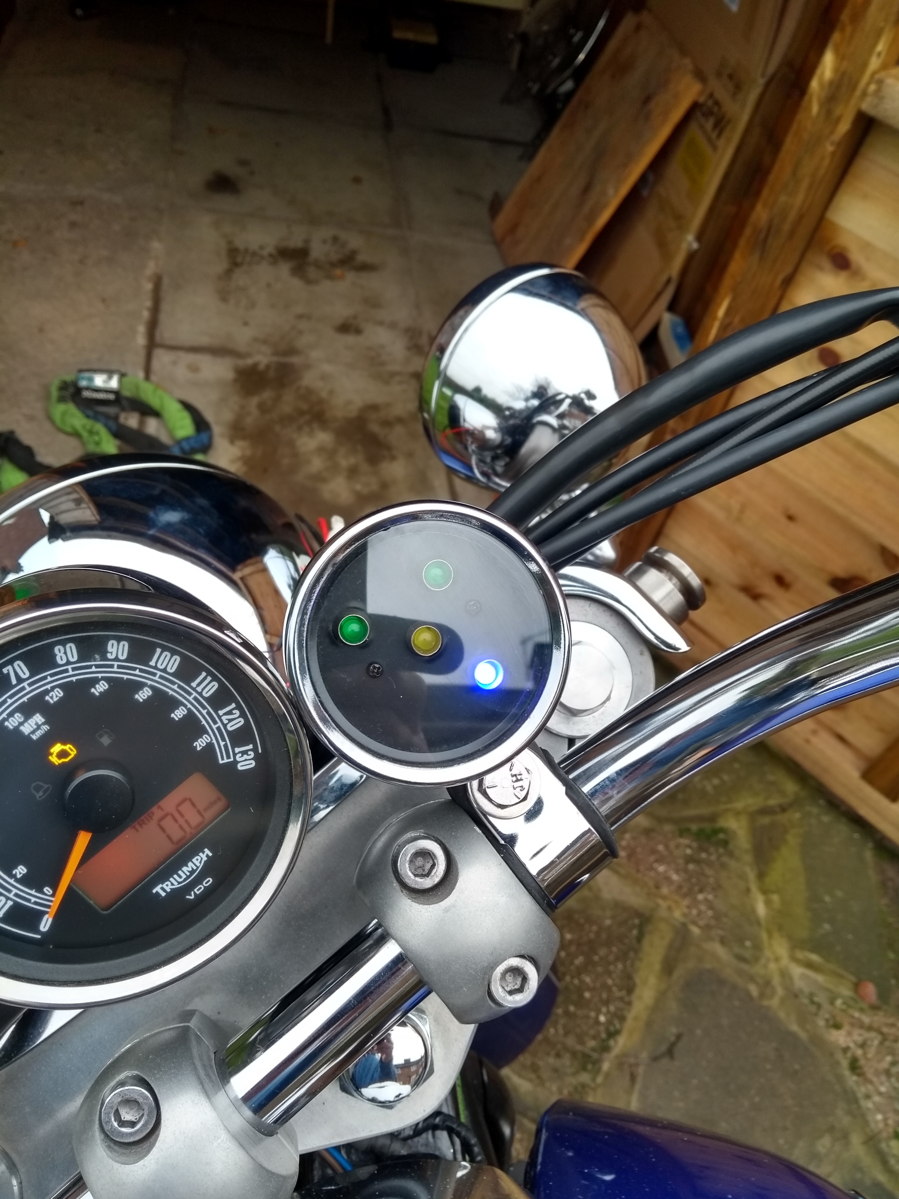

    thought i would share a little project i have been working on.not happy with the position of the idiot lights on the triumph america lt,i saw a thread on here where someone had made a bracket and put his indicator warning lamp on it,so that gave me an idea.i brought a cheap tacho on ebay,some small led lights.i removed the bezel from the tacho removed the tacho needle then the insides.drilled the tacho gauge face where i wanted to install my led lights.covered the gauge with some spare black vynyl wrap then installed my lights.carefully reasembled everything back together.removed the headlight lense then found where indicator and main beam wiring was.joined everything up except nuetral light that has still to be done and this is what i have now

    That looks tidy.....

    Nice.
