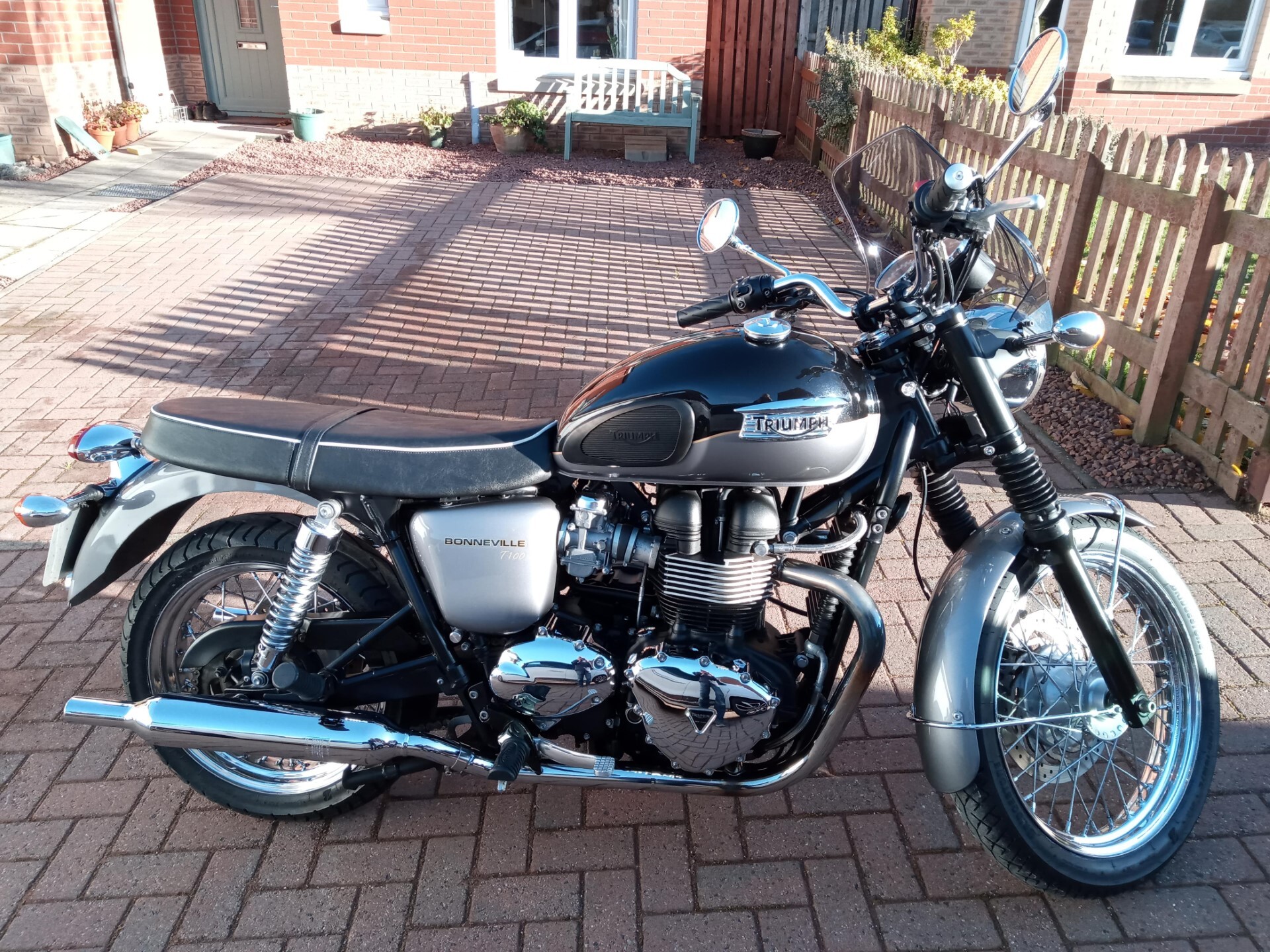

    Thanks to all who have given me feedback on this issue. I've not gone ahead with upgrading the lights as unfortunately I'm going to have to sell the Sprint, I've been finding the riding position exacerbates an existing back problem I've had for years. I consulted a physiotherapist to see if they could sort out my back, but it seems old age and general wear and tear have finally caught up with me and my days of riding in anything other than a "sit up and beg" position are over. I did put the Sprint up for sale a few weeks ago but had no positive responses, so now it's tucked up in my garage for the winter and will be going up for sale in Spring next year. But as one door closes, another one opens - I've just bought a rather nice 2011 T100, definitely a "sit up and beg" riding position which even my physio would approve of!

  20. Jimbo1950
    Jimbo1950 Well-Known Member
    Oct 6, 2022
    96
    78
    Scotland
    Hi Rob, the T100 is supposedly the spiritual descendant of the original Bonnie T100 of the 1950's / 60's. The model was introduced in I think 2001 with a 790cc carb-fed engine, then switched to an 865cc lump with fuel injection in 2009. Mine has the later engine which pumps out about 67bhp and 51 ft-lb of torque. It's no sports bike but cruises happily at 80 mph on motorways, and is surprisingly agile and lively on the twisties. I bought mine because I've started to get into the older Hinckley Triumphs, having had several of their newer models. I still have two comparatively modern triumphs, a 2019 Speed Twin 1200 (a real torque meister!) and a 2016 Street Triple 675 (my "naughty days" ride) which share garage space with my 2000 Legend TT and now my T100. And for the time being the Sprint until I can find a buyer for it. I've attached a couple of photos of the T100, taken today in lovely sunshine in the Scottish Borders. Sunny but cold, down to about 0C overnight and still only in single figures. Are you from Scotland originally or do you have Scottish ancestry? I'm only guessing because of your moniker "Rob The Scott". T100#1.jpg T100#2.jpg
