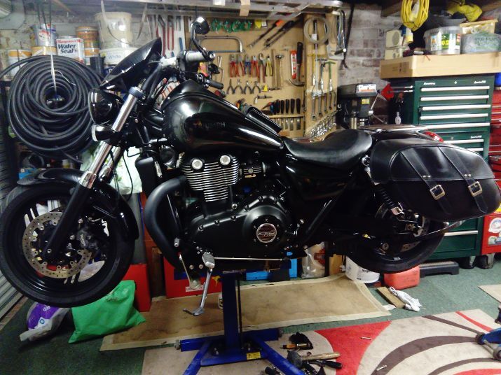

I have the big blue lift and it works well both wheels accessible to work on, different forms of lifting gear for each bike, so easy to keep the lift and just change lifting gear required. I would recommend
Got a Skylift and love it, had a bench lift before but it took up a lot of space that was needed. Once I'd given up racing, where I was working on the bike most weekends and the bench was more useful for what I was doing, I sold it and got the skylift which is ideal for what I want now. It's also handy that you can wheel it around the garage with the bike on it, if you want to squeeze another bike in etc.
