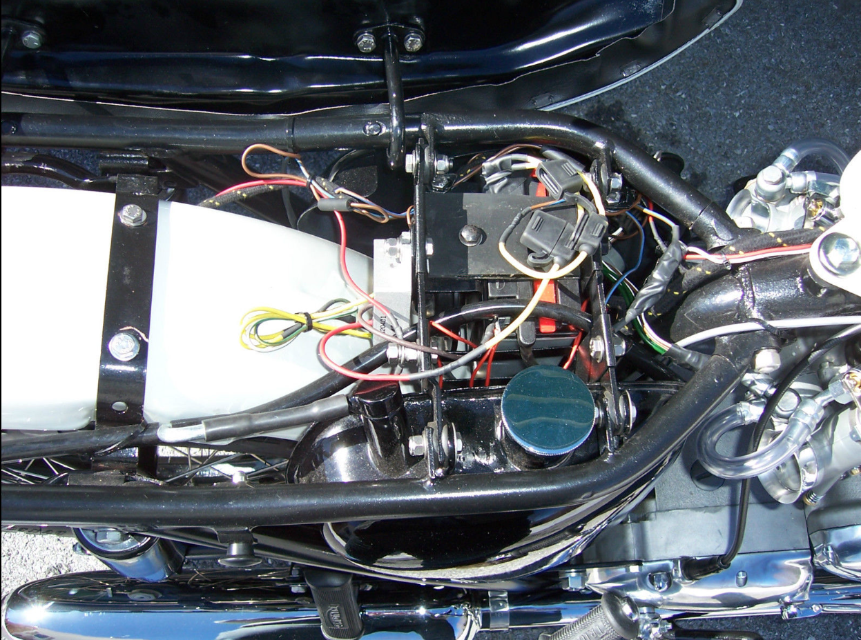

    thats the rotor for the ignition. looks like the flat bottom of a soup can with 180 degrees of side left standing up 10mm. the coils are in parallel, not series, so each is 12volts not 6 and there is no waste spark.
    the leading and trailing edges of the shutter are 180 degrees apart, not like its shown in this picture for a n offset crank. so one coil is fired at one end of the shutter, and the other is fired at the other.
    the guy that makes the ignition just does the transistor box and sends you these drawings for the rotor. i spoke to one of my machinists yesterday and got contact infor for his artist-machinist to do this rotor.
    that guy has a CNC shop, and is the one with the rotary table who cut the adjuster slots in my ARD magneto to allow me to knock the FM mag unit back and forth about 10 degrees so i could adjust it with a timing light while the mmotor was running.

    rotors!
    i have four machinists for this motorcycle.
    one does the cylinder heads
    o e does my pistons
    another built and repairs the crankshaft
    and this guy is the artist, who makes intricate weird stuff, like these ignition rotors:
    hes very very good
    and very very eccentric
    but now i have three to test. he was unsure about the taper, because it didnt calculate out the way it should have. but the rotors fit into an old 72 exhaust cam i brought him, so tomorrow ill see whether i can mount the coils and the transistor box and maybe test em out
