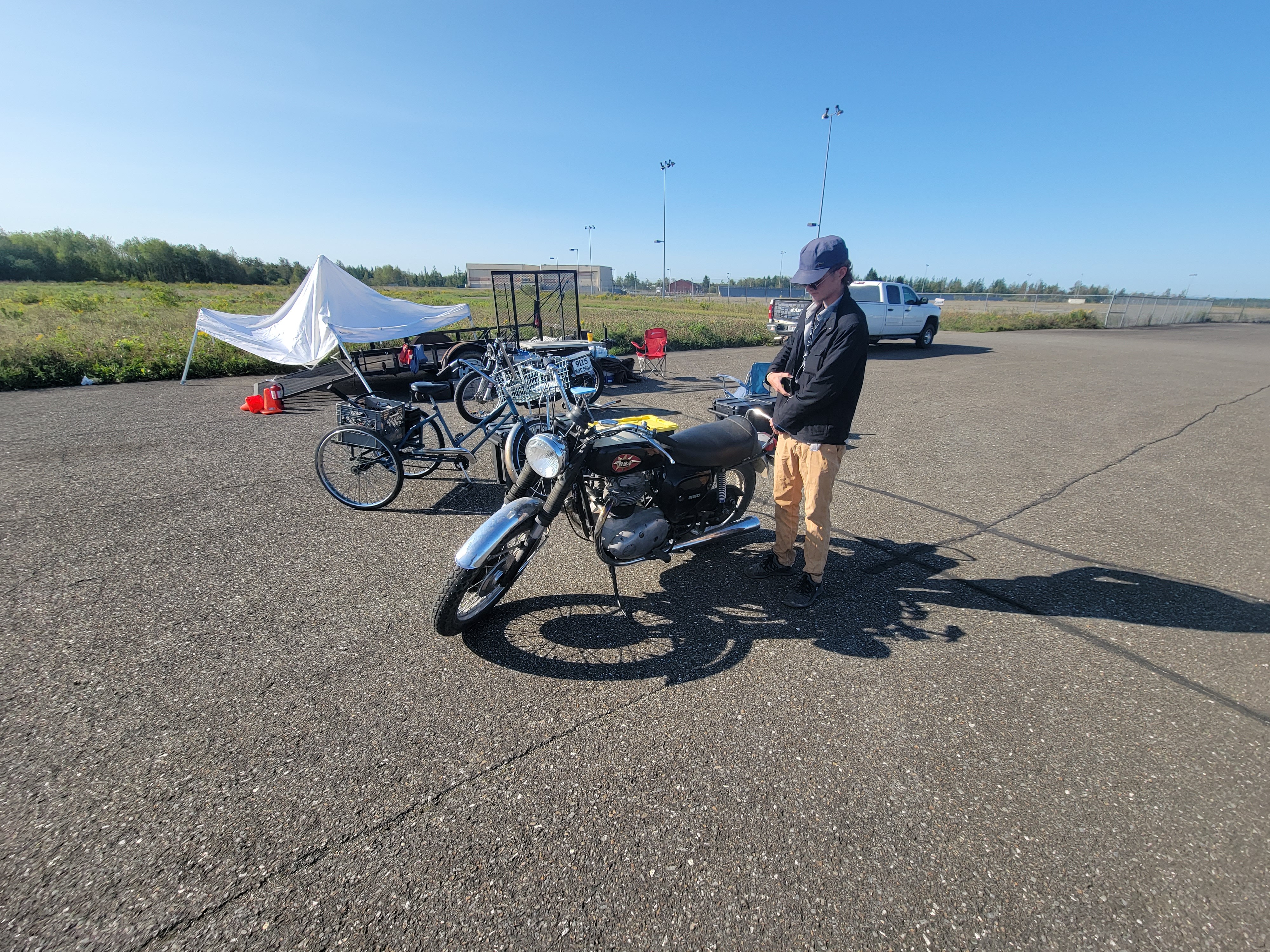

    got to the race course

    anyway, the triumph wopuld not pull over 6000 rpm in fourth gear, which was about 105 mph. nothing i could do changed that. changed jets. no. changed fuel from Q16 to c12. no. tried different plug gaps. no.
    th ebike would rev freely to about 5500, then begin to break up. if i held it open i could 6000, a ragged top end. sometimes it would slow to 3500, as if there was a fuel flow problem.
    but i popped of the carb drains and opened the petcocks. the fuel poured out of the 3/8-inch taps, so no problem there.
    i suspect either the pazon transistor box is bad, or one or both of the coils. i dont know how to tell whether a coil is bad, if it works sometimes and not others.
    but a friend of mine from oz is sending me an ignition he makes. hes an old engineer, and all i have to do is get a machinist to make me a rotor. no waste spark, so it fires two sides separately, has an adjustable rev limiter and adjustable spark curve (by him). working on that now.
    but in spoite of the headwind, the bike would still do the ton, so i said to the boy
    want to ride it?
    and he did. slow. 78 mph.
    i said, this isnt the 250 ninja. open the throttle in first for five seconds. there will be reversion at 3100, and the bike will burble and misfire. hold it wide open and at 4100 it will clear. shift into second at 6000, then hold it open until it wont go any faster to shift into third.
    he tried again, but didnt believe me. slow again.
    then on th ethird run, he held it open through the reversion, and i could hear the motor catch. a good run. 100 mph.
    he came back and said
    when it gets through that it really acclerates. it almost threw me off.
    yes, i said.
    thats how it works. if youre not hanging on when the motor clears the pipes, you can be in trouble.
    so we're back again, and im contemplating other changes besides the ignoition.
    but thats it for racing for 10 more months. just wrench work until then.

    Your pitstop tent is a bit shit :p

    we came back in the morning and the wind had destroyed it.
    if you tie it down the wind pulls it apart.
    if you dont it isnt there when you look next.
    but a new tent every three years isnt bad. if i had a closed trailer we d just use thst
