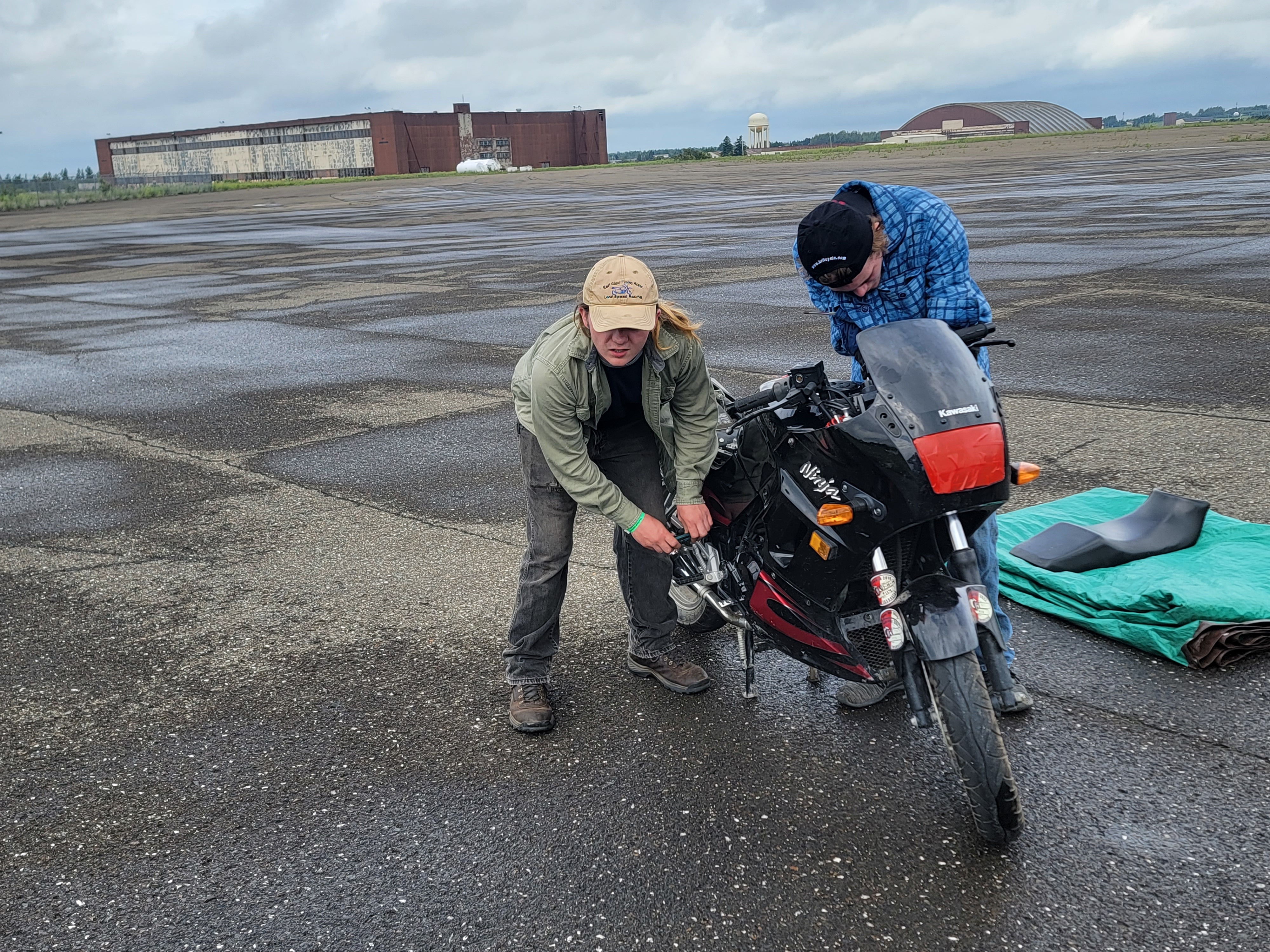

    last day of racing was cancelled. rained out, really.
    we got there late and missed the riders meeting. i retorqued the head and taught my number two son how to adjust the valves using the 26 tpi threads as a measurer. then i looked up and the cones were gone from the hotbox and people were leaving.
    and it was wet.
    so i went and chatted with the crew. we were talking about the 250 getting close to plateau at 108, and one of the organizers said,
    you know; nobody's ever run nitrous on a 250 here . . .
    i said, what class change? and he replied, easy, just change from gasoline to fuel. you could take the fuel record now if you'd just change classes, youre already faster than they are.
    (gasoline can run in the "fuel" class even without actually running modified gasoline)
    and 250 ninjas can run 122 with nitrous.
    so now im thinking.
    the problem with the ninjas is that while they can run 122, thats the limit of the motor. you blow the clutch first, and then if you fix it, you blow the gearbox.

    that building way back there in the back is actually a long way off. it looks like a normal aeroplane hanger, but it holds two--two-- B52 stratofortress bombers with the door closed.
    that is impressive shit.
    ive been up to it when i have time and its is immense.
    the runway at this place is 12,800 feet-- the longest airstrip available for racing in the world. you can find longer, but you cant race there (edwards air force base) or it takes lots of money to do it (bonneville and colombia).
    this place is available to anybody who is willing to fork over the dough for the petrol to get there. we drive two days and pay the dues.
    its a priceless gift.
