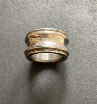

    Failed wheel bearing inner ball race removed from a 2015 Royal Enfield after 2,600 miles caused by an incorrect spacer length.
    I superglued a thin washer onto the end of the spacer tube as a temporary solution - it was still stuck in place and working fine over 20,000 miles later!

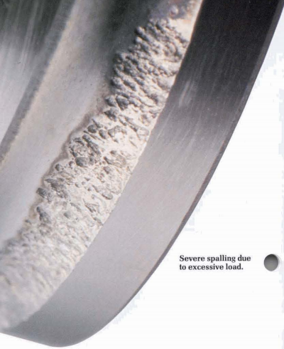

    File photo from BARDEN PRECISION BEARINGS showing clearer view of similar damage
