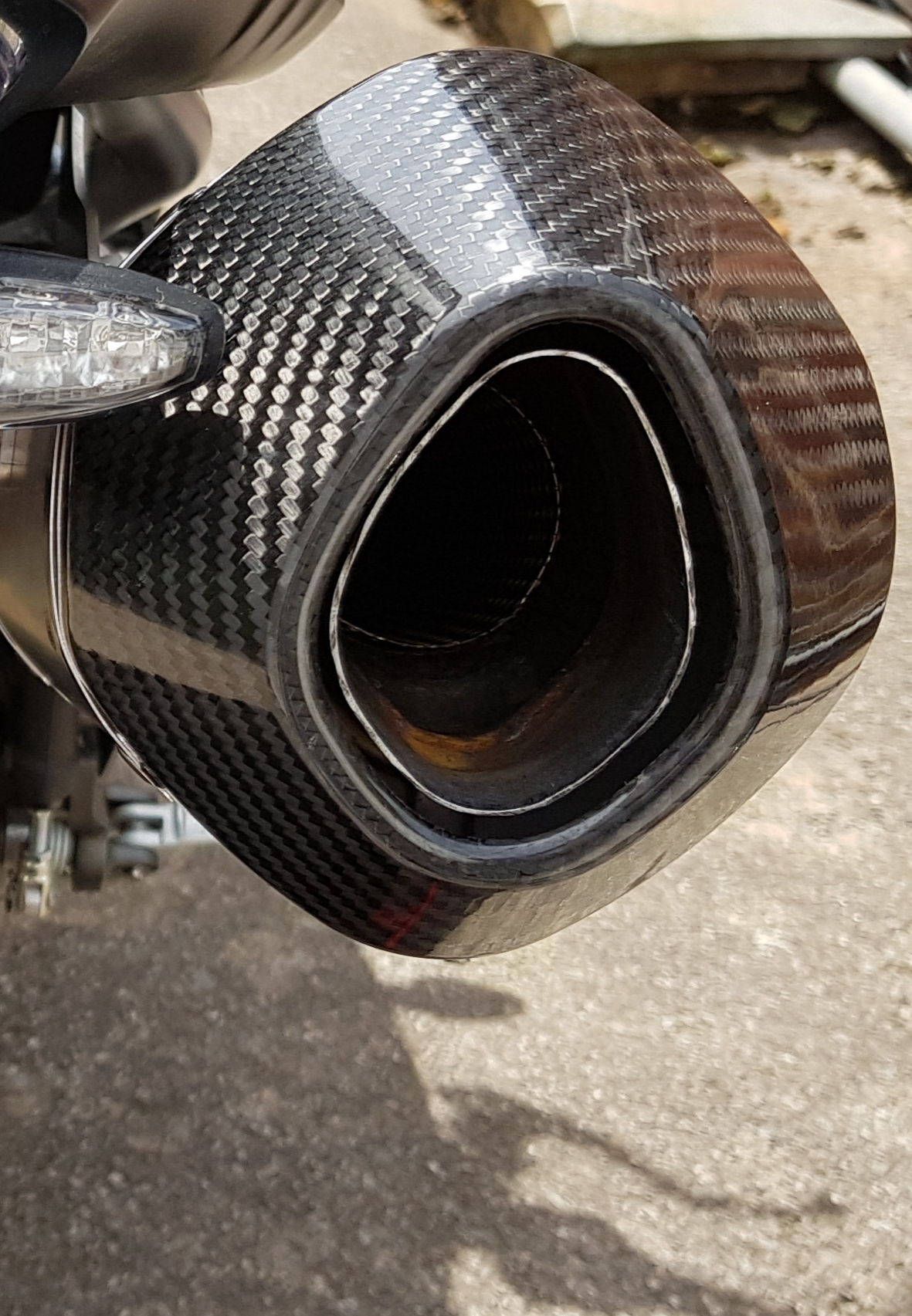

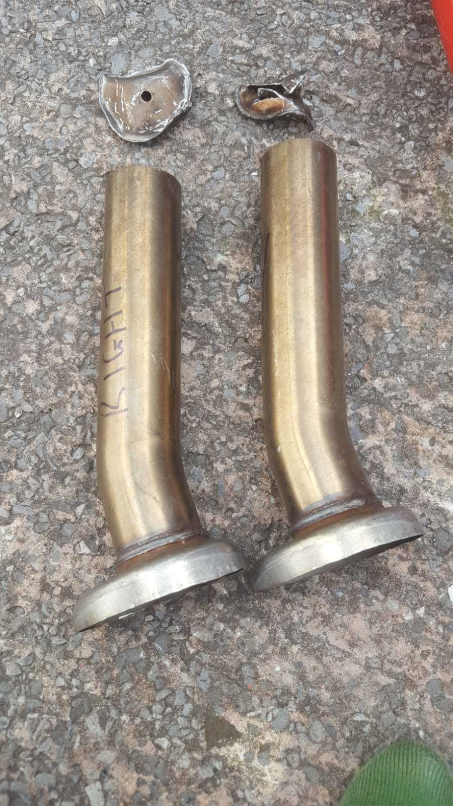

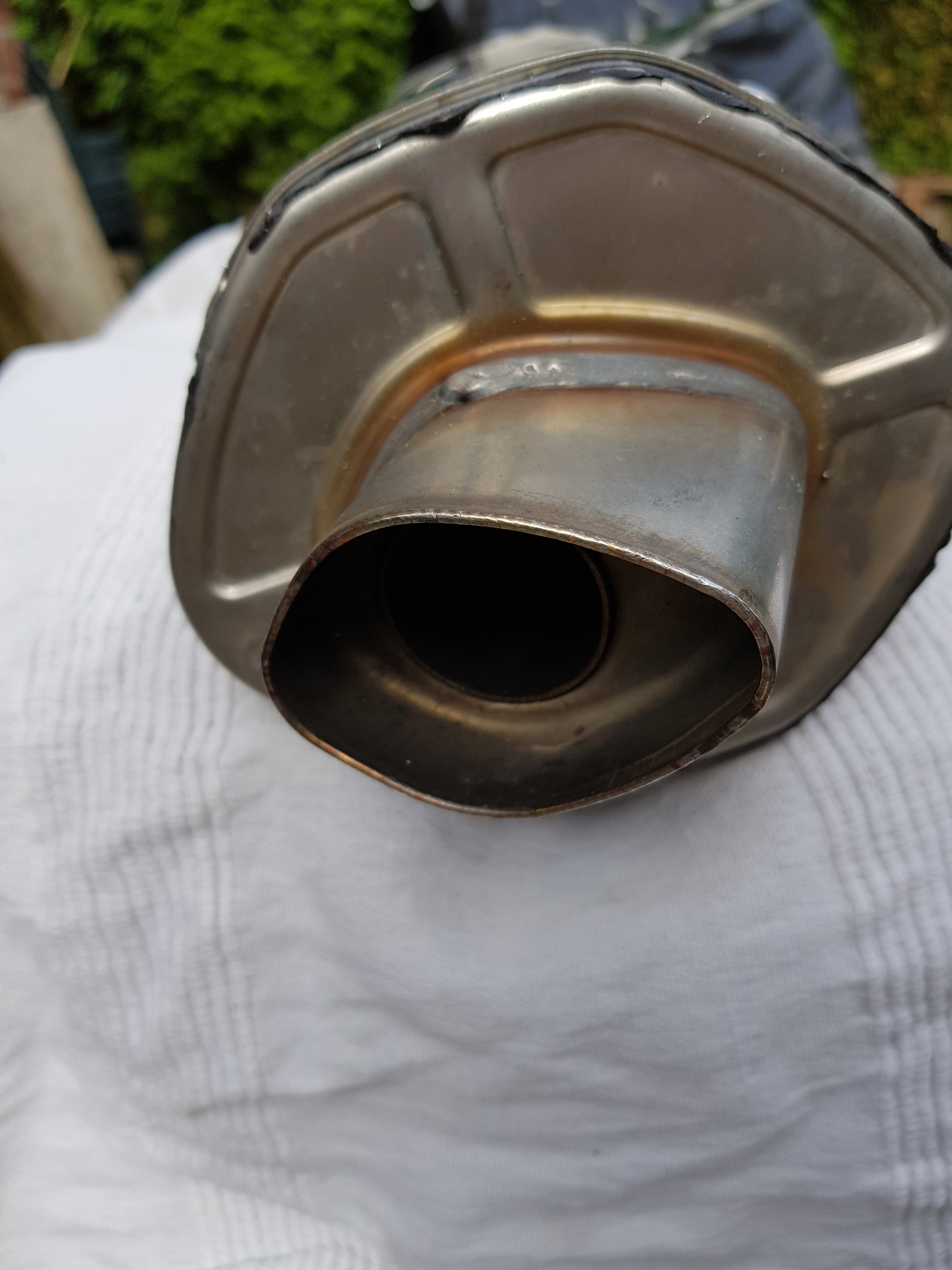

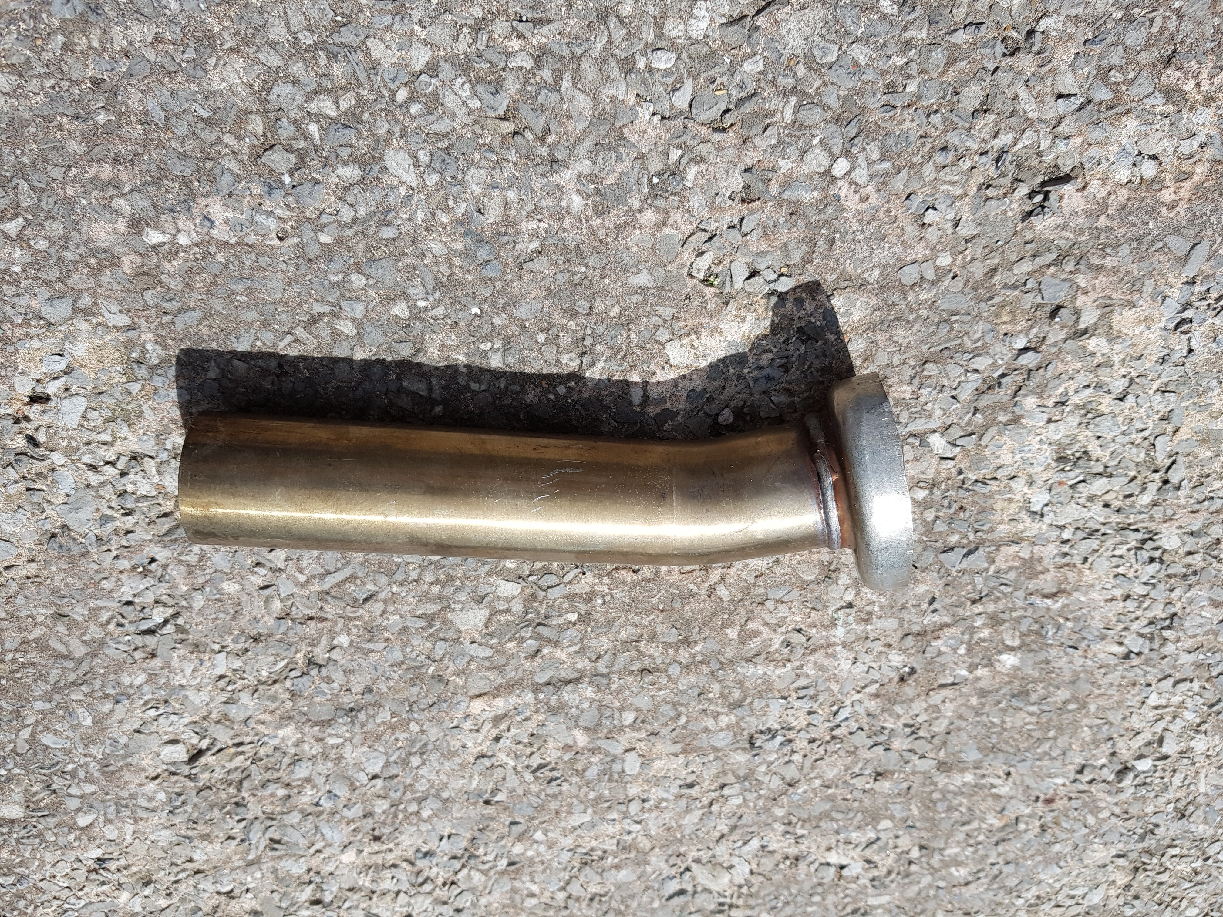

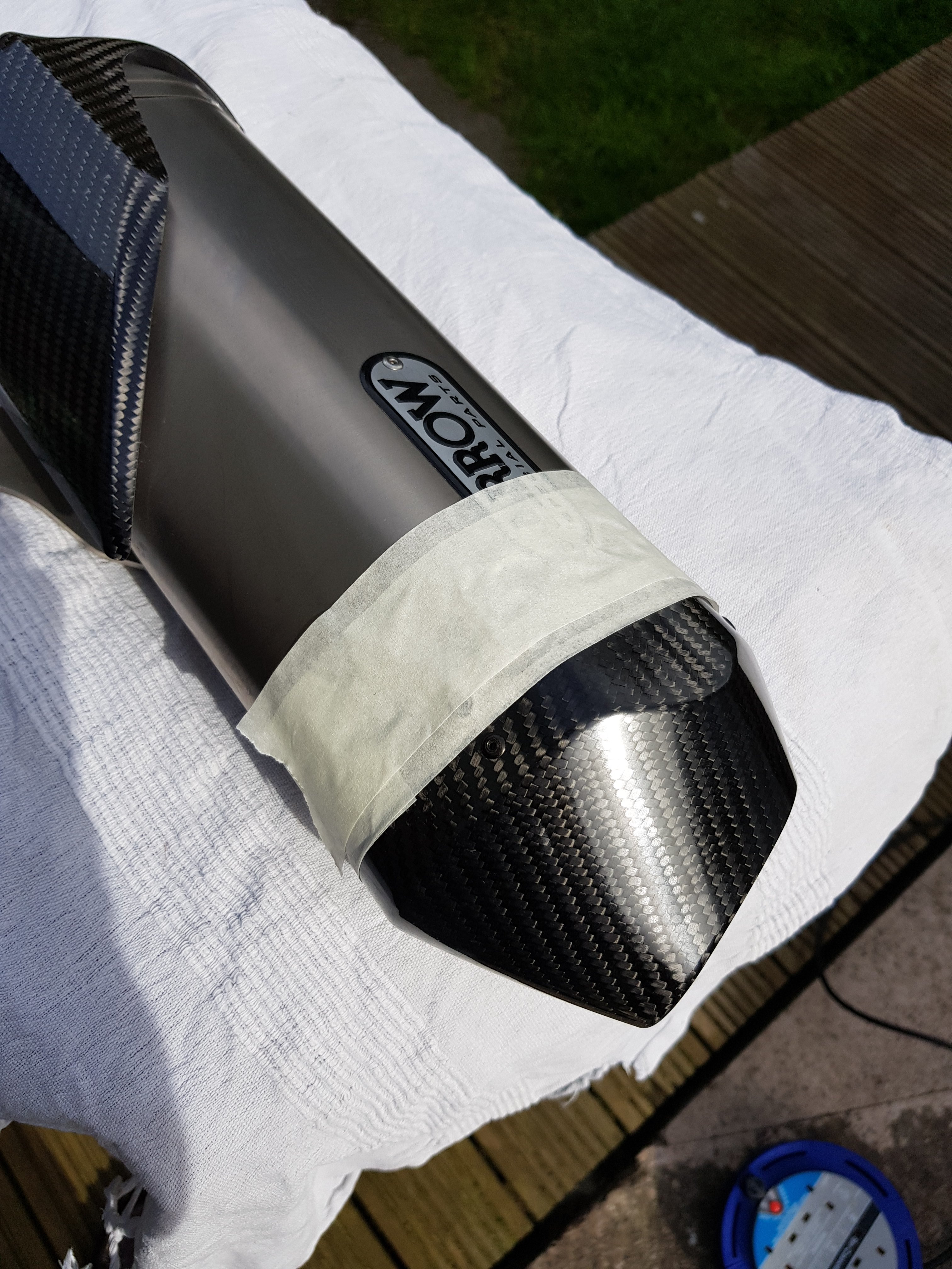

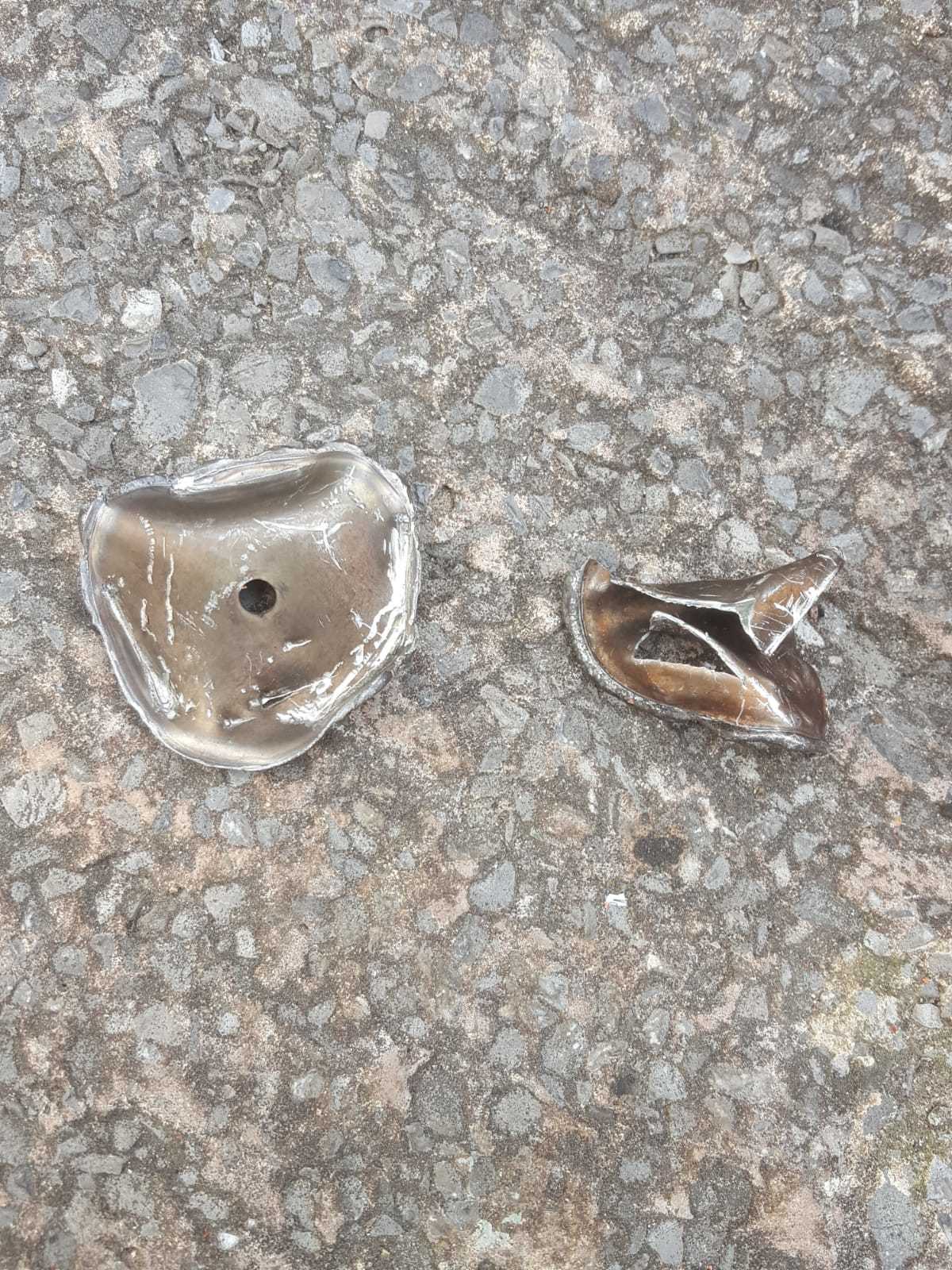

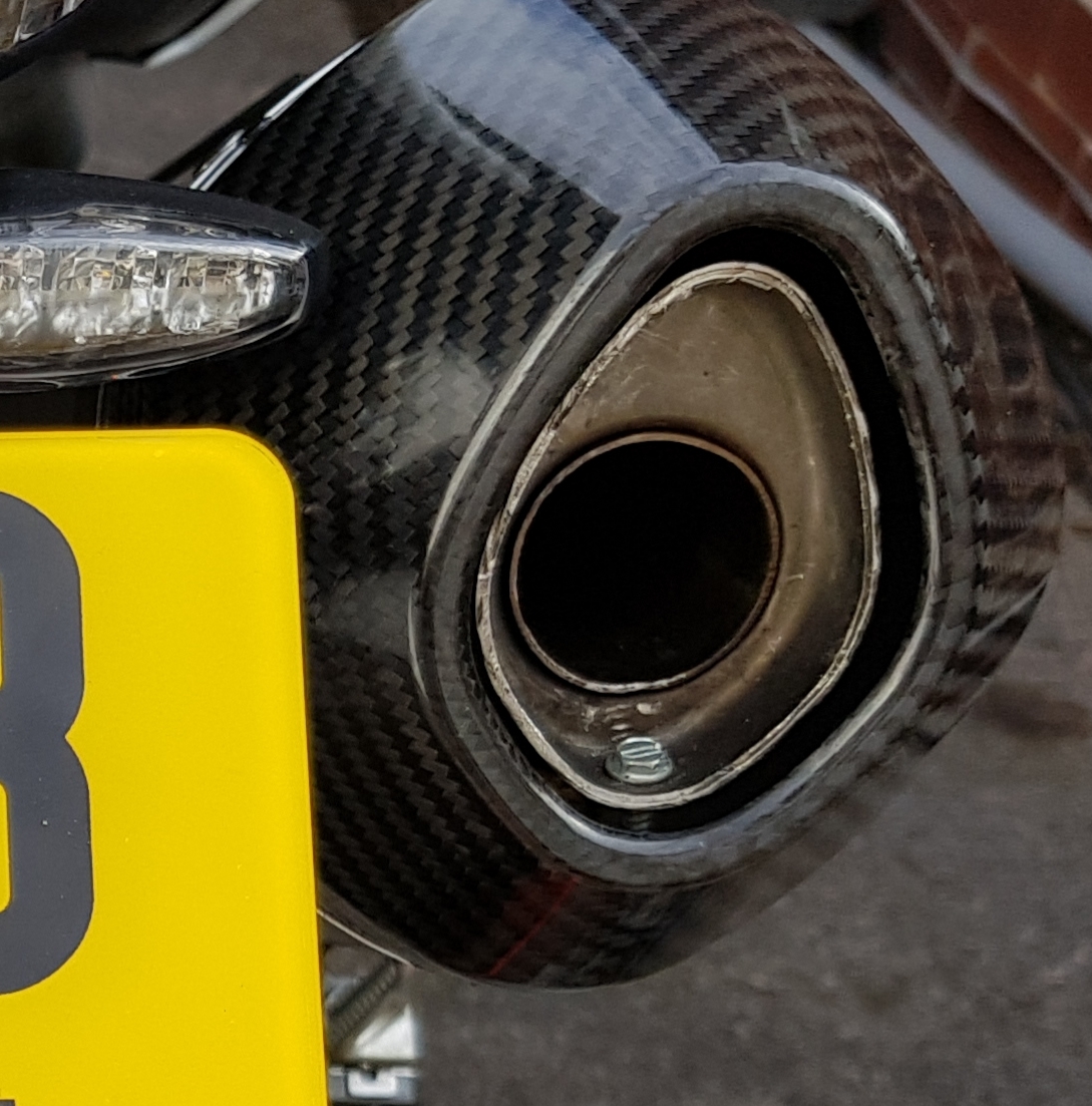

    All done, made them removable, the disc inside the cars is the biggest problem to remove, it's also a nice sound with the baffles in now the disc is removed. It's how it should be now with removable baffles!

  16. Bg357
    Bg357 Active Member
    Apr 30, 2018
    57
    Hope these help, it's a pain of a job but worth it to get the ridiculous disc out, it has a tiny 5mm hole drilled in it and is welded in blocking the pipe right behind the baffles.

    Do you think it's possible to remove the just the discs - while the baffles rand carbon tips remain in place?
    I'm wondering whether attacking the disc from the inner end using an SDS hammer drill with a narrow cold chisel bit would work. It might be more accurate than whacking it with a "BFH".

    I found that the way the welding is on the disc you have to knock it out from the carbon cap end. It's worth all the effort especially as it now has the option of removable baffles. Very loud with them out, with them in its loud but a really nice sound as the disc is gone. I thought after I'd finished the job would it have been possible to remove the disc without the extra work. I think it's possible by using a long drill, and drilling out along the edge of the welding, going all the way around. If you went 3/4 of the way you could then fold it up and down and the the last weld would break away and the disc would come out. On the second disc I used a chisel ro break it free from the carbon end once the baffle was out but when it was 3/4 off I got the disc out as I said. Just a thought but might be worth it.

    Thanks for the extra info :)
    Plenty of options then - and I'm thinking I'll investigate a more 'surgical' approach of removing just the disc and then see how it sounds.
