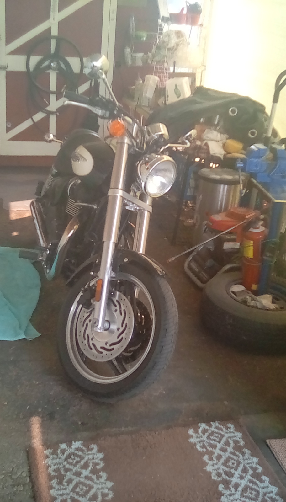

    Can't get mids anywhere thanks to covid I guess. Whose bag is that on the back?
