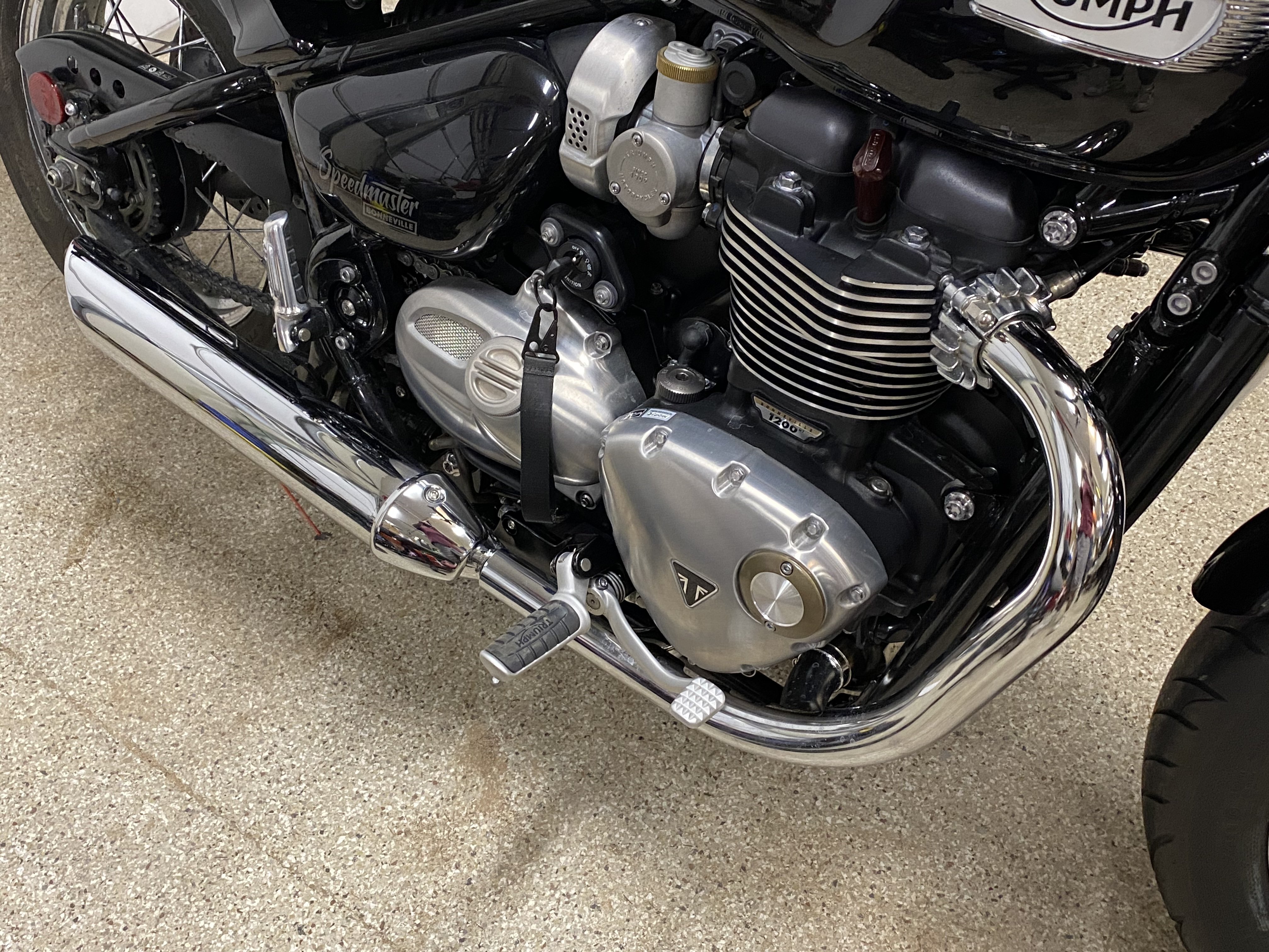

    It really wasn’t difficult. The instructions were very clear and kit includes everything you need. You reuse some parts from forward controls per instructions. You’ll need low end torque wrench (as low as 6) if you want to be precise about the settings. You might want a mate to work with to sense check what you’re doing and to help hold exhaust in place when refitting. Destination Triumph in Sussex mechanic I spoke to said he hadn’t done one, so he would have been doing exactly what we did but saved probably a couple of hundred on labour costs. Be brave and trust yourself. On a scale of 1 to 10 difficulty I would say no more than a 4.

    Mid controls installed. The install was easier than I thought. Definitely can lean the bike more without scraping the pegs. I like the way they feel, so next is probably a handlebar change. Looking for ideas but in no hurry.

    I know this is an old post but perhaps someone can assist me. Where did you guys find install instructions?
  5. Croxbt64
    Croxbt64 New Member
    Jun 4, 2019
    22
    Crawley Uk
    Triumph printed a copy off for me. Didn’t charge. They will have it on their workshop manual. But I did buy the kit from them.
  6. Brutusvk
    Brutusvk Member
    Jan 3, 2021
    45
    Glendale, Az
    i bought my bike out of state, don’t have a local shop yet. Bought the kit online.
    guess I will have to figure it out

    Yes. the instructions were a godsend. Simple. One exhaust clamp was a bit of a pain but other than that, no problem. Made a tremendous difference in riding the bike. My feet still want to go backwards to rear sets. But this is very comfortable. Love the bike. Had me considering trading the zx14r in on a new vespa lol
