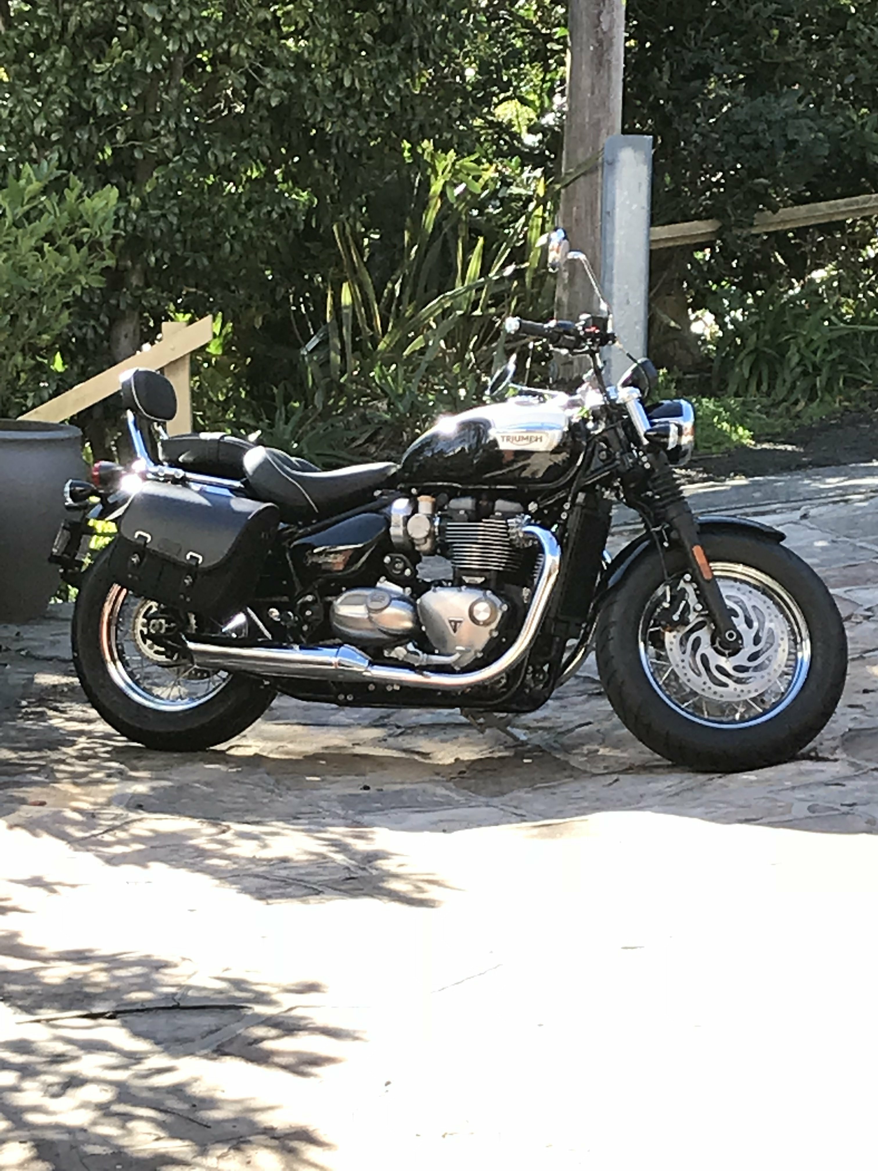

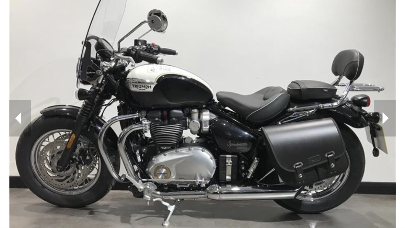

    I put the mid mounts on mine too. I thoroughly recommend it ! Scraping pegs is not an issue now for me. The odd scrape in sharp first or second gear corners using a lot of throttle is all. I put the comfort seat and comfort pillion seat and back rest on it as well. My fiancé is quite happy with that for our day trips.
  3. Kelpy
    Kelpy New Member
    Apr 8, 2019
    11
    Australia
    Oops that first photo is not my bike. Just a stock photo still with the forward controls

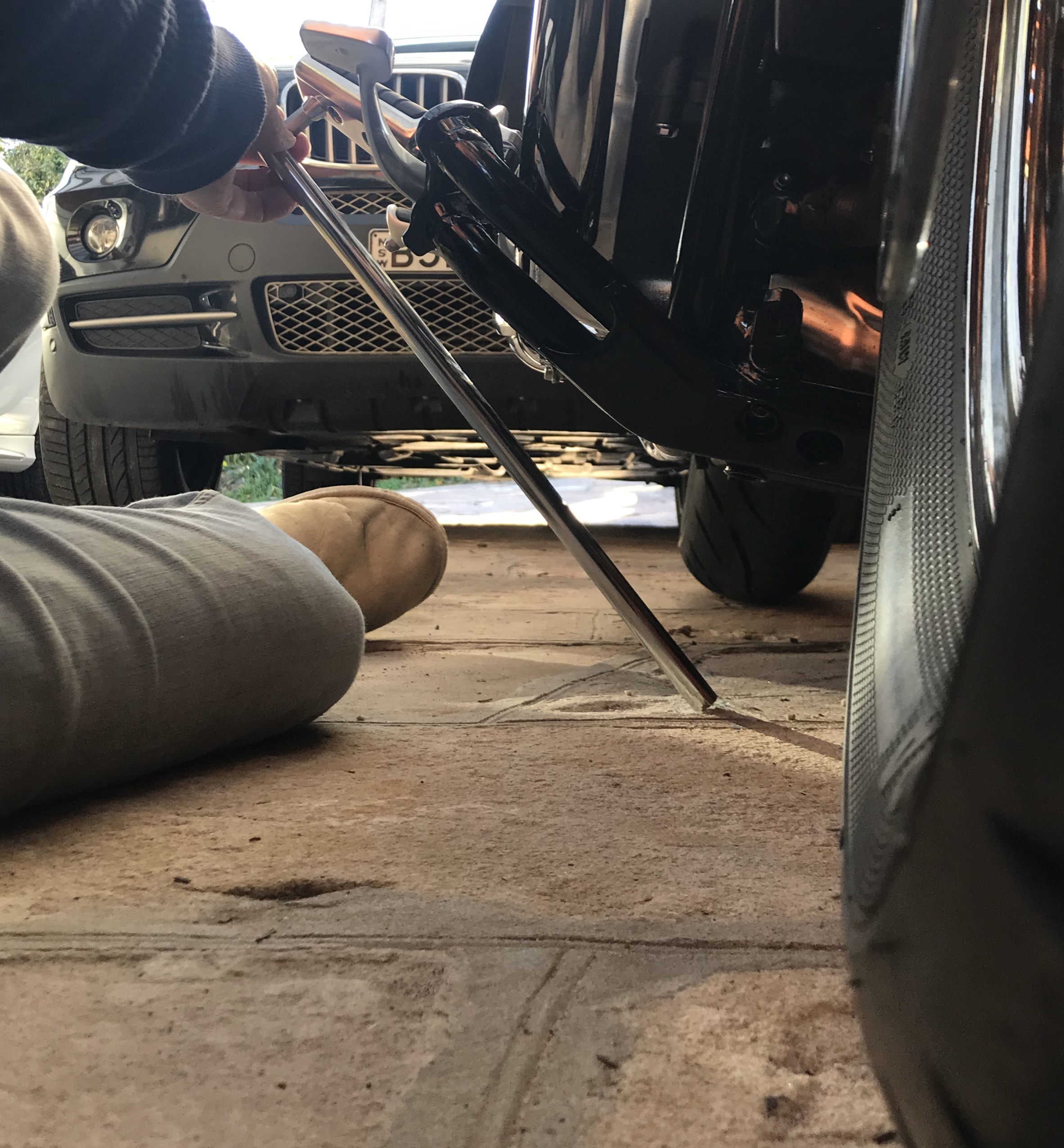

    So this is an attempt at showing how much more lean angle from the mid mounted controls.
    If you look closely at the photo it shows the 2018 Speedmaster with both a forward control AND a mid mount control in place.
    I re mounted the forward one to see the comparison.
    I drew a line on the ground connecting the outer edge of the front and rear tyres. Then positioned camera as close to ground as possible at front tyre. And then positioned a metal rod from the line on the ground to the front mount peg at 90 degrees. Then gradually raised the rod until it connected with the feeler on the front peg. And kept lifting until the line of sight on the camera matches on the front and mid mount peg feelers.
    Yeah I know it’s a bit crude - but it shows roughly how bent the front mounted peg would be before the mid mounted peg starts to scrape.
    In short - a lot more clearance with the mid mounts.
