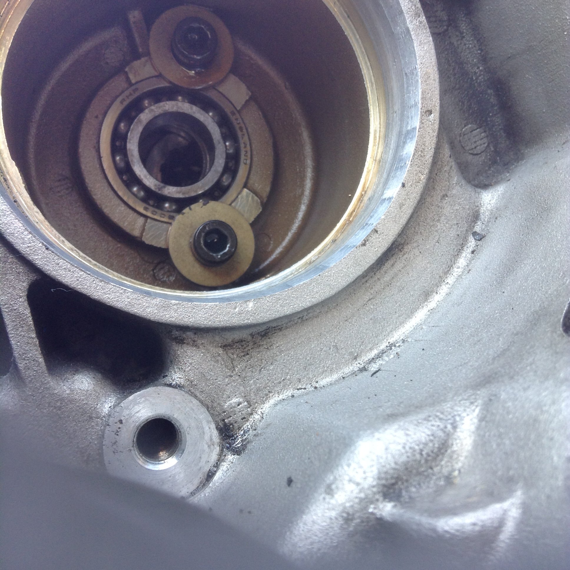

    I think I have just made a big mistake .I pulled out the alternator shaft thinking it will be easier to to fit the alternator to it and slide back. only to find I won't go back as the cogs have slipped down in the shaft hole . I run out of time to look at it better as I may be able the line them up. But i was looking on the net last night and it was mentioned that if you pull it out you may will have to split the Engine!. now I'm worried ......is this true. I have leant so much about this bike over the last year, but I'm now thinking I'm getting too carried away with my level of know-how . I know you learn by your mistakes but this could be big one on my shoe string budget.... :(

    From what I have seen before in the Sprint forum there is a spacer washer that has probably fell into the engine. Sorry mate but it dont look like good news to me. It says earlier engines had a female thread either end of the shaft,later ones ,and yours being a Tbird is probably gonna be the later one,didnt.

    Thanks Dave, it don't look good, I take it its the thrust washer that's the problem then....Shite. this could put me off the road for a while me thinks .

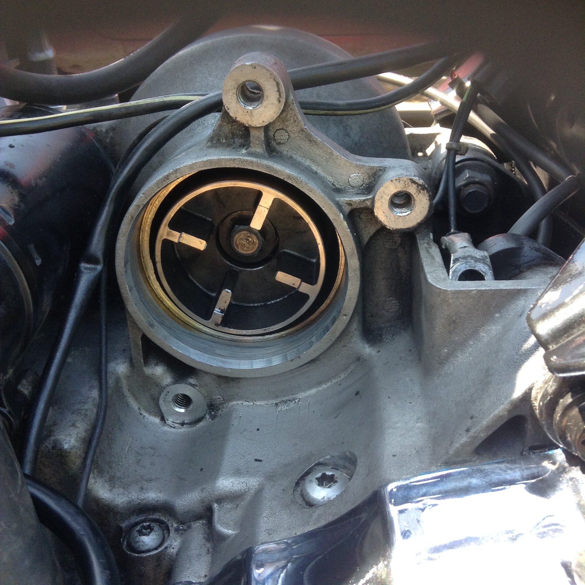

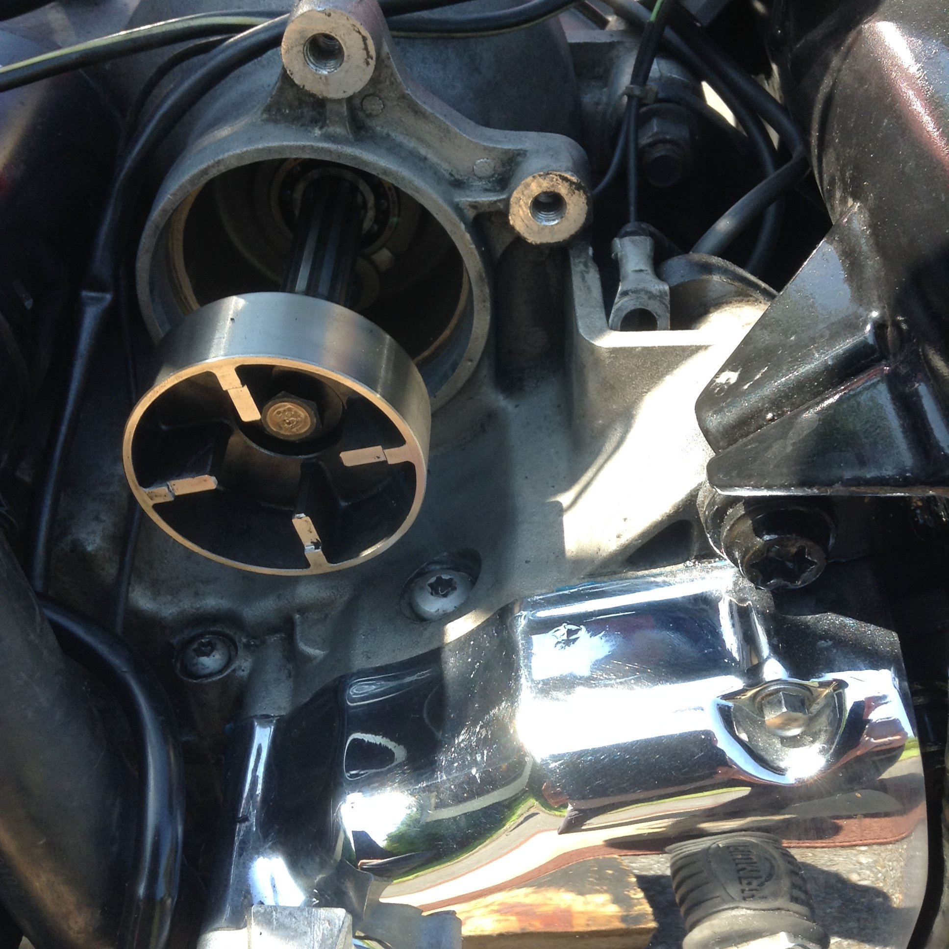

  17. Havit
    9,745
    Ok lads, this is where i am, after messing with screwdrivers for a while i have managed to get the shaft back in fully.........but.......i cant recall if it should be able to turn by hand or not .? Only thing i dont know is if the washer is on it or not......

    Do i gamble ????
  20. thebiglad
    5,072
    If you remove the spark plugs, put the bike in gear and turn the engine over by turning the back wheel.
