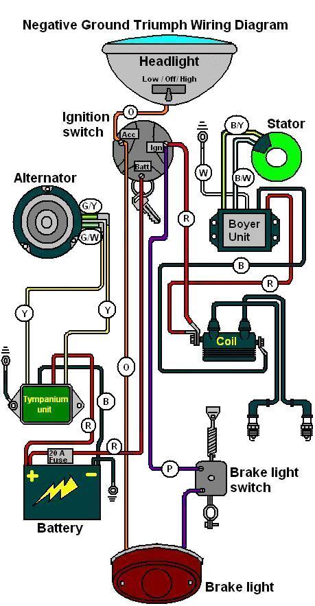

  3. Don the Don
    2,947
    hope this helps it may not be the same year but should give a clue as to direction to look

  13. Don the Don
    2,947
    Okay so use the diagram as a sample but the make of ignition will help

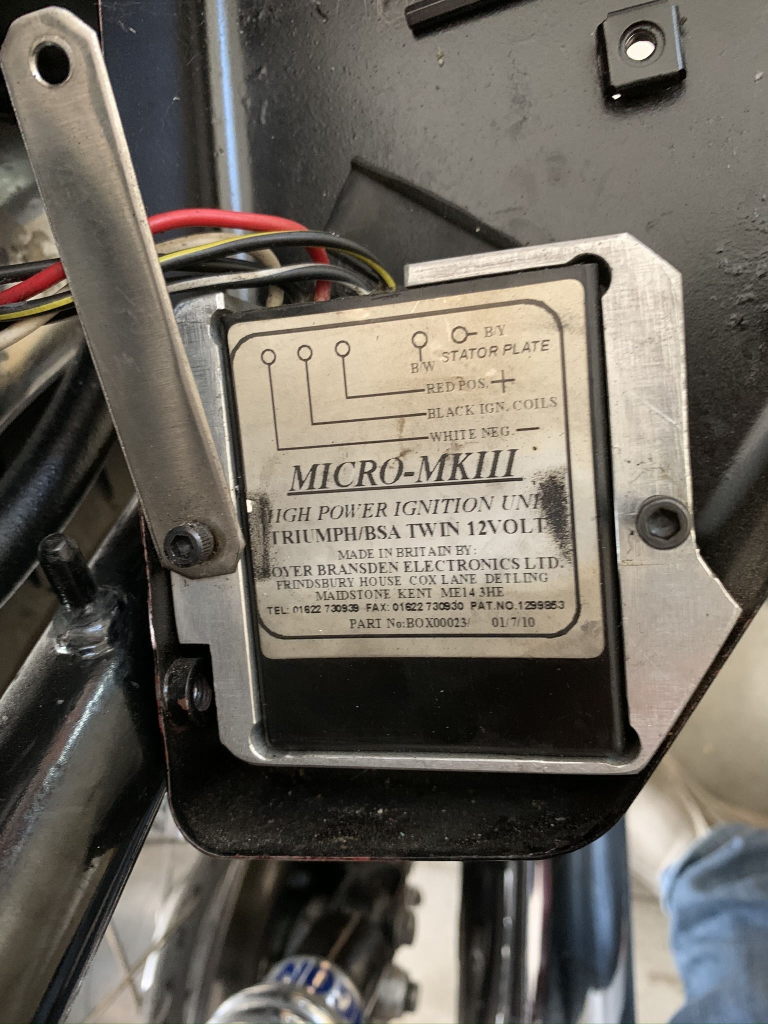

  14. Tricky-Dicky
    Dec 12, 2016
    2,445
    Norfolk UK
    Does the box look like this
    Or this..

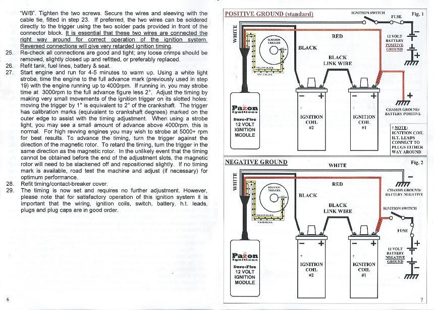

  15. Don the Don
    2,947
    Does anything below look close to what you have this is a boyer pickup & a alternative system

    I will have to l

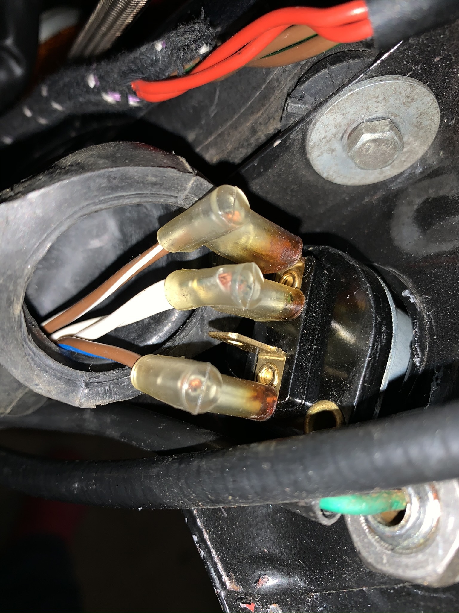

    Check this out.
    I posted a pic of the switch power from blue/brown to white
    And nothing from other leads

  18. joe mc donald
    13,922
    Eric27
    My 77 was positive earth. And I think the blue and brown was disconnected on my bike believe it was for the kill switch. But this is just guessing.
    Regards
    Joe
  19. Don the Don
    2,947
    That's what I thought Joe hence the negative earth diagram

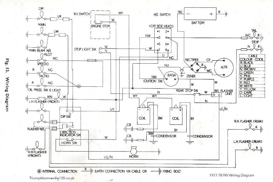

    Eric27 Member
    Jan 14, 2019
    34
    Canada
    This is what I have
