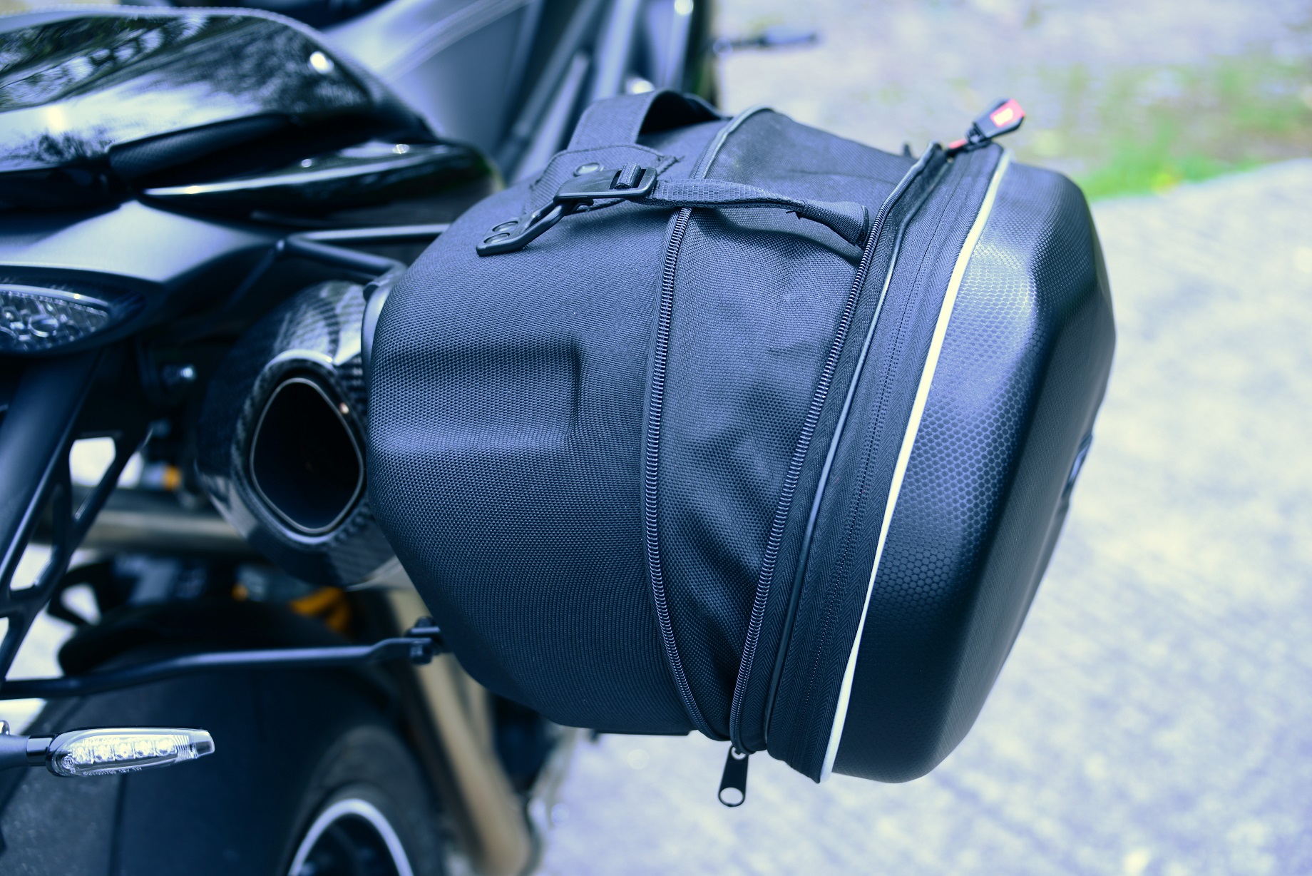

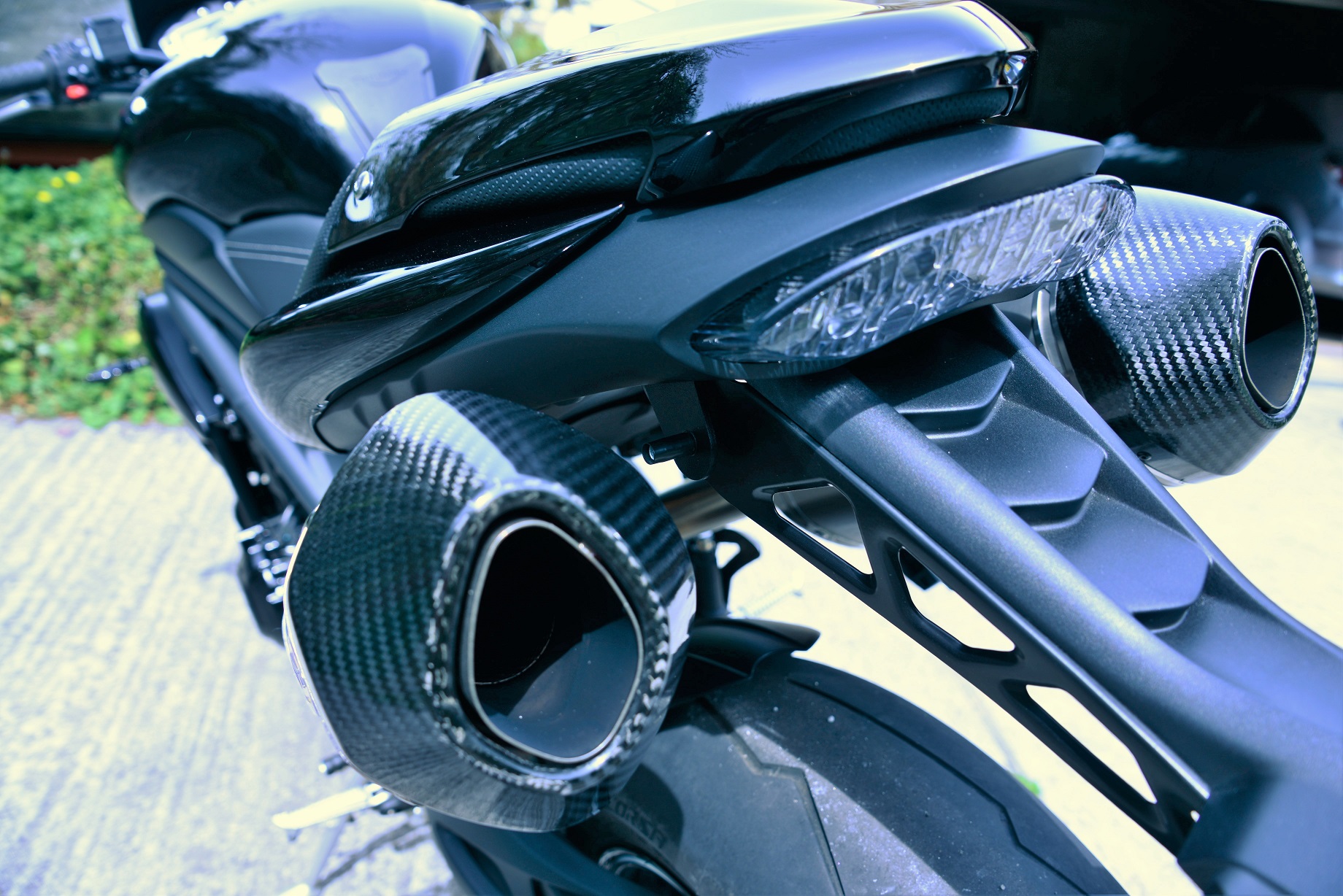

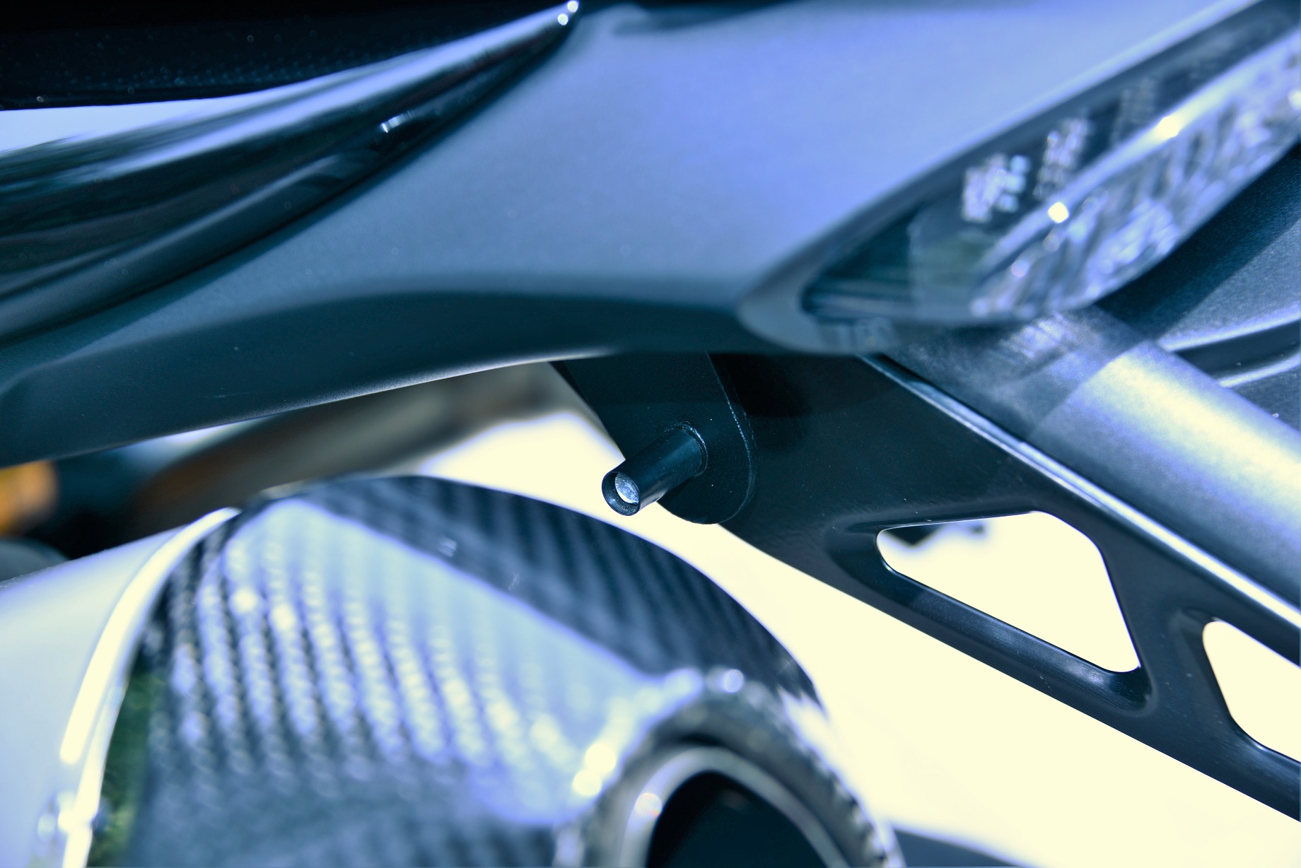

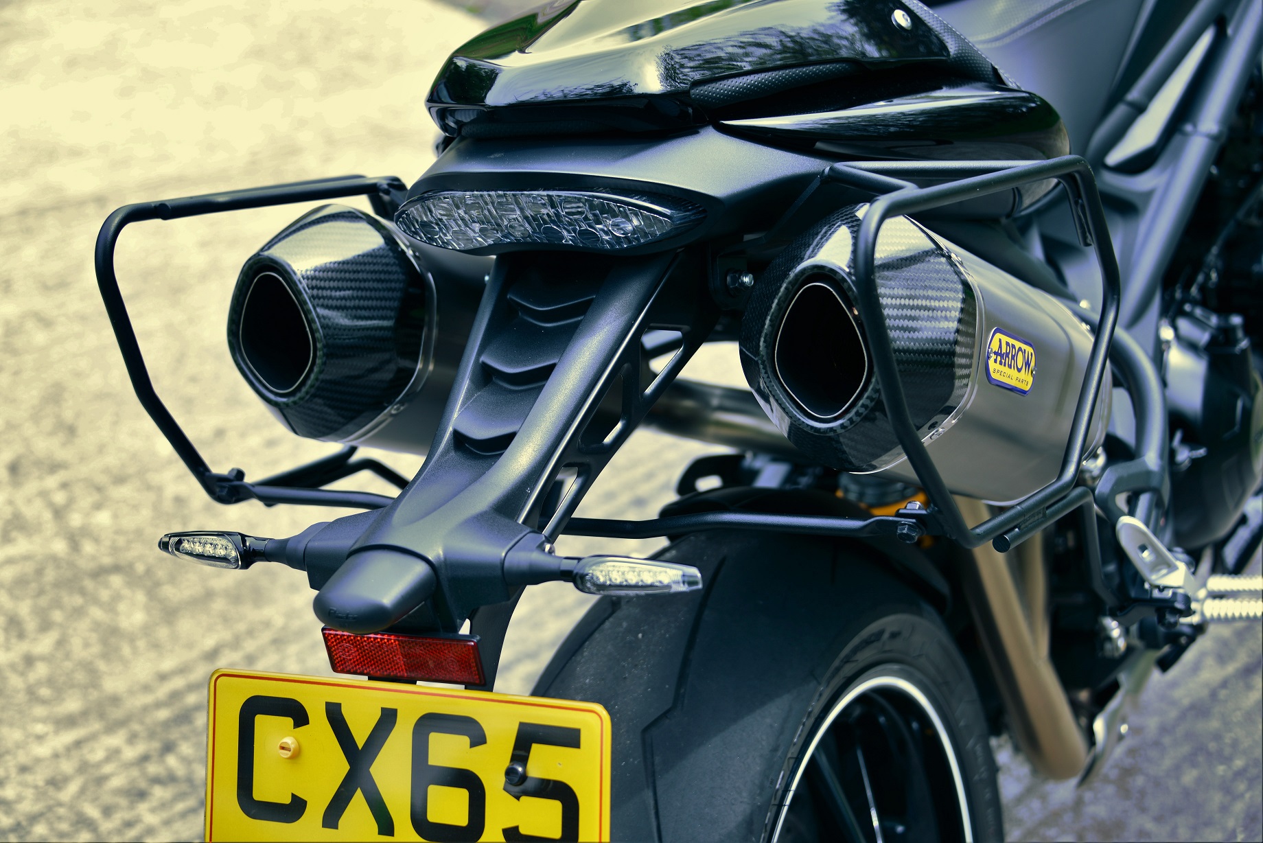

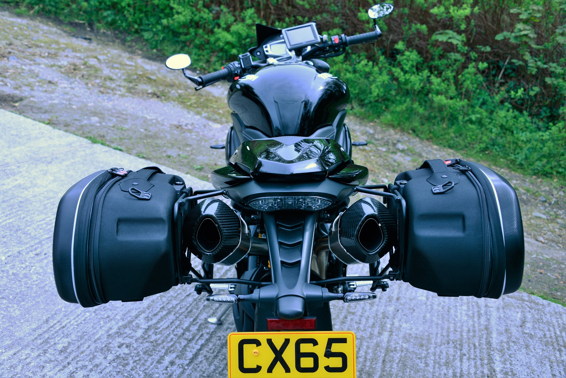

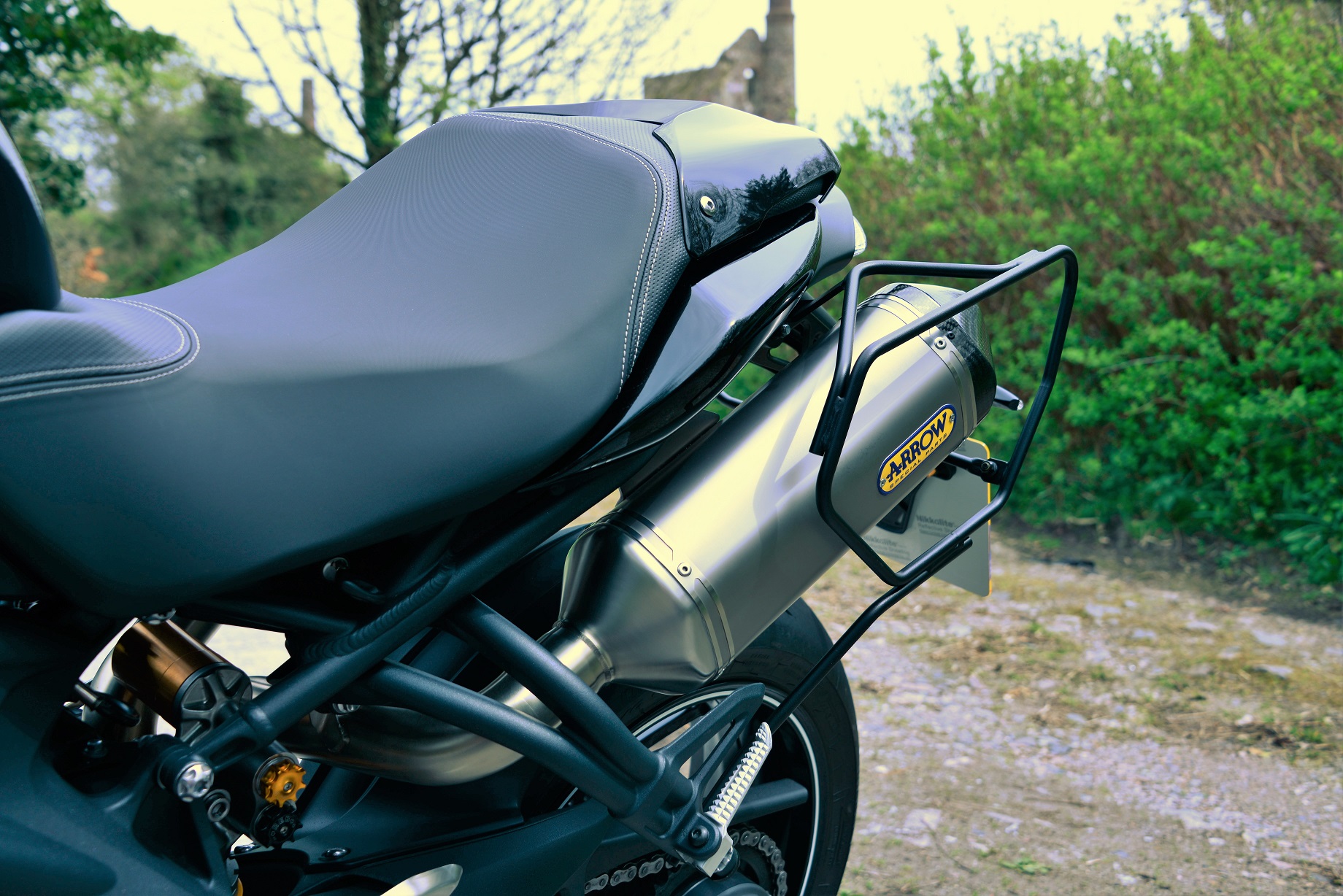

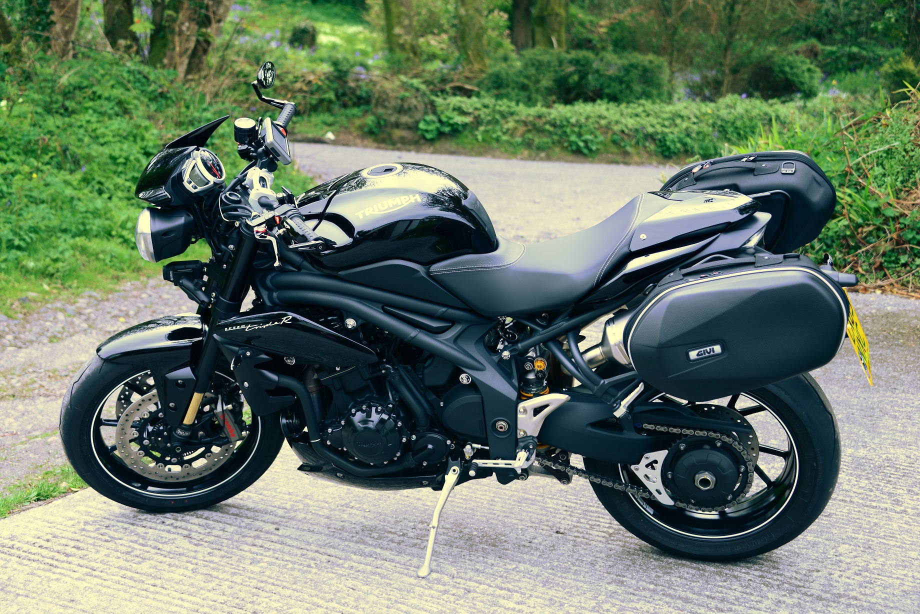

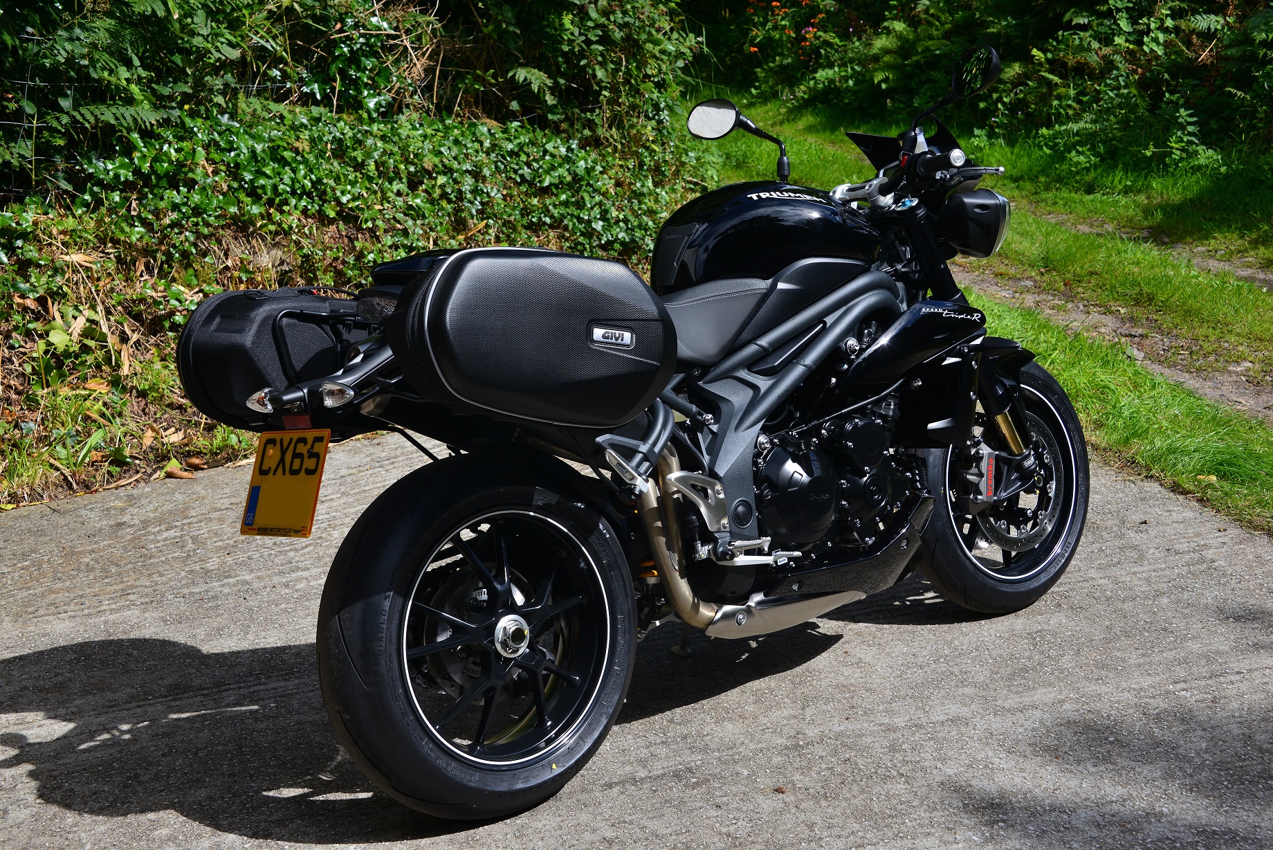

    Hi Carter, can't give a definitive answer as to whether there's any problems with your tail tidy but I assume it mounts on the original bolt fixings of the standard plate hanger, depends on its shape whether it fouls the two stud brackets needed for the Givi frame that also mount there. I've uploaded a bunch of photos which should help you decide.
    2016-05-06_11-17-55.JPG 2016-05-06_11-18-34.JPG 2016-05-06_11-58-52.JPG 2016-05-06_12-01-53.JPG 2016-05-06_12-10-33.JPG 2016-05-06_12-12-19.JPG 2016-05-06_13-38-56.JPG
    The Givi fitting instructions are here and help to explain.
    I usually run with pillion pegs and pannier frame removed, the only part that stays on the bike is the stud brackets (with a bit of black sleeving over the studs to hide them). Takes half hour tops to re-fit pegs and frame.
    The Arrow cans are a bit wider than standard but still just about clear the panniers, not had any problems with heat.
    Generally pleased with them....but have had one problem which hopefully is a one off, I had one pannier fall off after going over a sunken manhole cover. It was a BIG bump! The pannier survived remarkably well with only cosmetic damage and simply refitted allowing us to continue with the holiday, eventually I got Givi to replace it under warranty.

    Looking through the destrucrions I think I'd get away with it...might just have a little flex in the studs as there's nothing for the brackets to rest on, as it does the oe tail tidy. nothing I can't sort with a long threaded rod. gonna have to bite the bullet and grab a set for myself I think! cheers for the info.

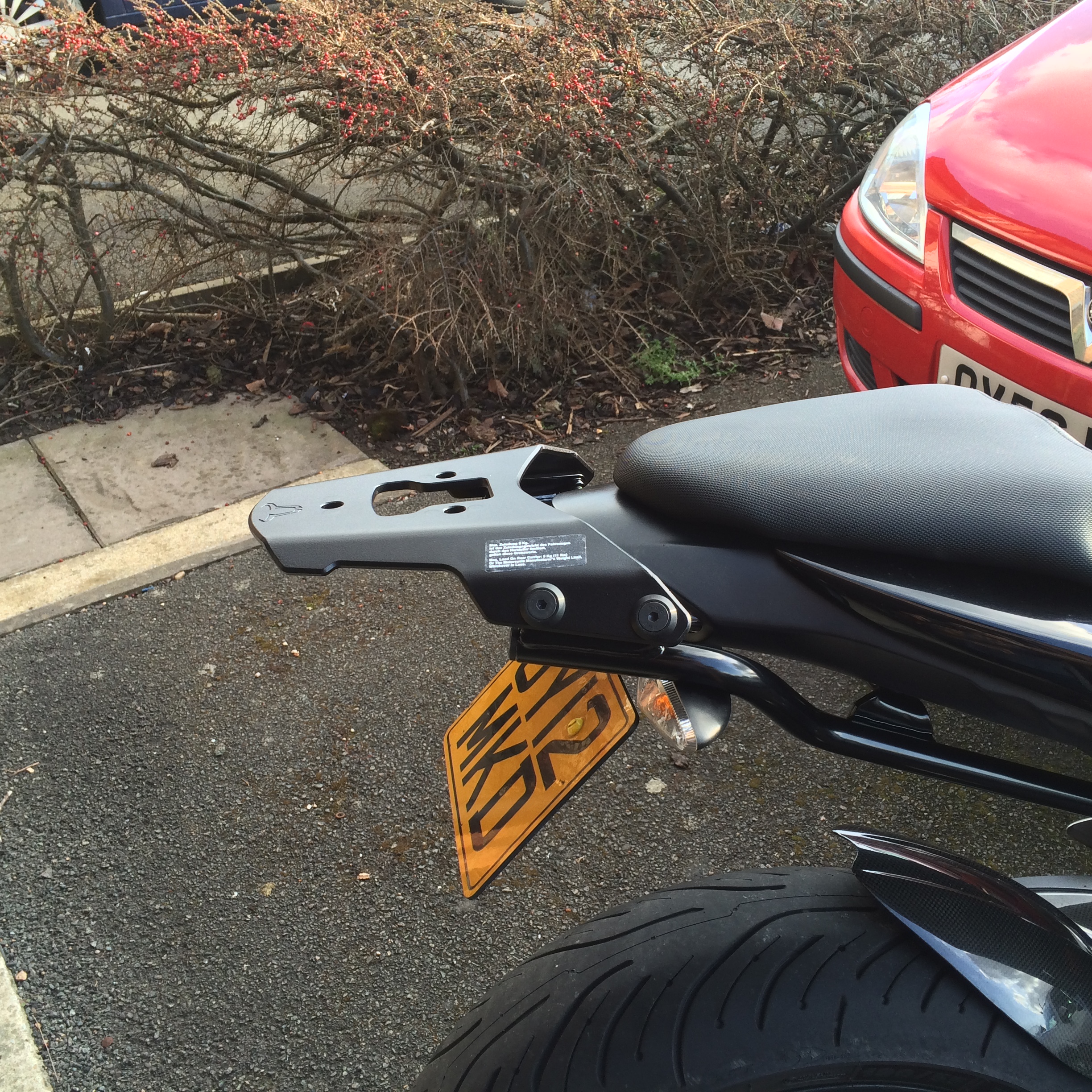

    I've fitted a SW Motech top box rack and Givi Blade top box. Combined with a Kreiga tank bag system, everything is secure and waterproof. Then when you get there it's 5 seconds to remove top box and away you go. Doesn't seem to upset bike's handling too much, even with top box loaded up for a few days away. And when you leave the bike you don't have to worry about someone nicking your kit!
    I'm sure style aficionados will moan, but I think my set up looks ok. I call it the Speed Triple Touring

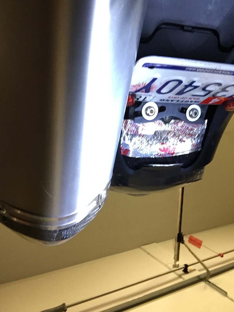

    I've had my eye on the Givi panniers for awhile, but now I see the hangers might not be compatible with my custom tail tidy. Col_C, can you snap a photo from underneath (a similar angle to this one) or at least take a look at this and tell me if those stud brackets mount to the same location as my plate hanger?
    You see the problem is I'm quite happy with how "tidy" my tail tidy looks
    The plate hanger bolts to the two rear-most locations where the factory fender mounts.

    Hi muzhik, you can't see anything of the bracket from underneath (standard plastic covers it all), the only visible parts are what you can see in the second photo I posted above. Also if you follow that link just below the photos you'll get the Givi fitting instructions, page 4 shows the brackets mount to the 4 bolt holes that the standard plate hanger mounts off.
    Looking at your photos your license plate is going to be in the way. :(

    Thanks, Col. I suppose I can turn my license plate bracket around either direction and/or fabricate something else up (worse case) should I decide to get luggage some day.
