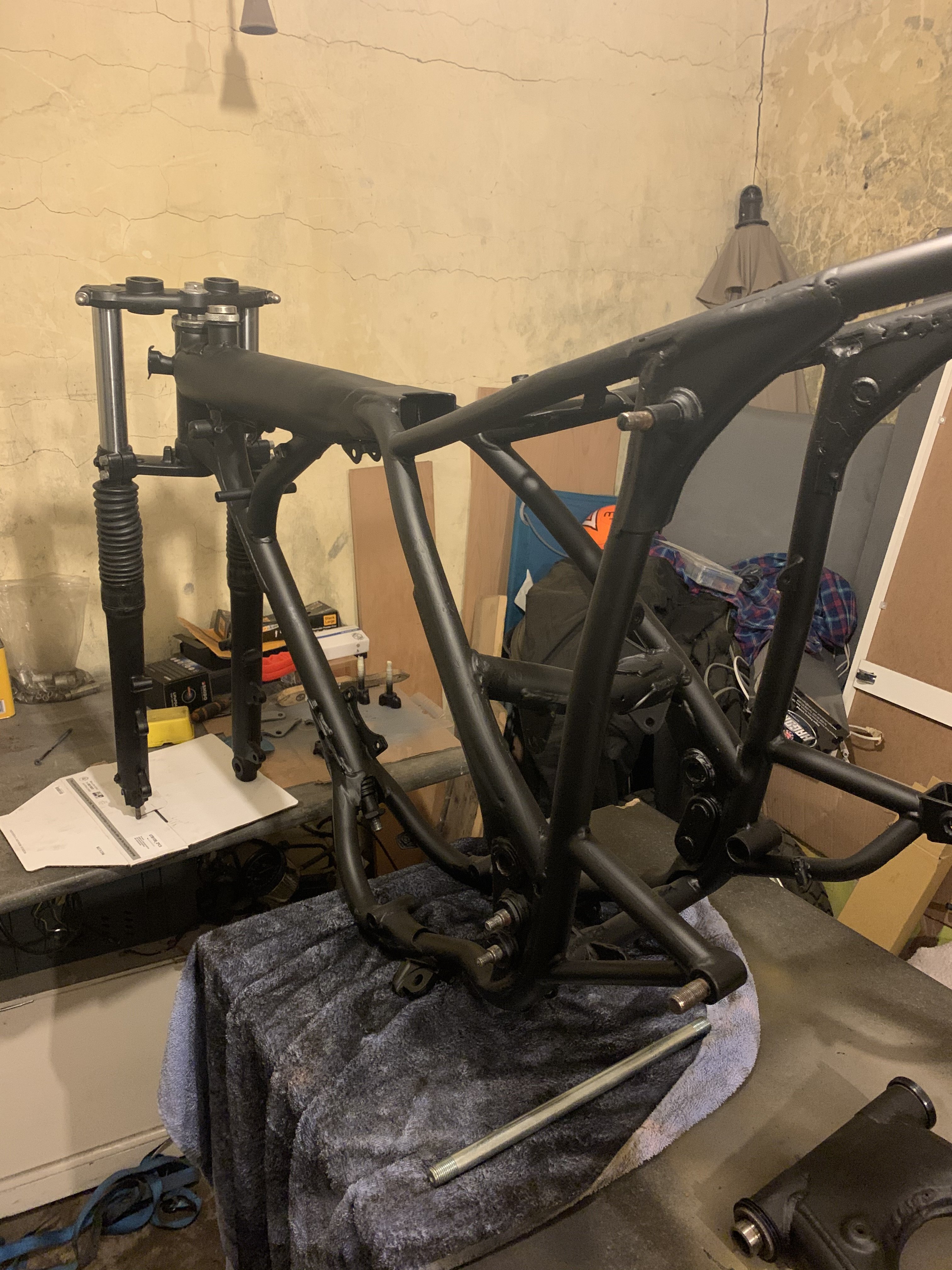

    Progress has been slow over the last couple of weeks with being away for a few weekends, plus clearing our downstairs and moving in with the mother-in-law (o_O) ready for a major kitchen/dining room knock through.

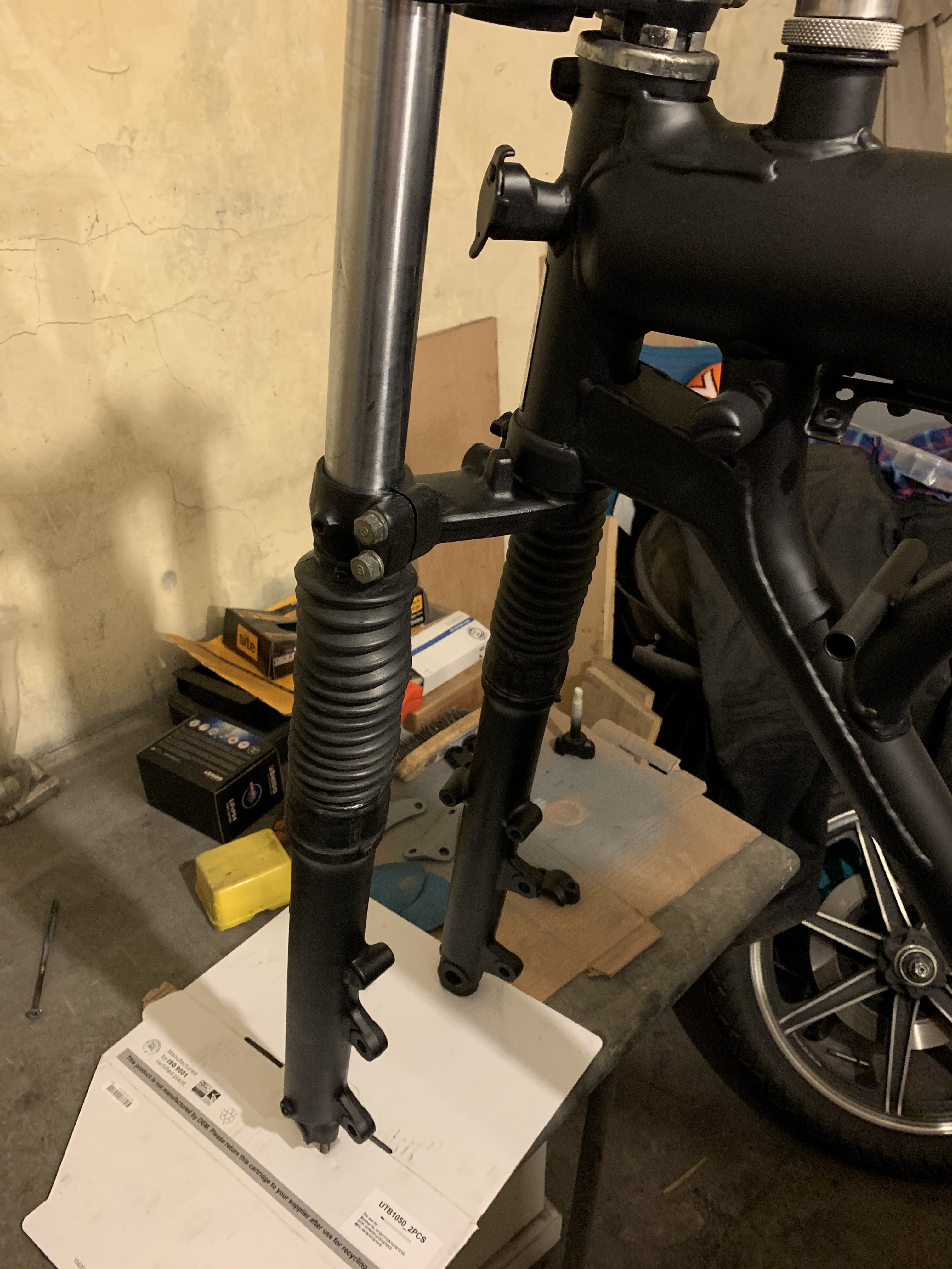

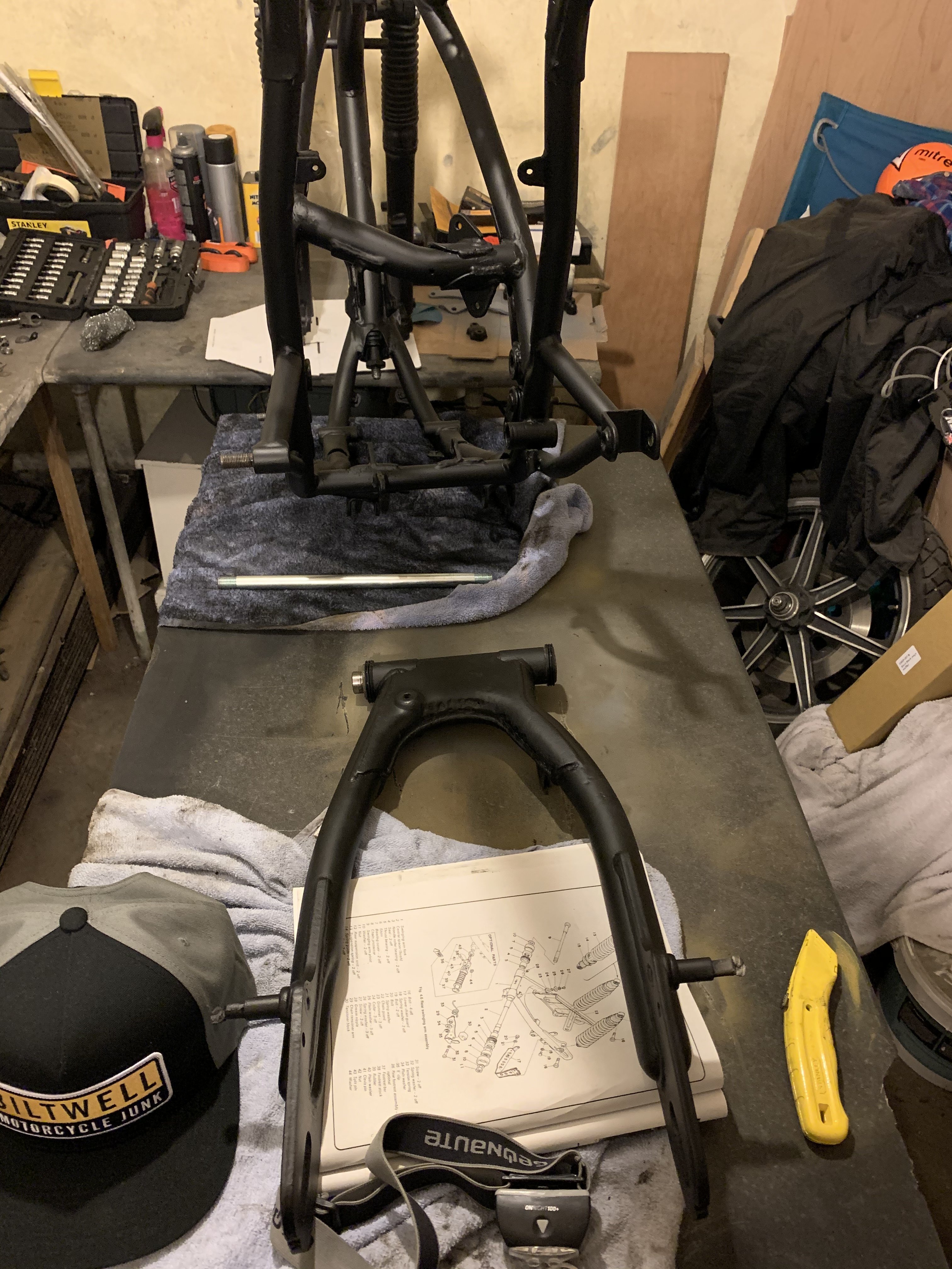

    Managed to get back in the shed last night having sprayed the forks, yokes and swing-arm. What colour I hear you ask? Yep, spot on, black. :p
    Put a new All Balls swing-arm bearing assembly together but realised it came without seal cups which were ordered immediately. Once the swing arm is in the frame is then complete, and the new Hagon shocks will go on. It's starting to come together...
    Opening some style questions to the floor:
    1. Do I get rid of the fork sleeves and have just dust seals?

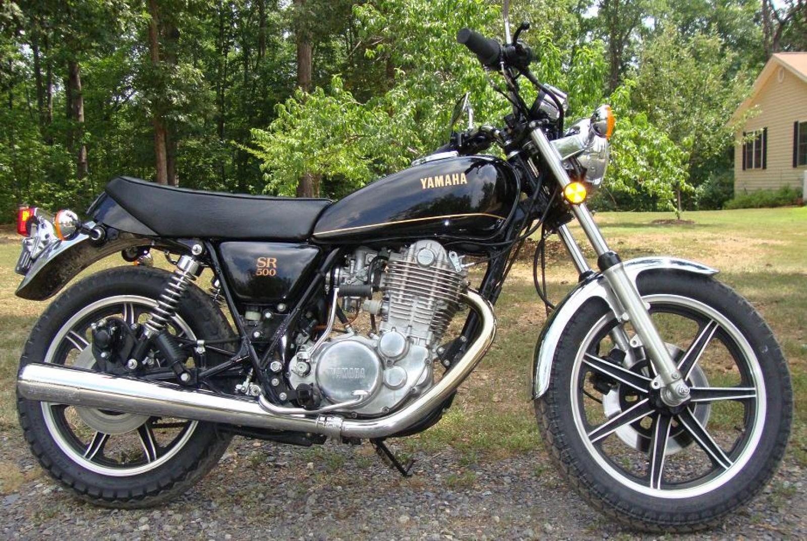

    2. Do I keep the original wheel style (black with silver)? Example image below
  2. curly
    curly Noble Member
    Jul 3, 2016
    758
    Burton Upon Trent
    Keep it as per image

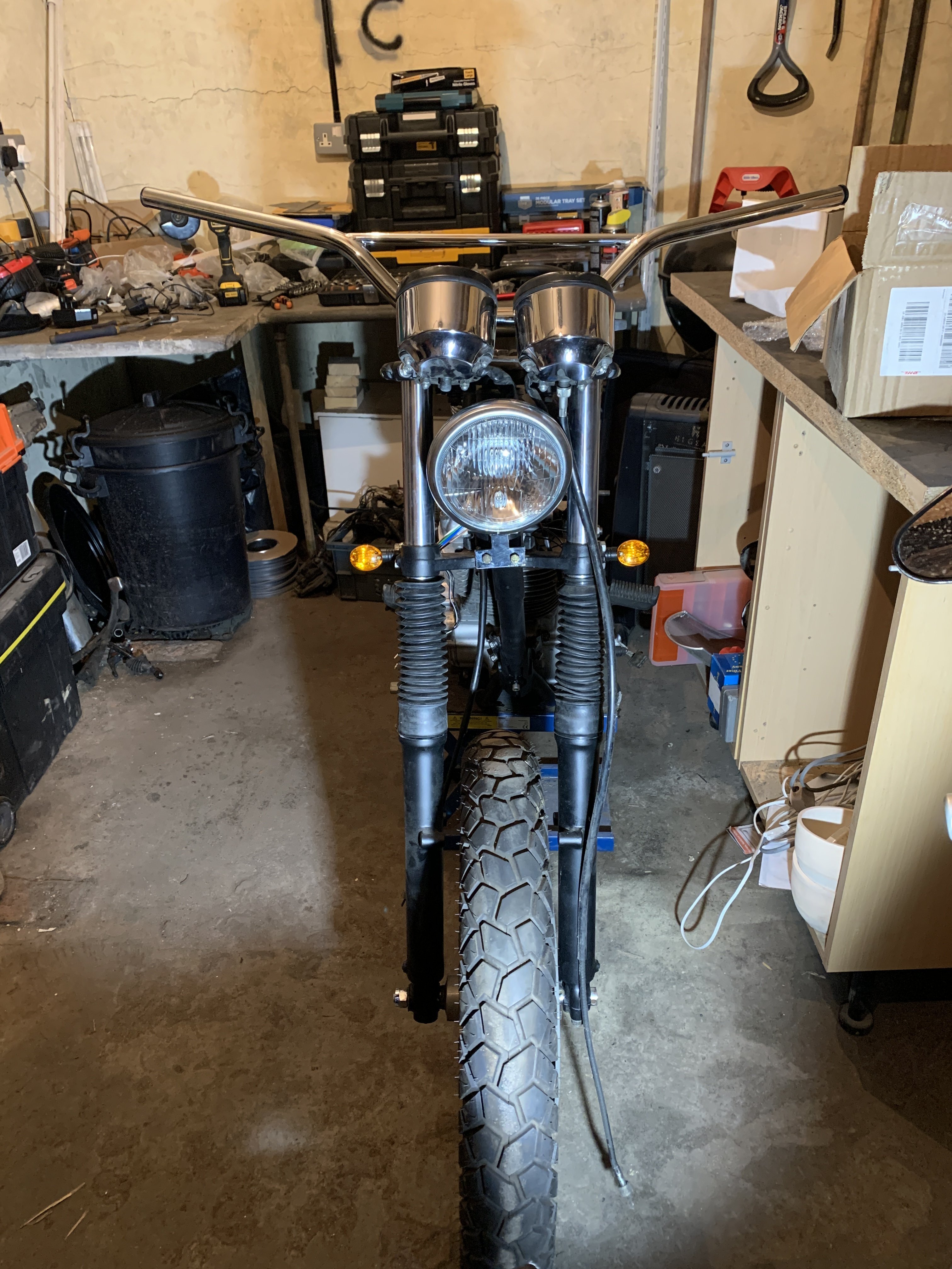

    I suppose I did have an extension built, recovered from that and then the world went to shit... anyhow, back in the shed I am at last. Had a few hiccups related to studs for the rear suspension. Ended up having to re-weld a threaded section on as it sheared off when fitting the new shocks. A bump in the road, they may say.

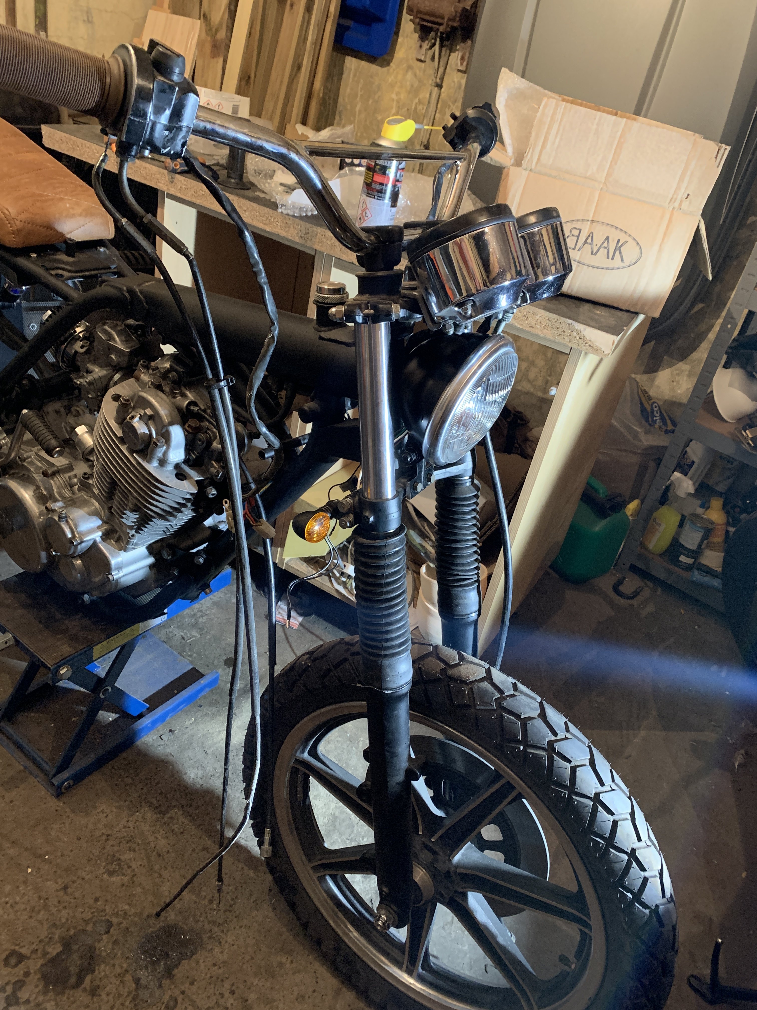

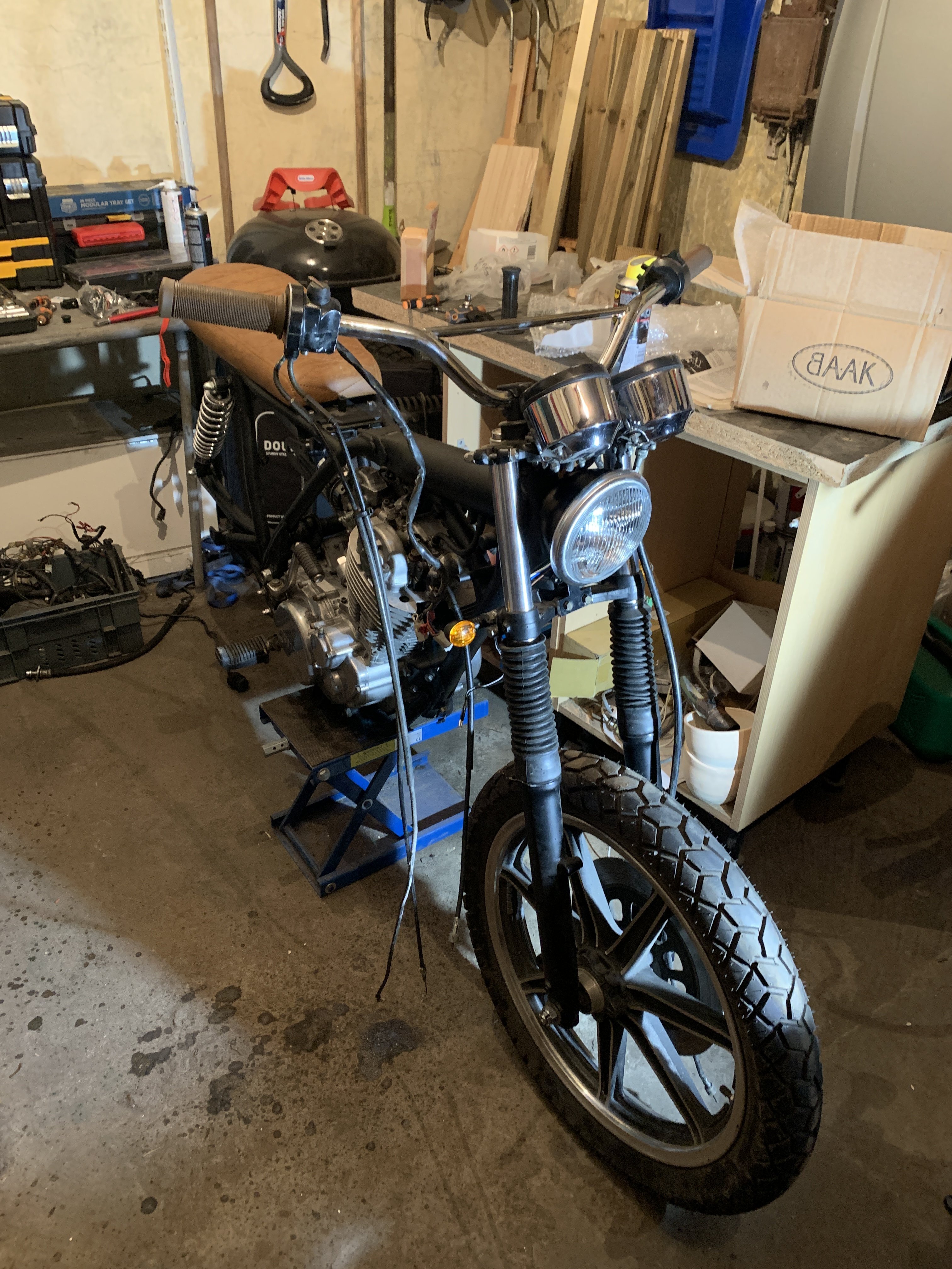

    So, with shocks fitted it only seemed right to drop the engine back in. As mentioned when stripping the thing down, I discovered a couple of cracked engine mounts. We fabricated the lower frame mount when welding the seat hoop but I ended up buying a new top mount. Turns out the manufacturing tolerance where this came from are waaaay out. Ended up having to drill out one side to get the bolt through. Easily solved and means my old kitchen unit is now redundant, and massively in the way :joy: dropped the bike onto an engine mount and got the front wheel on, then started adding as much as I could before I start having a go at the wiring loom.
    I’ve swapped out the original headlight for a small Bates headlight from Baak, as well as two sets of mini indicators which are mounted on the yoke bolts and will go on the suspension shock mounts. These require all new wiring which is going to be a steep learning curve.
    Photos attached for your pleasure.
    Question for the floor:
    Do I buy a mini head unit to replace the double original speedo and rev counter? Can’t see past the dials looking giant over the light...

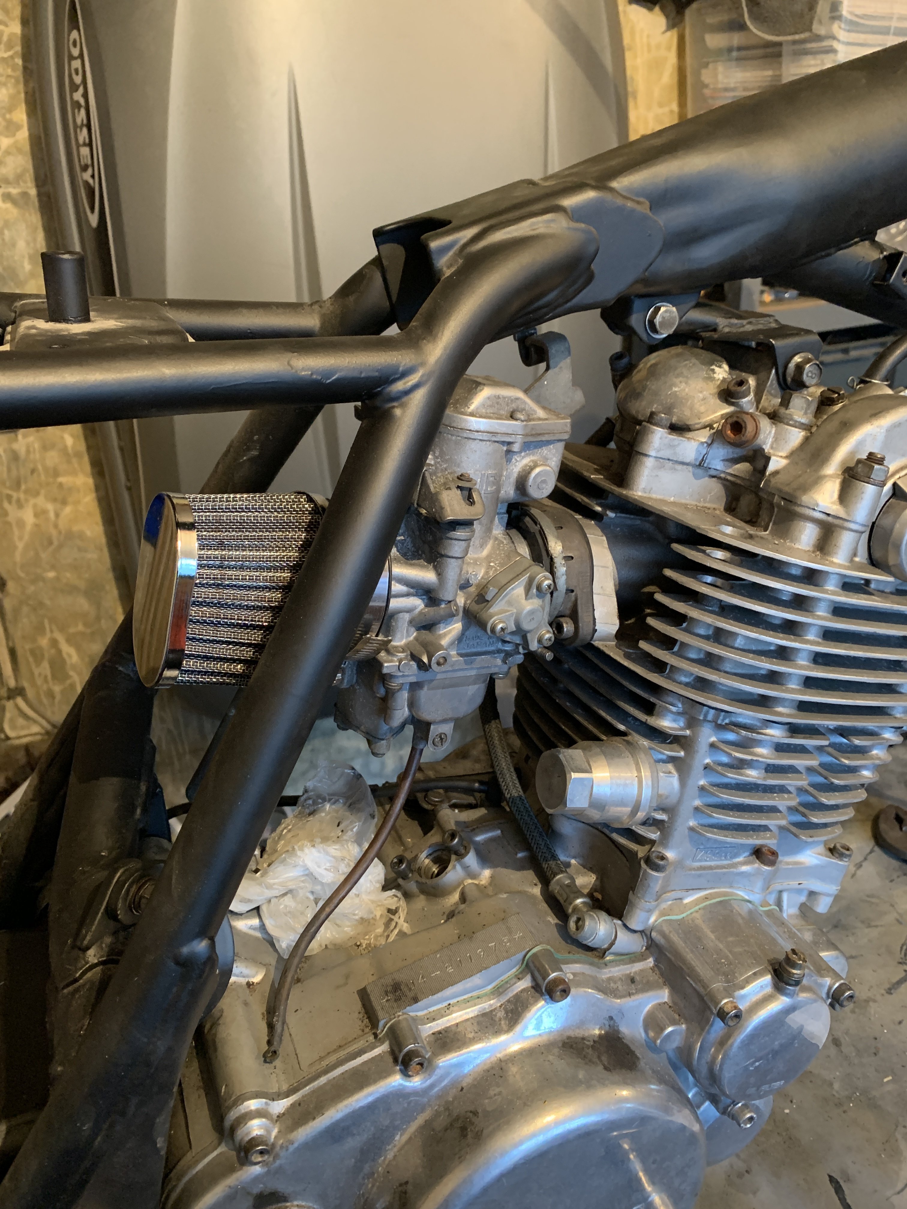

    More images for the dials/headlight question...plus a shiny new air filter

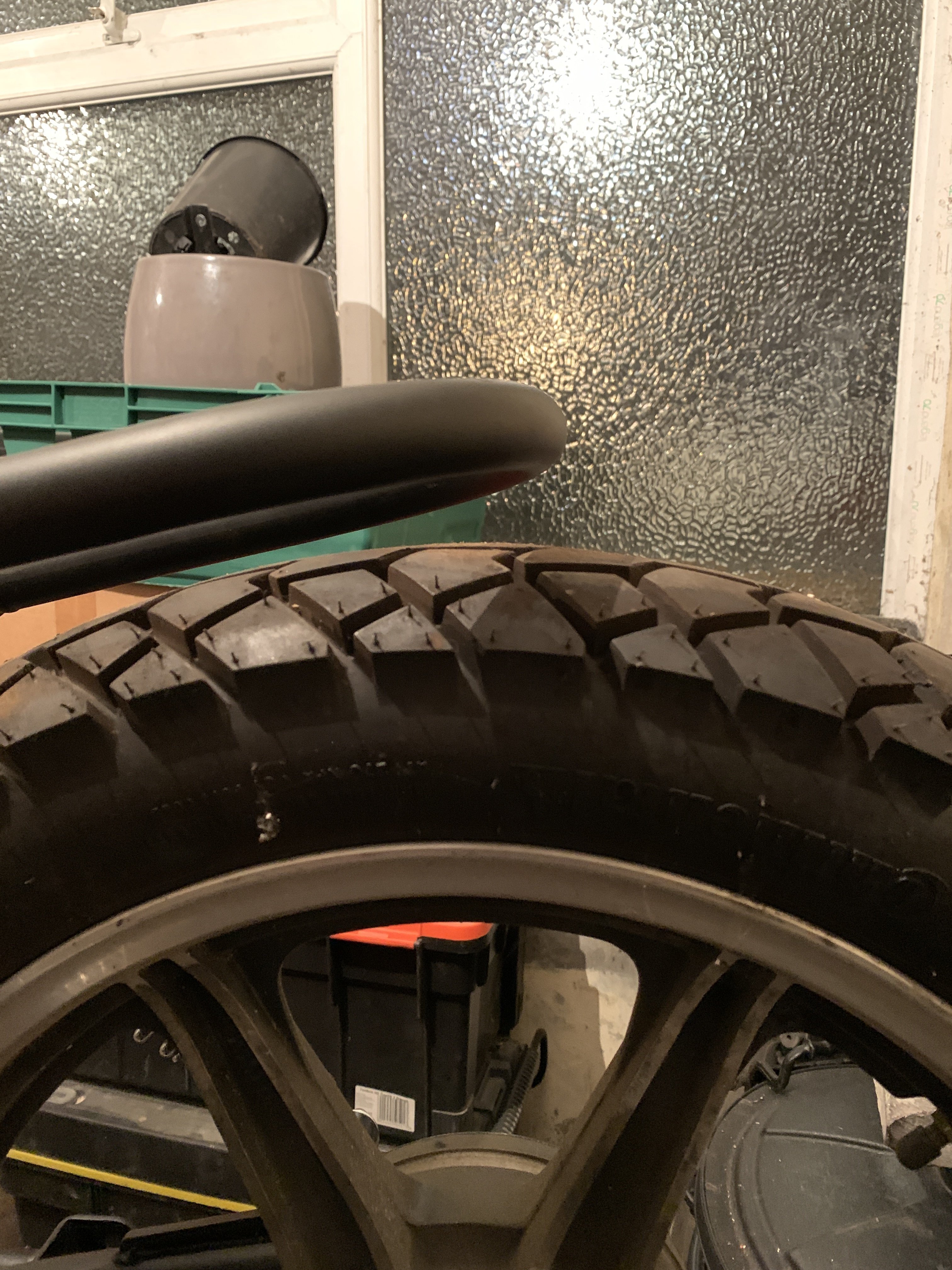

    Balls. Kinda messed up.
    Managed to get to the point where the back wheel is back on in prep to reset the back brake, then realised this...
    Back to the drawing board with this loop. I either cut it off and shorten it, or put a couple of cuts either side and raise it.
