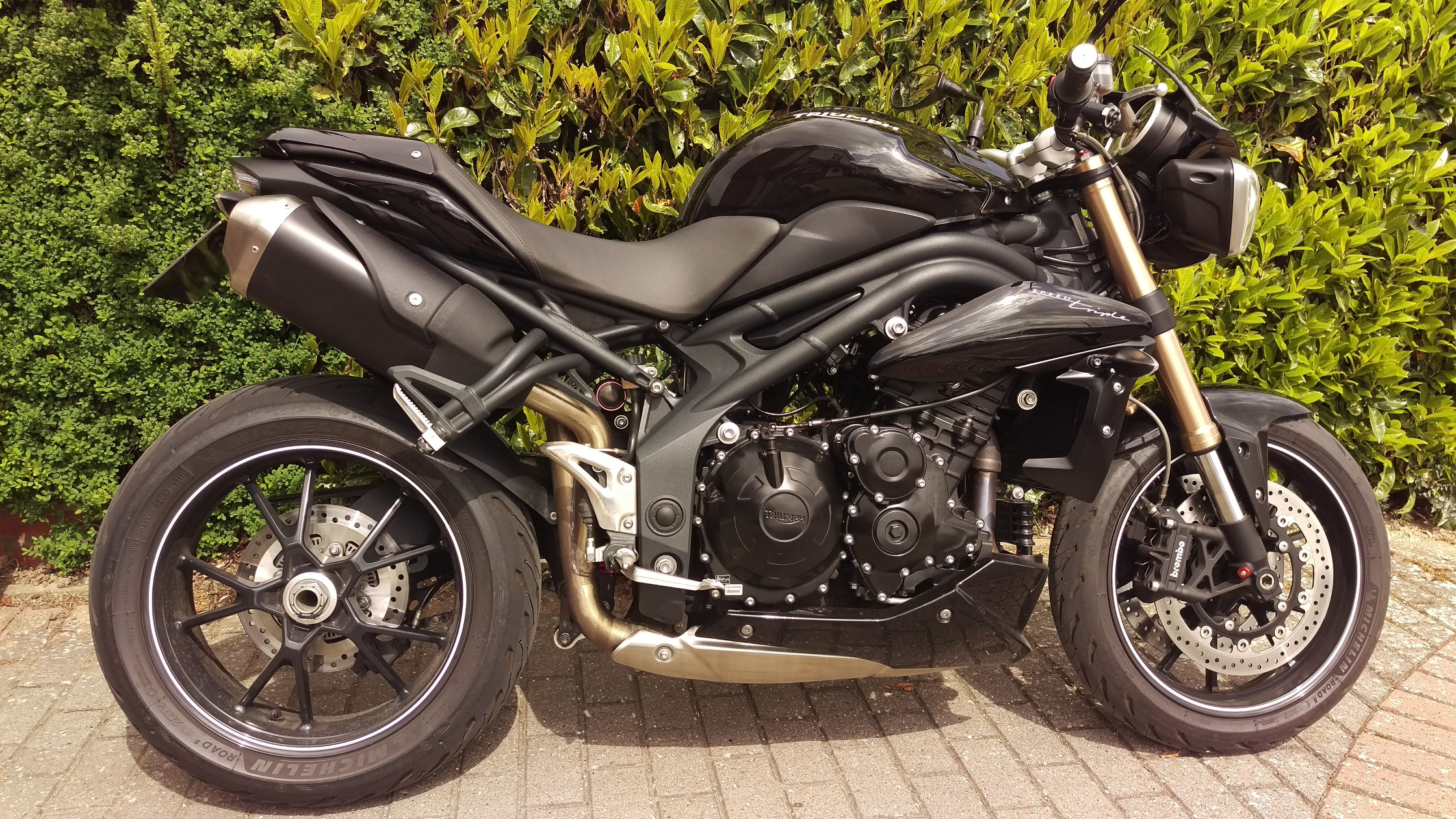

    Gents.....and Ladies (in the interest of current best practice) :)
    I have used my Ninja-Like keyboard skills in an attempt to find a previous post that answers my question but to no avail...…..so with that in mind, I call upon those with far more 'Tri' with their 'umph' than me as a newbie to help.
    I have just picked up my new (to me) Speed Triple....its a beauty, 2015 '94 with 2,500 mile on it so pretty much mint. With that in mind, obviously, the first thing I am doing is spending money to make it even prettier...….as we all do. I've already fitted the EvoTech tidy...then proceeded to melt one of the stock indicators so pick up the LED upgrade from Triumph tomorrow. They will then go on with one of the angled EvoTech brackets and a lesson learnt :laughing:.
    My question to the brethren is this, has anyone got/seen/dreamt of or even imagined in a slightly visual way adding the high-slung Akrapovic with the combo of EvoTech and LED's? I'm just trying to work out if the cans will be far enough back for the indicators to squeeze in, either horizonal or on the angled bracket.
    Thank you for reading and here it is 'so far' :yum and yes....her arse does look big in those....hence the Akra question ;)

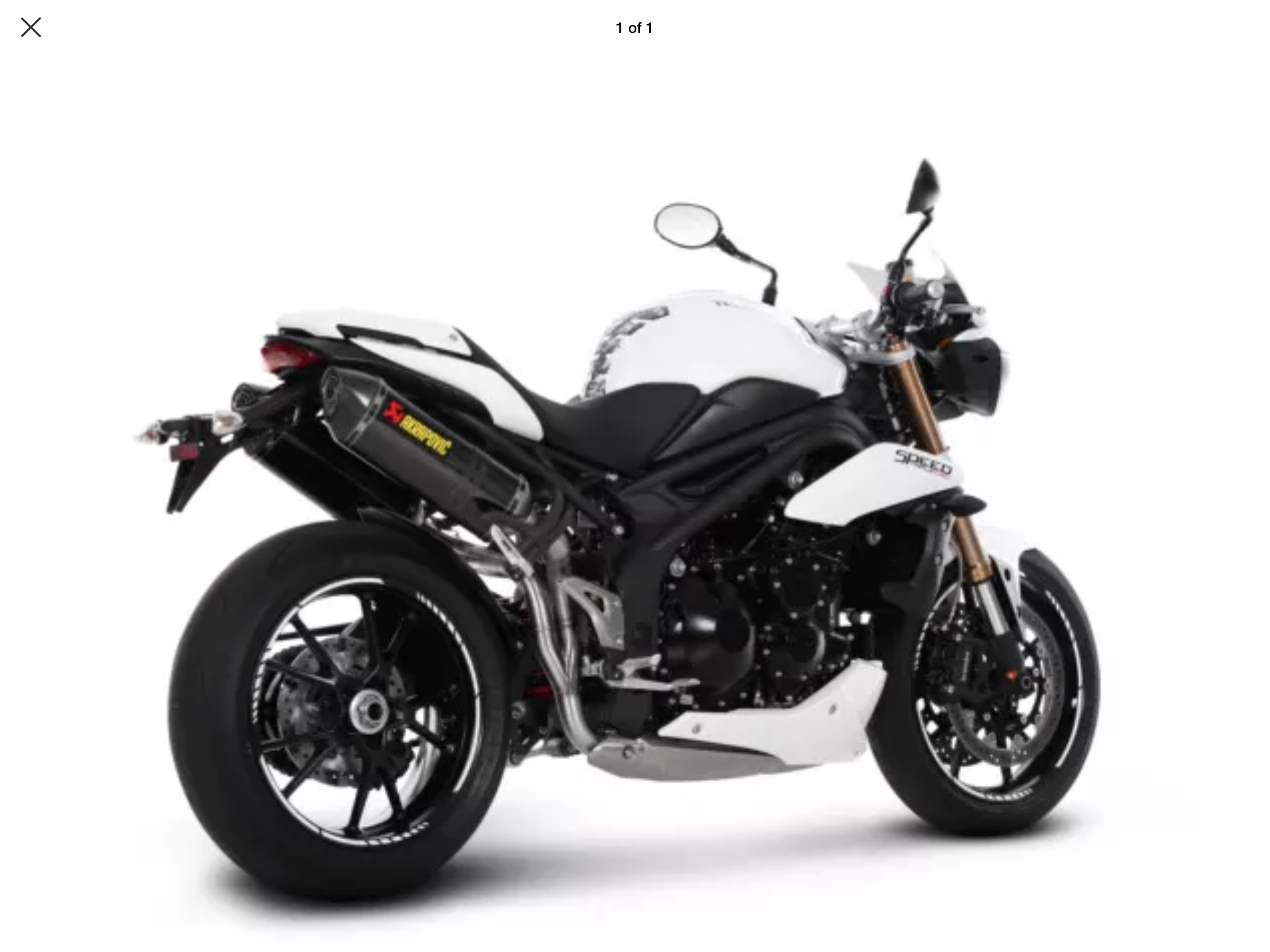

  2. Yorkshireman
    3,403
    264480A9-4DEB-40F1-BD1E-F581285D0821.png Here is a pic from an eBay ad for akras, sadly it doesn’t show the tail tidy but the fit looks very similar to arrows in terms of clearance and I know someone on here has evotech tail tidy and led’s with arrows, I have R&G tail tidy, led’s and arrows and the indicators fit fine on the angle brackets.
  3. Byron
    Byron Well-Known Member
    Apr 30, 2019
    14
    53
    West Sussex
    Many thanks for taking the time Y'Man....I had seen that picture but worried at how long they were.....in the side-on picture they seem to stick out a good inch or two beyond the line of the break light....hopefully I will get a bit more 'Real World' feedback along with yours to get a clearer idea.

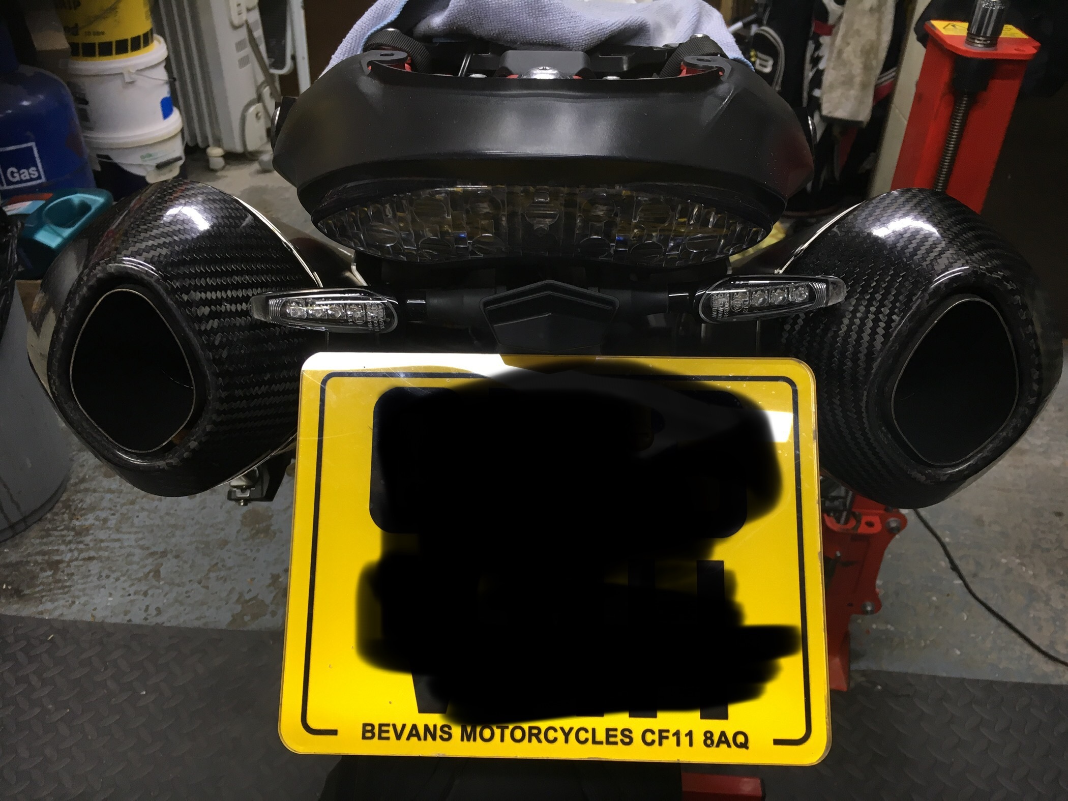

  4. topbanana0
    topbanana0 Well-Known Member
    Mar 27, 2016
    226
    South Wales
    Here are arrows and an Evotec tail tidy.
    The number plate is slightly smaller than standard
  5. Byron
    Apr 30, 2019
    14
    53
    West Sussex
    Cheers for that..
    What gap did you get between the carbon and the lights?
  6. topbanana0
    Mar 27, 2016
    226
    South Wales
    I got about 10mm each side (loads of room :))

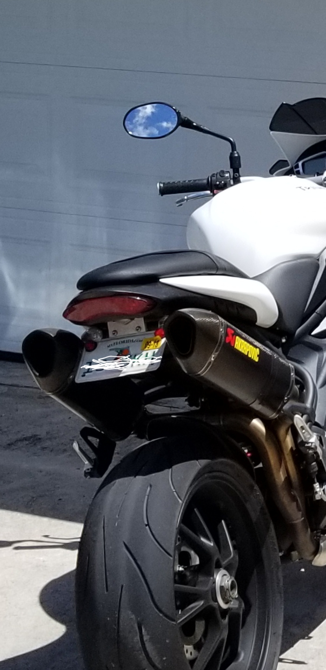

  7. Danimal
    Danimal Well-Known Member
    Sep 9, 2018
    230
    Usa
    I had an angled bracket on my 2011 and it was tight but there was enough clearance, I didn't even have LEDs either which i think are smaller. Don't have the bike anymore and this is the only photo I have of the rear

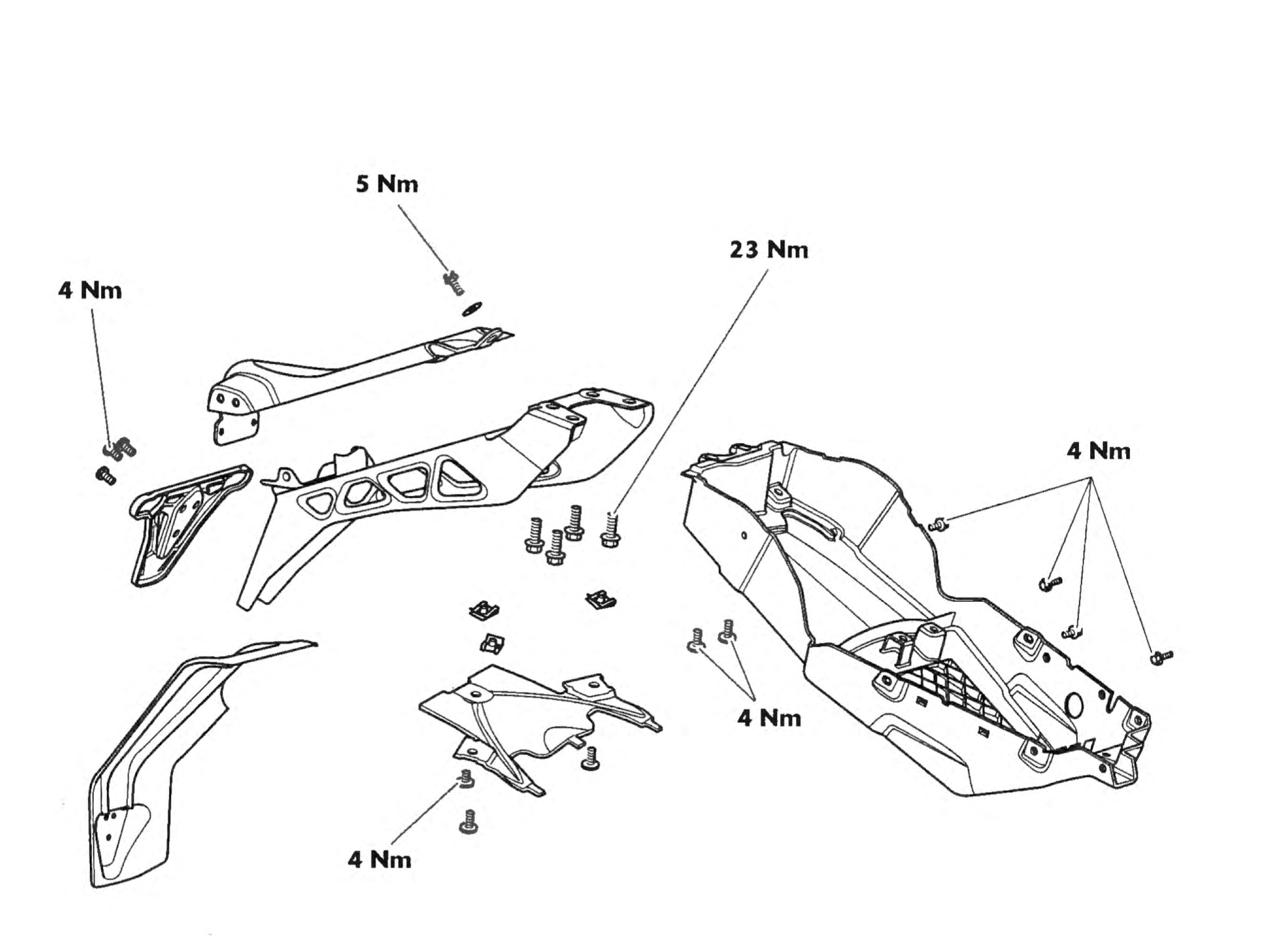

    Having been let down by my local T dealer and an email that never arrived I was wondering if anyone has any info on the torque settings that I'll need for doing a tail tidy and led indicator upgrade on the Speed Triple? Please.... :)
  20. Taz_tasman
    Taz_tasman Member
    Mar 2, 2019
    39
    South Somerset
    Hi Byron, I also have Speed Triple 94 and fitted the tail tidy. I’ve attached the Tq details.
