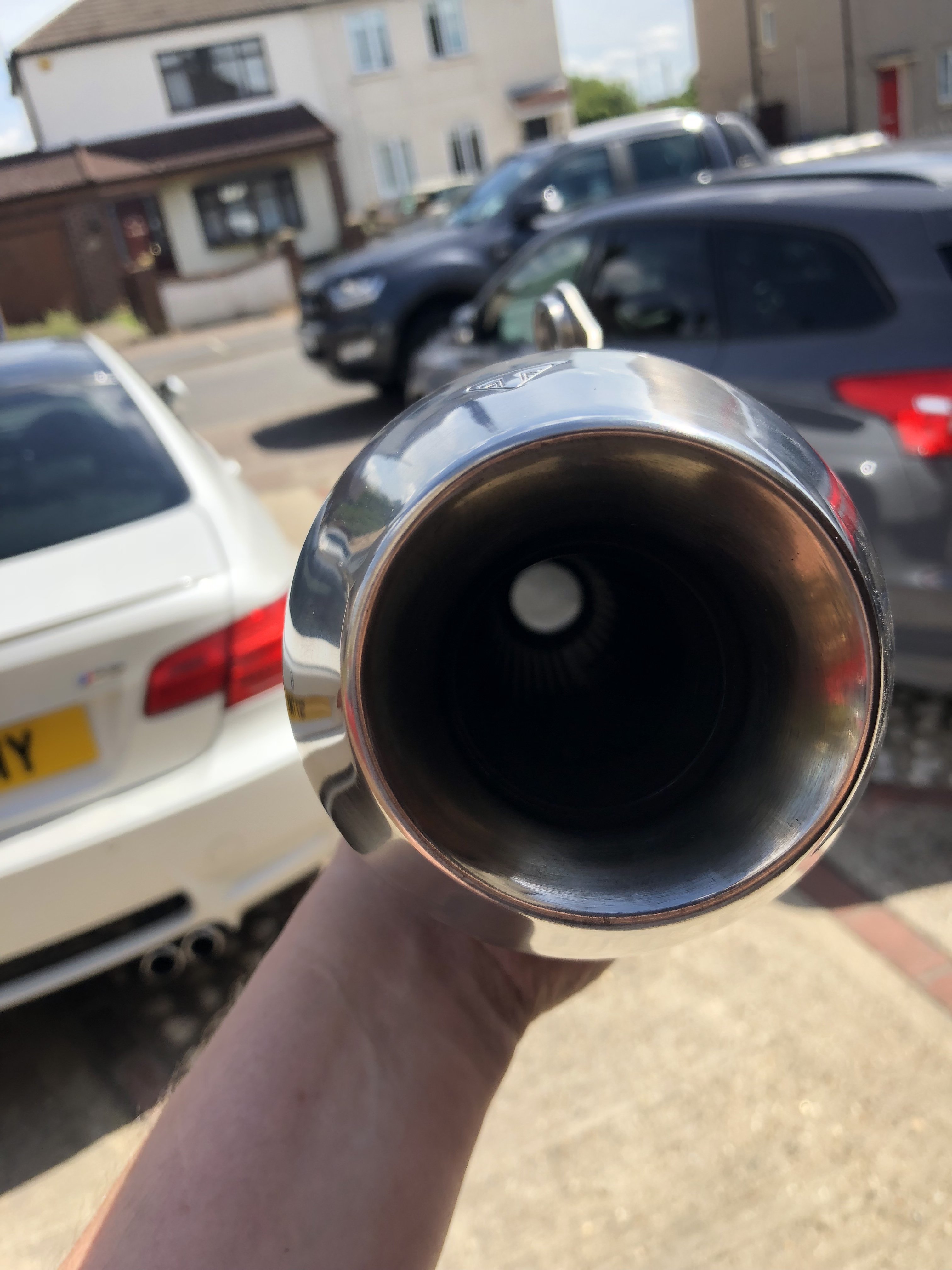

    Thinking that the C-clip with welded spot applies to both US and EU spec V&H slip ons, I decided to remove the baffles from the latter fitted to my Thruxton R, safe in the knowledge that if this modification turned out to be too loud, I could simply refit the baffle and clip to each can.
    It turns out I was wrong as I can't even remove them in the first place; instead of the C-clip with spot weld that I expected to find, I have a restrictive contraption welded in place in at least three places that I can see - and perhaps more that I can't.
    See this photo shot from inside the exhaust pipe looking towards the tail pipe.
    Can any forum member who has done this mod to a 1200 Thruxton with EU V&Hs please share their experience of doing it and subjectively, how loud the end result is?

    I looked at it on my pipes but the baffle looks like it’s assembled before the outer sheath is installed..
    It may be better to bite the bullet and buy an additional set of loud cans.

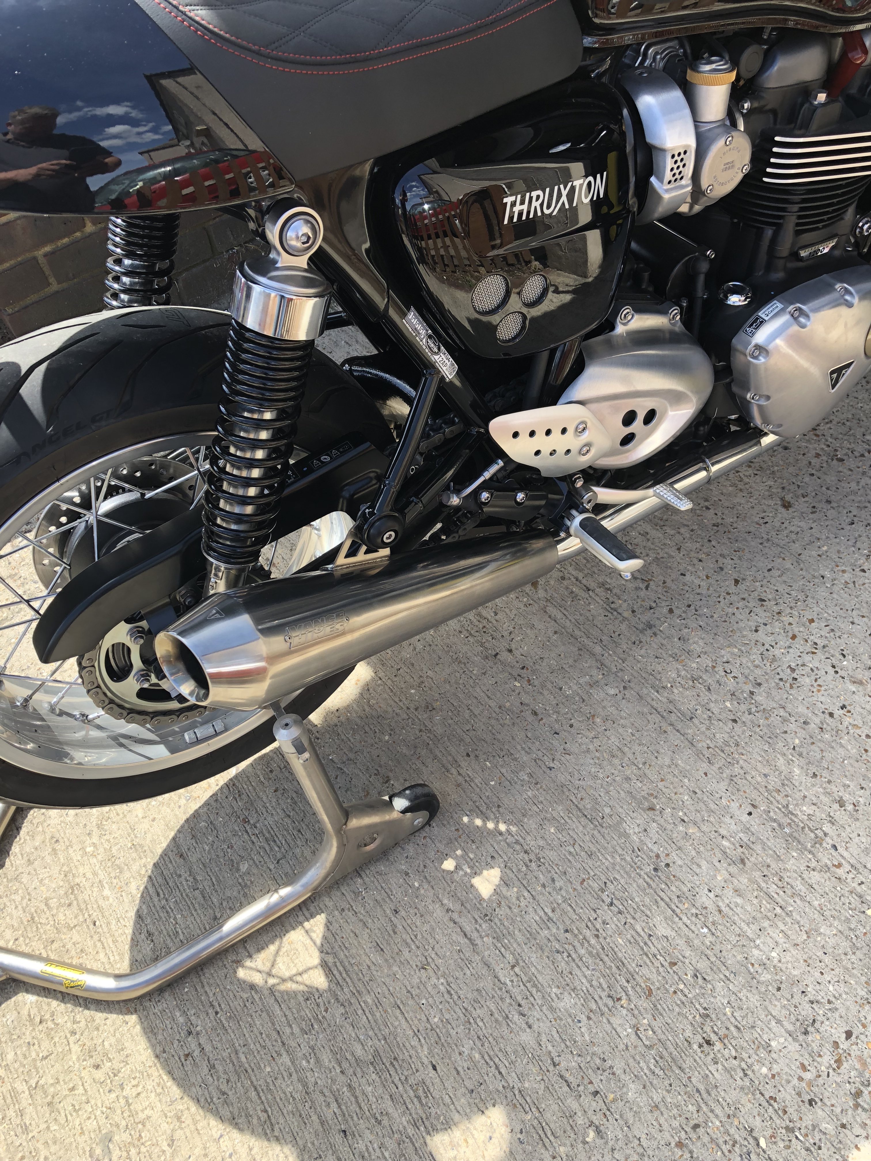

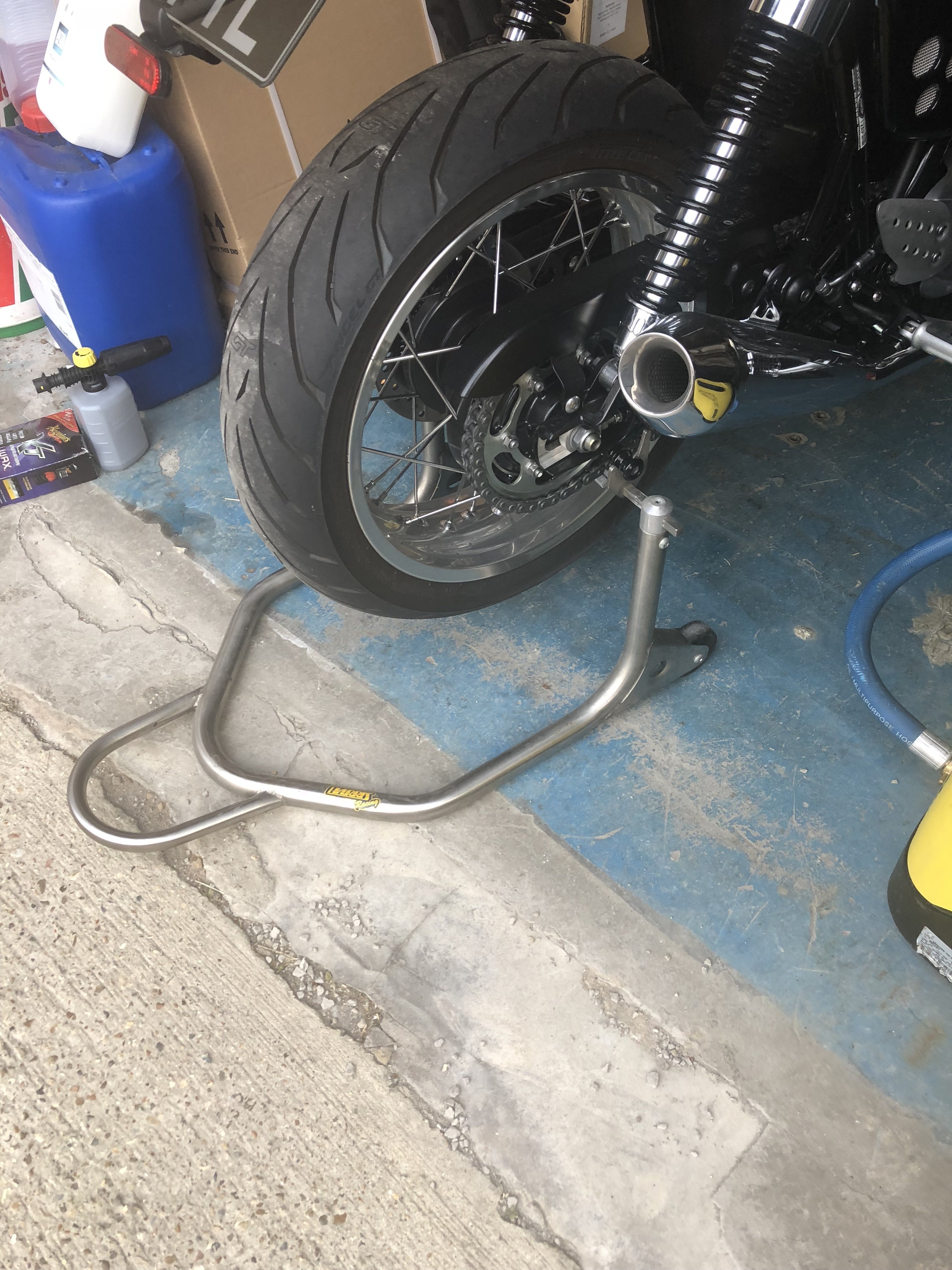

  7. Cafe Racer
    Cafe Racer Member
    May 30, 2018
    47
    BTW Andy - Nice paddock stand! Which one is it, please? I currently use a Oxford Premium Paddock stand but need to modify it because the leverage isn't enough for my wife to lift the bike whilst I hold it vertical; she prefers not to do the holding and I prefer not to routinely try and do the lift by myself even though I can.
    Your paddock stand looks perfect as the amount it lifts the bike is much less than the Oxford stand, and with what seems like a similar length lever, the mechanical advantage will consequently be greater with yours.
    (I've just noticed your stand is on a lift, so hope they are not part of one item!)

  9. Glyn Phillips
    Glyn Phillips Old’N’Slow
    Jun 21, 2018
    967
    I don’t know if this is helpful or not.
    I use Harris stands front and rear, I use both on my own and the leaverage seems about right 95A102FD-7B5F-4FB1-A4C5-2051387D6645.jpeg 76DF59F6-5BF1-4E14-84ED-CFE0B6CF54CE.jpeg

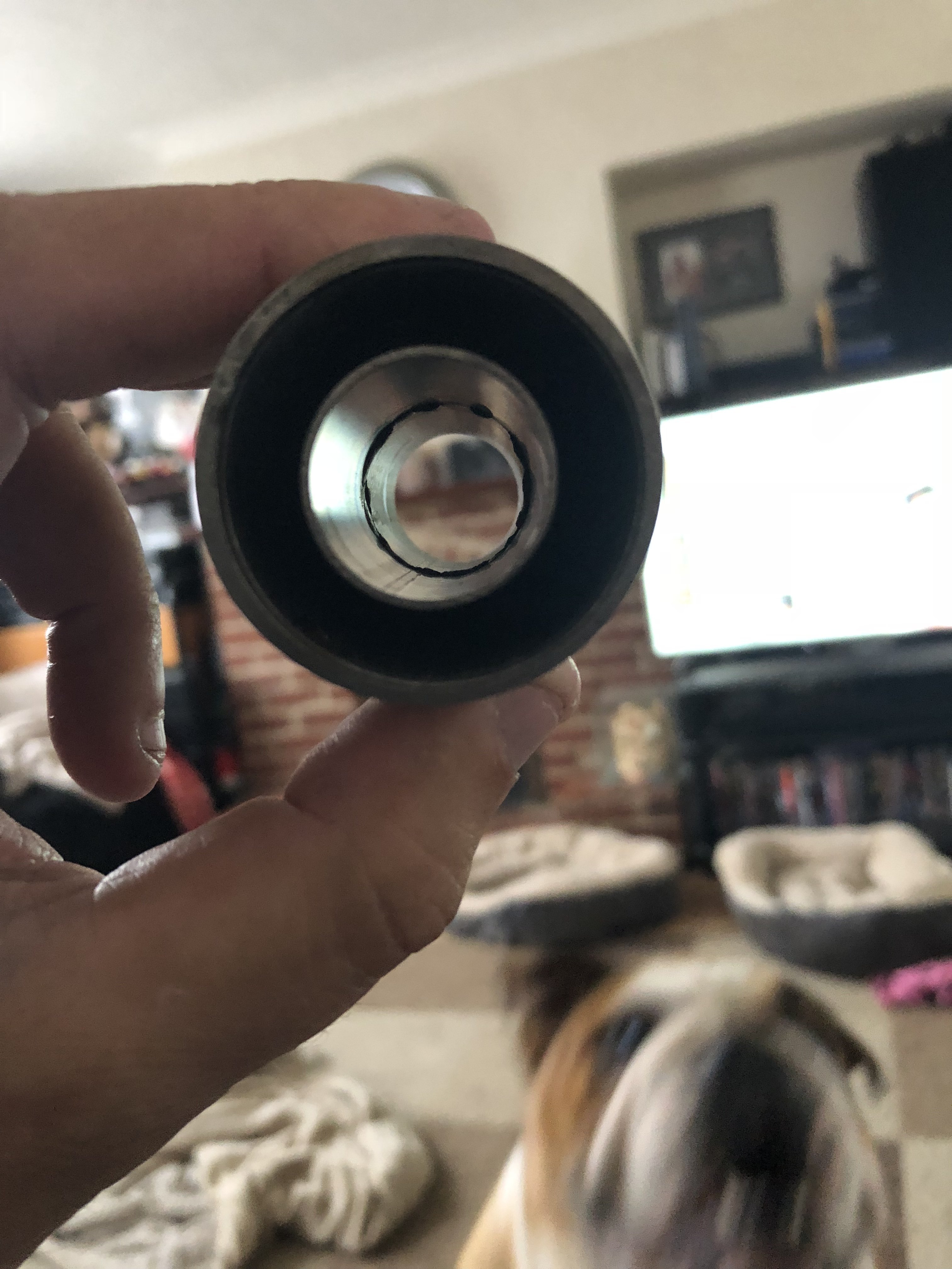

    A local welding shop made my step drill extension today, so this evening I drilled the baffles out to their maximum diameter; they are in fact a long perforated tube, originally with end closest to the exhaust outlet closed, so when this is drilled out the baffle becomes a pipe that is open at both ends.
    I ended up putting the cans back on the bike for the drilling because as the step drill reached an ever larger diameter, so the torque became too much to safely hold. The cans therefore need to come back off for me to clean the swarf out - and whilst I'm at it I will polish the cut ends of the baffle tube, but see the embedded image to understand what I described above.
