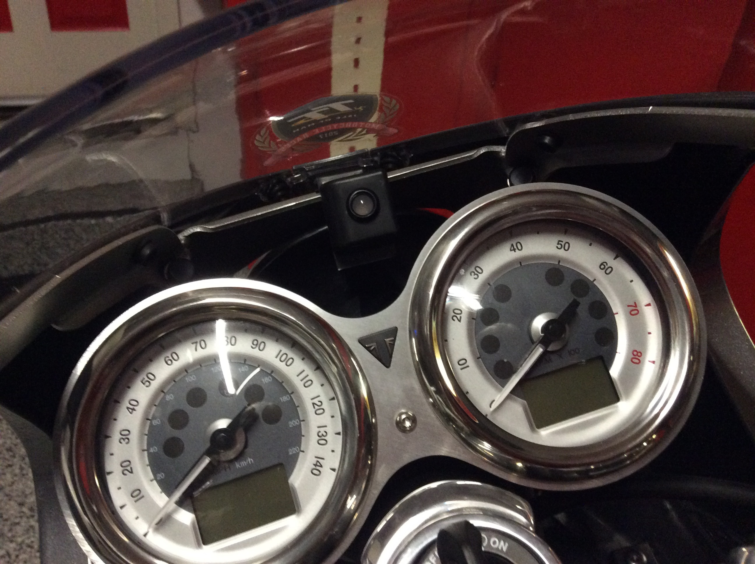

    Just a side note. I like to know approximate state of my battery when she’s sitting in the garage. I bought one of these little beauty’s. Simple install, led that uses almost no juice. Works a treat. And, it’s manufactured and sold on your side of the pond. http://gammatronixltd.com/GAMMATRONIX-12v-LED-Battery-level-/Charge-monitor-E

    Sorry to hijack this thread again but to address your concern. I had one of those plastic shrouds that covers the positive posts on a car battery and said hummm. Cut a little here and there and drilled a hole for the light. Used Velcro to attach to the shelf below the screen on my TTR and voila.

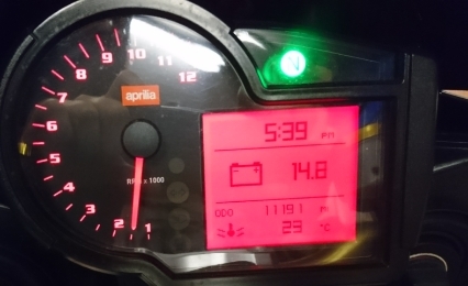

    DSC_0730.jpg My Tuono has a battery voltage display.
    Just saying. :cool:
