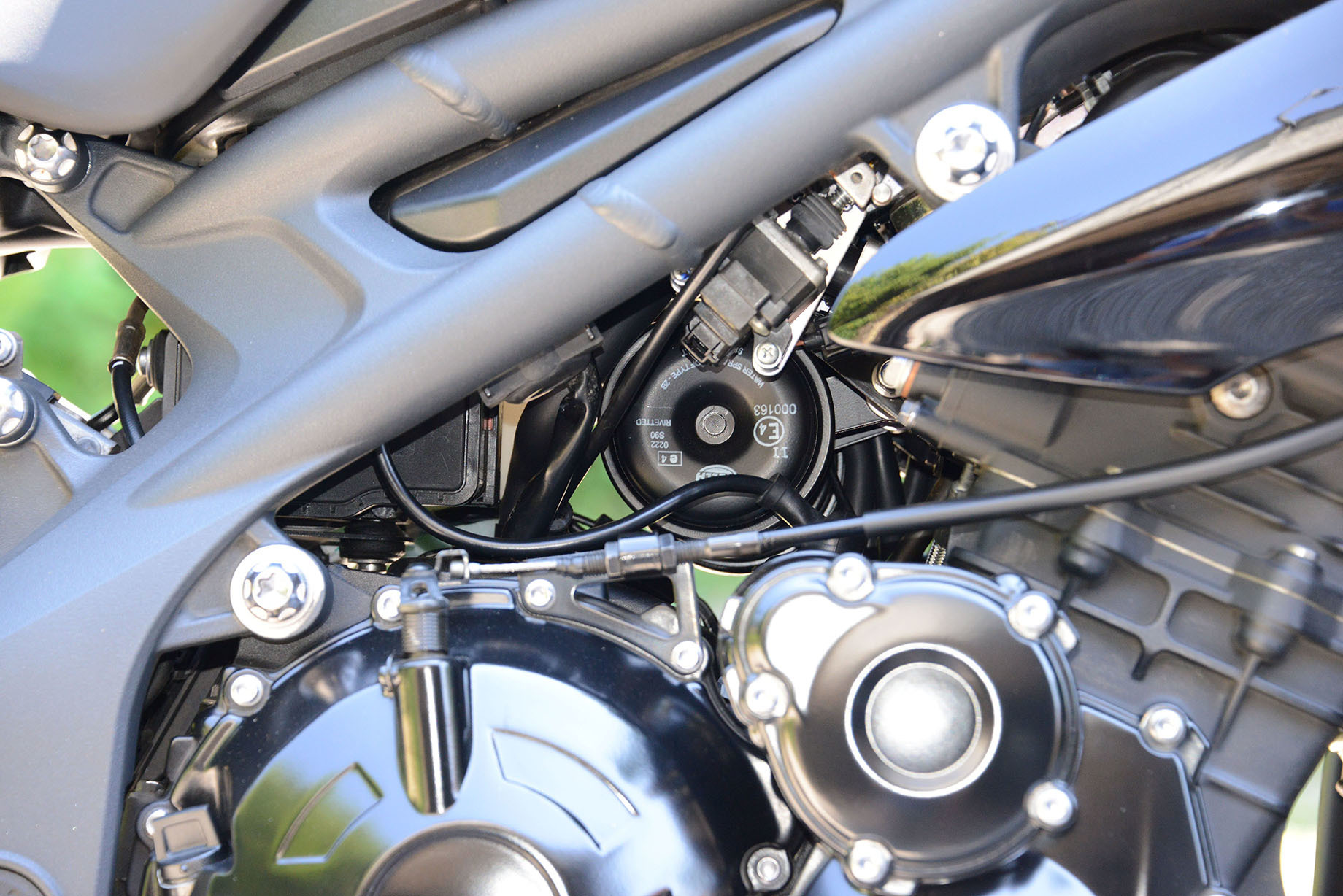

    I did this a while ago now but have only just got around to documenting for anyone else who might want a tidied horn location.
    From day 1 of getting my Speed Triple I always felt the factory horn location looked like a bit of an after thought. Add to this the experience of horns going very rusty and unsightly in a short time (honestly what do they make these things out of, old baked bin tins!) I've been looking for a better location.
    An old Bandit I had I was able to move the horn to under the tank for a very tidy install. Having checked under the Speed tank and removing the battery and tray there simply isn't room.

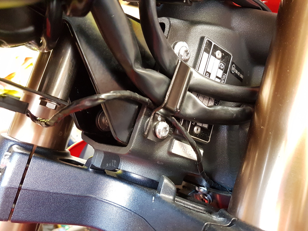

    After some head scratching a thought occurred. "How about mounting under the headlight frame as many sportsbikes do?" A quick check up there and it seems someone at Triumph thought of this too as there is an M6 threaded hole ready and waiting. Excellent! So that is now where my horn sits out of sight.
    For anyone else looking to do this you will need the following:
    65mm M6 bolt (http://m.ebay.co.uk/itm/M6-6mm-A2-S...6306531?varId=630139365101&txnId=850337941023)
    50mm M6 spacer (http://m.ebay.co.uk/itm/M6-Clearenc...334863?varId=541041808779&txnId=1393914435014)
    1. Remove the left-hand panel by the radiator.
    2. The wiring for the horn is wrapped with the left indicator, you'll need to remove the electrical tape as far back as you can. (I took it back to where the wires came into contact with the frame.)
    3. Rewrap the wires so the horn and indicator are separate.
    4. Feed the horn wires over the radiator and up to under the headlight. [​IMG]
    5. If you haven't already done so, remove the horn from its factory mount. Save the washer we'll use this again.
    6. Pass your new bolt through the horn, washer and spacer and bolt into the hole just behind the headlight clamp. [​IMG]
    7. Reconnect the horn and give it a test.
    8. And you're done. Congratulate yourself with a beer or your preferred beverage.
    I hope that all makes sense.

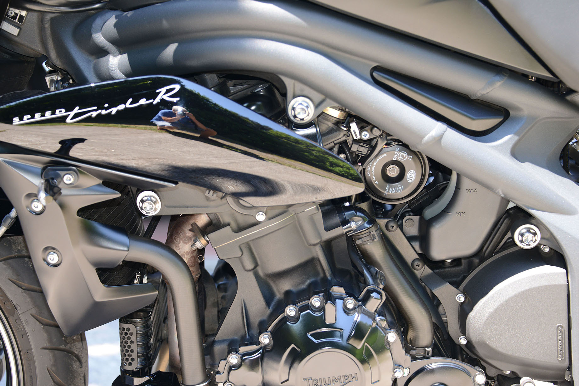

    I've got a 2018 Speed Triple R and the reg/rec is now mounted under the headlamps. Has anyone found somewhere else to mount the horn out of sight?

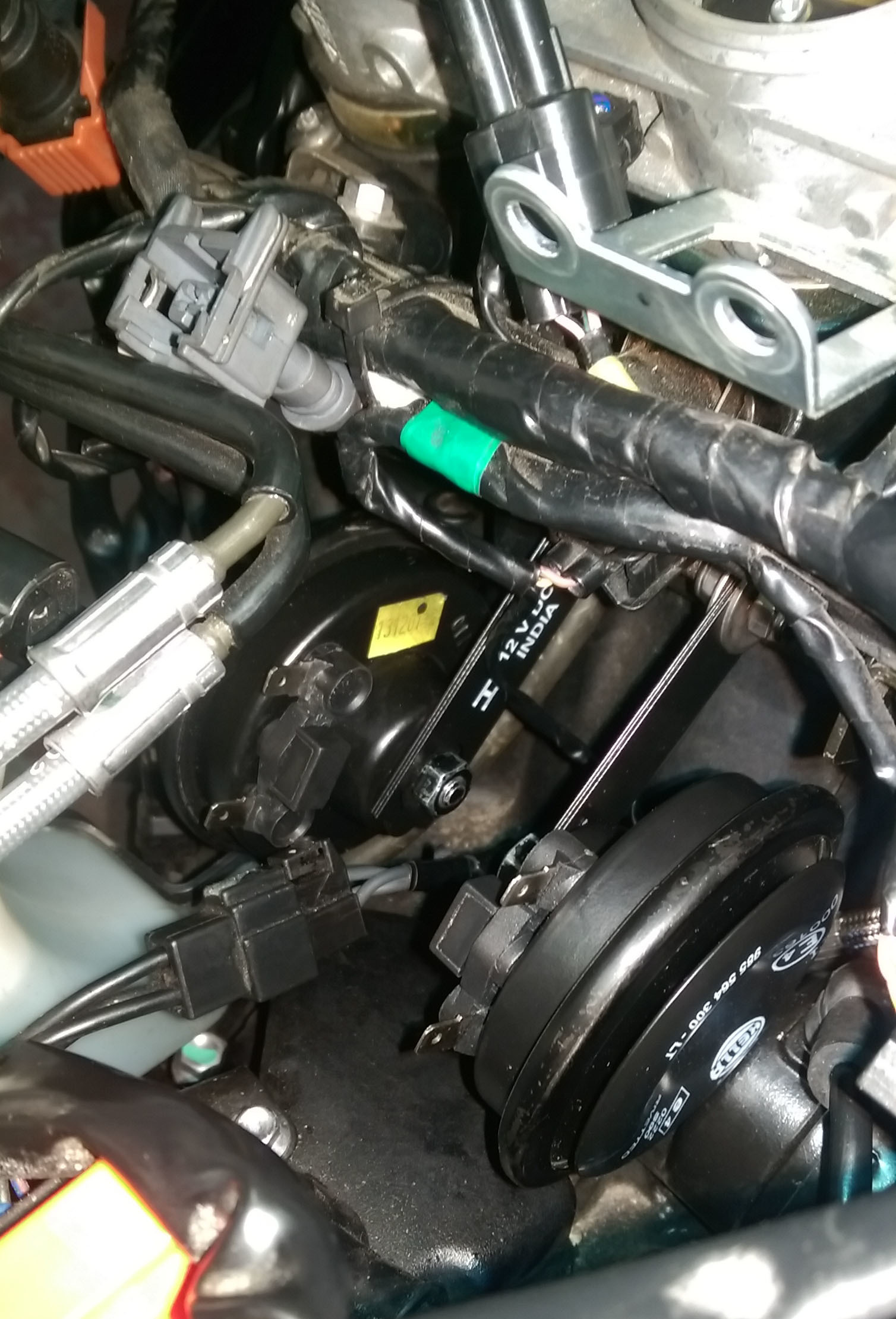

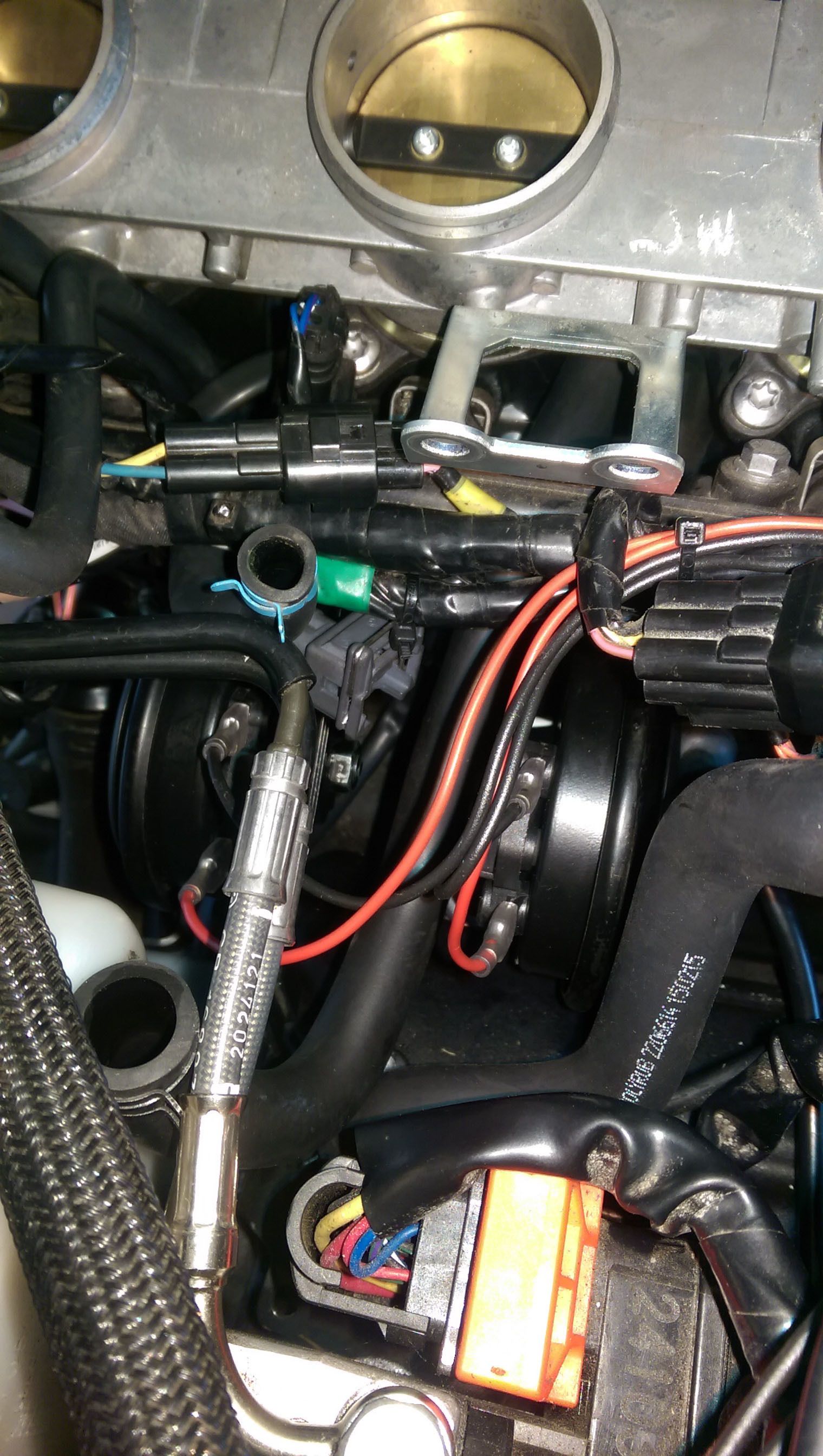

    I got a pair of car horns (slightly bigger and better twin tone sound) and put them here, one facing out each side, not easy to squeeze them in but pleased with the result. I'm guessing it might not be possible with 2016> bikes, bet the space is already used for more electronics?

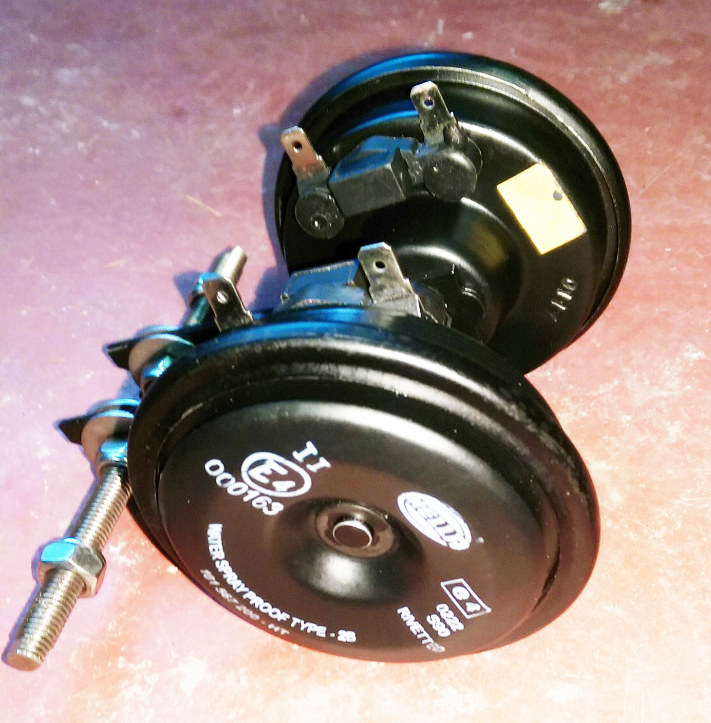

    The horns came with mounting straps already attached with hole at end, assembled them on to a length of M8 studding and that was positioned across the fuel rail support bracket, all clamped up with nuts and washers.
    Warning! - you need the patience of a saint, had to temporarily disconnect a few pipes and cables to gain access and still very fiddly to get everything positioned just right for it to work.

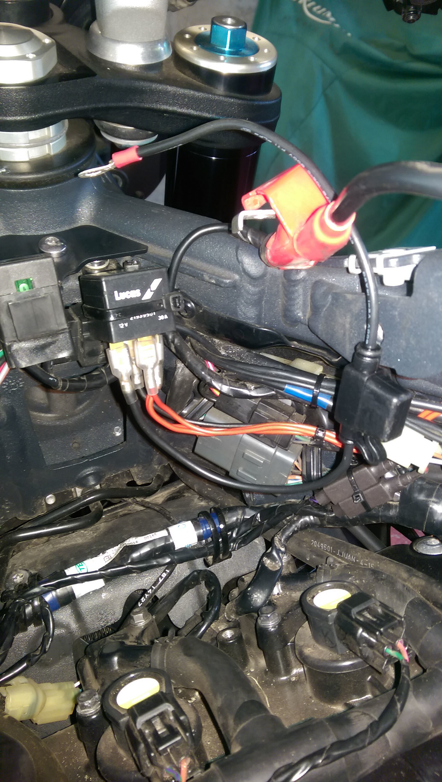

    Put a relay near the battery (twin car horns pull more current than OE bike horn) and wired back to that.
