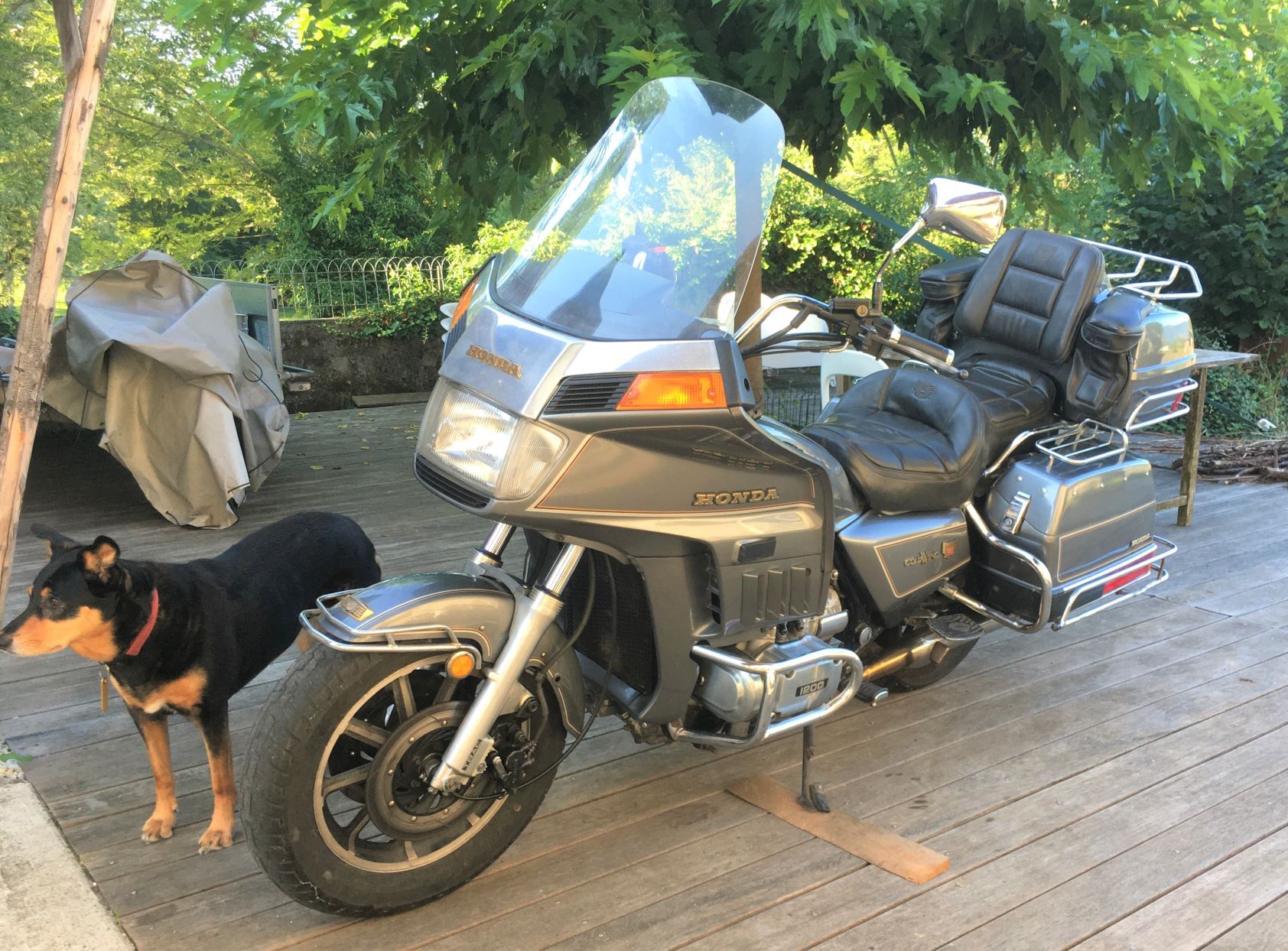

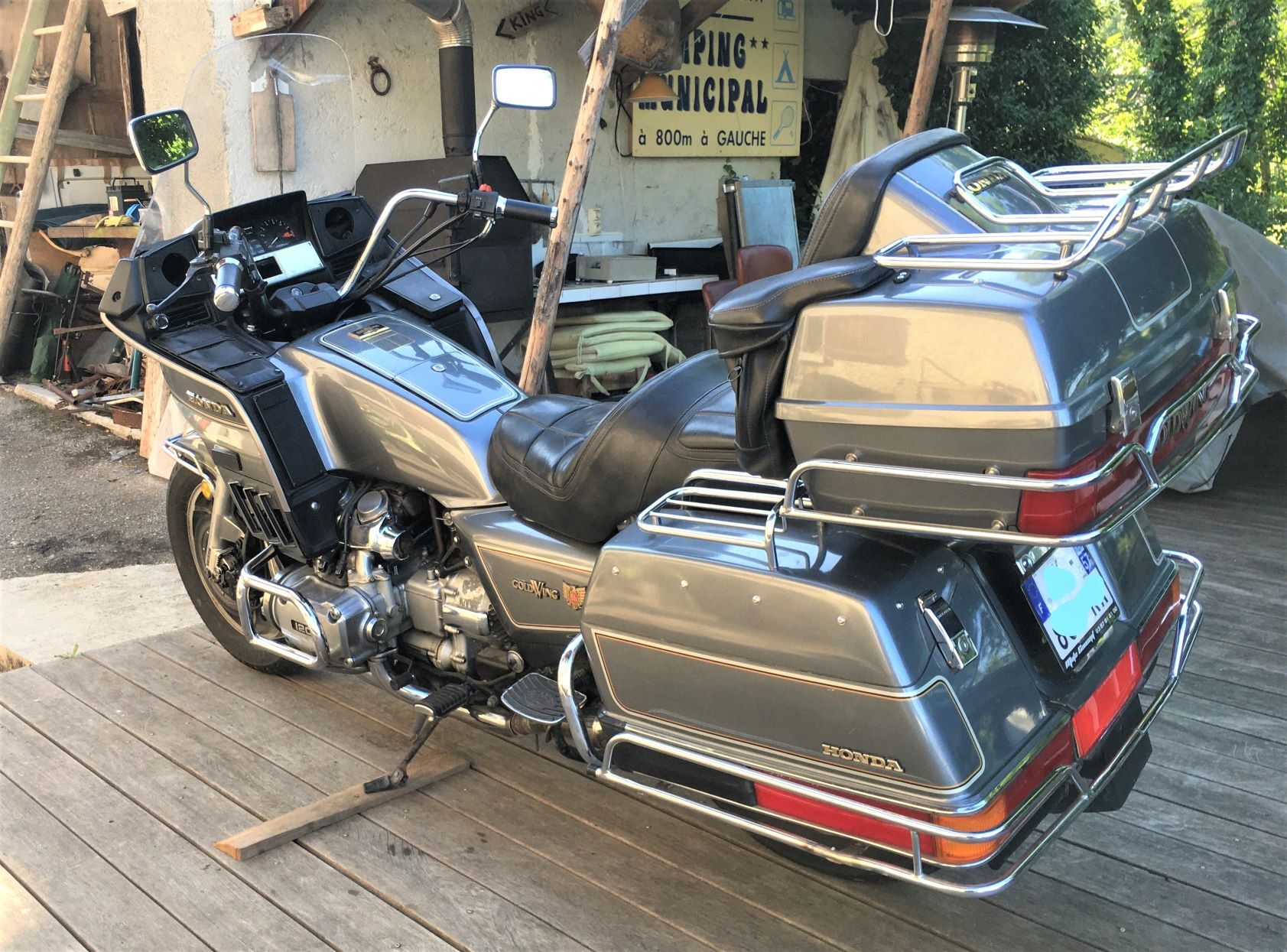

    Some news. I bought a nice cheap 1984 GL1200, with some work to do. Forks need a rebuild, as the history was not clear I also changed the timing belt (30 euros, not something to spare on).
    As I caught the Covid, I spend my time outside working on the bike.
    After rebuilding the forks and do the timing belt, I did a small test run yesterday. The motor failed after a while, and restarted after some time. I also need to bleed the brakes.
    I think I have to rebuild the carburetors too, the air filter was soaked this morning..
    Apart those "normal" issues with a bike that didn't run for years, it's a very nice riding experience. Very easy to ride even in my twisty mountains. I even surprised myself doing some tight hairpin without sweating too much :).
    That's a keeper, it will perfectly match with the Sprint St 1050. I need to sort out the remaining issues, worth case I'll bring ot to the local independent mechanic for a carburetor tuning.
    I know, no picture or it didn't happened.. Here it is:

    Mine was a 1984/5 Aspencade 1200 Goldwing. They are almost bullet proof. Looks in good condition. Nice
