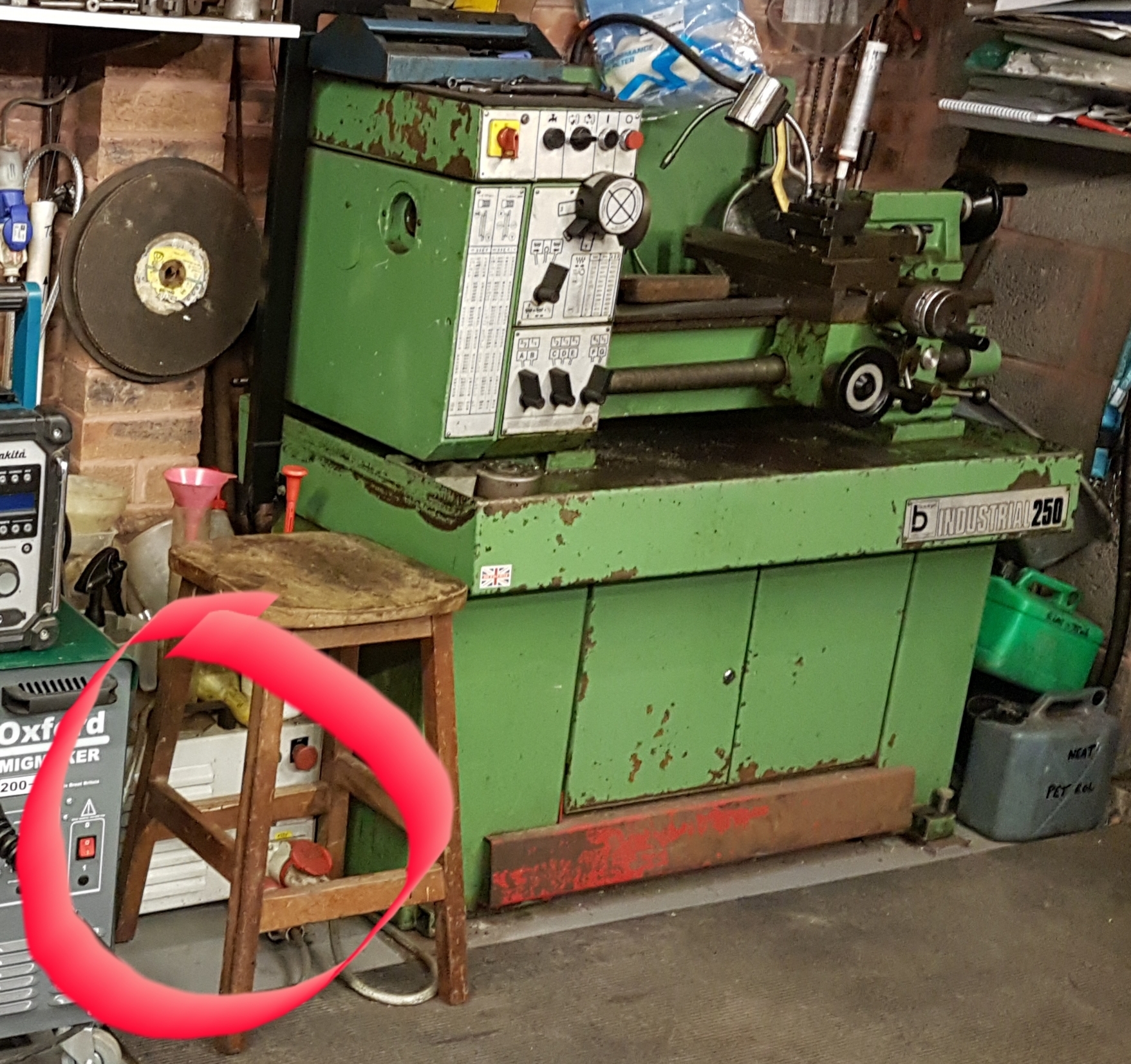

    Something else for you guys to think about is how do you want to power this thing?
    If single phase then you will pay a premium for what can be an inferior product.
    Three phase opens a whole can of worms, inverters, static and rotary phase convertors all add to the experience (expense) if you're in a domestic property!
    Who mentioned business rates if you have 3ph installed in your garage? :dizzy:
    One of the best routes in my mind is to go for a rotary phase converter. The principle is that a motor and a generator is basically the same thing it just depends on which end of the equation its on; driven or driving.
    For a reasonable good one you could be looking at a further £500 plus like mine (circled in picture). Naturally they have a rating and if I remember rightly mines rated to 3hp.
    Mine runs a 3ph saw (Mec Brown) and by pulling the plug and sticking the lathe plug in we're off.
    Don't consider any 3ph welding gear as the electrical inrush requires a phase convertor of x10 capacity. I had a lovely square wave AC Tig set but sadly couldn't economically power it up in my current set so had to let it go.
    At one point I had x4 lathes in my workshop and they would have been ideal for you guys, think Churchill Cub and Boxford AUD etc. but that was a few years ago.
