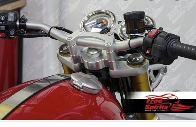

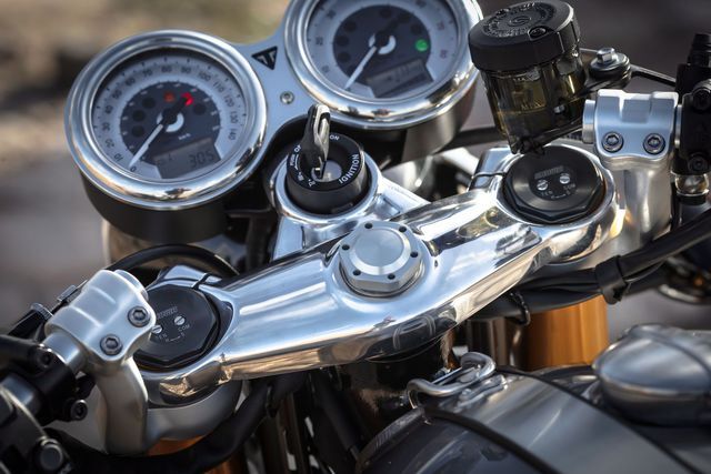

    Hi!
    I was talking about these:
    They are the standard ones on the Thruxton when she is delivered WITHOUT the fairing.
    But I have several reports from the forum and a confirmation from my dealer that you can put the fairing on without lowering these!

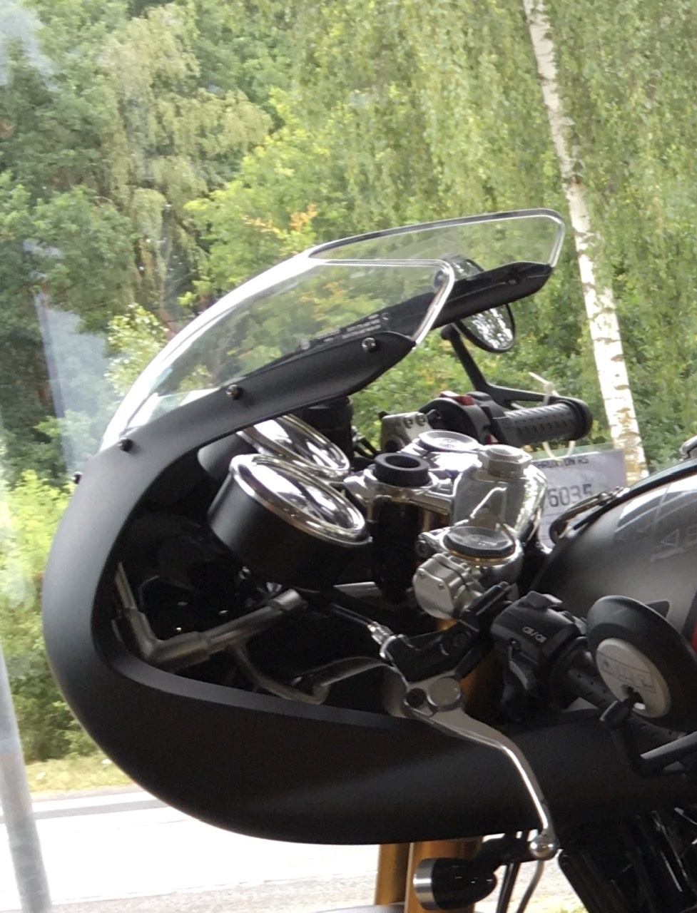

    Mine look like this right now:
    So they are about another 2 inches lower and on the same level as the adjustment screws for the front fork!
    And I am curious about how the standard ones look WITH the fairing. I don’t want to mess up the design... ;)

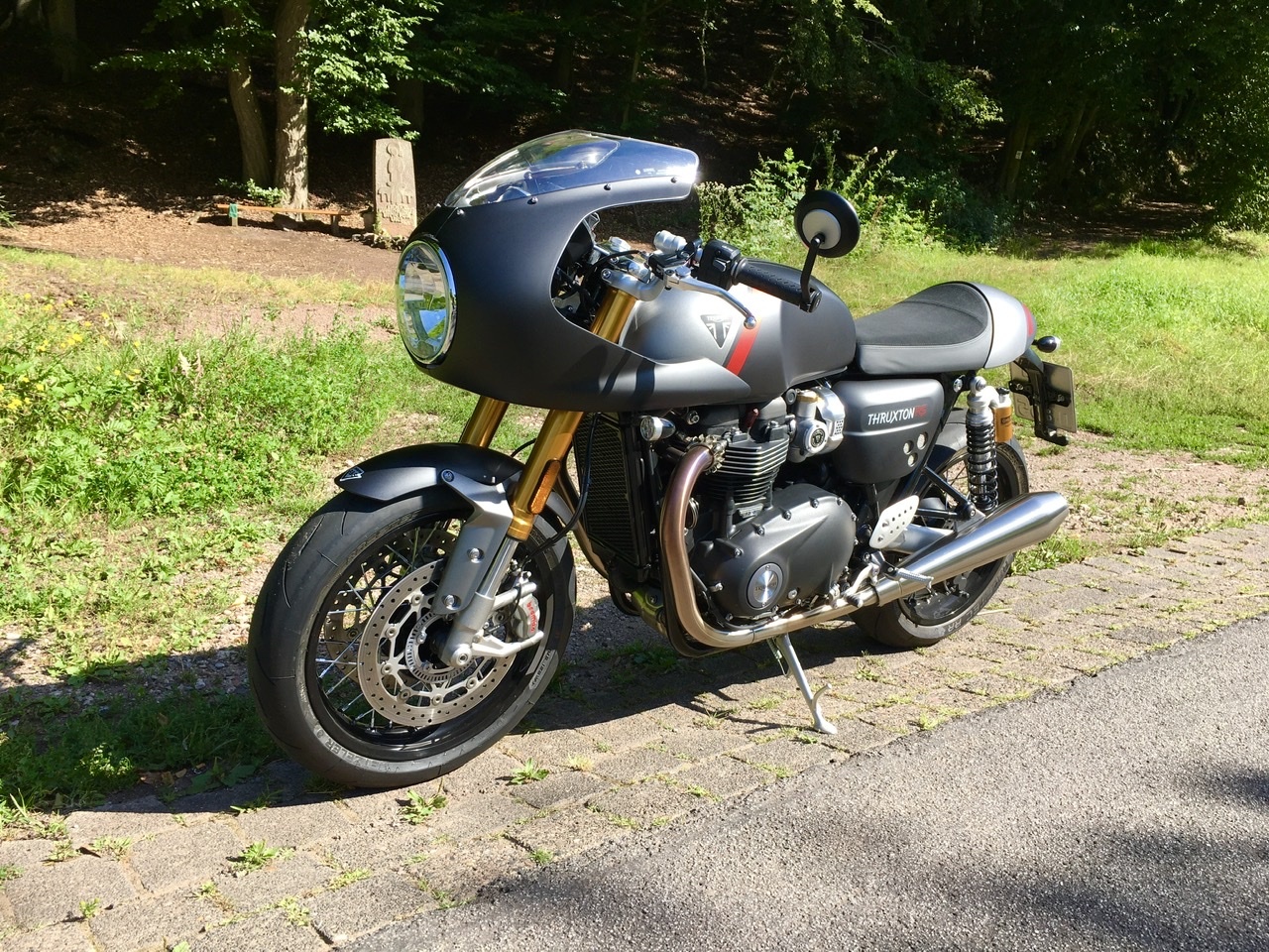

    So I found what I was looking for and I‘d like to share it with anyone, who joined this thread:
    That does not look bad at all, don‘t you think?

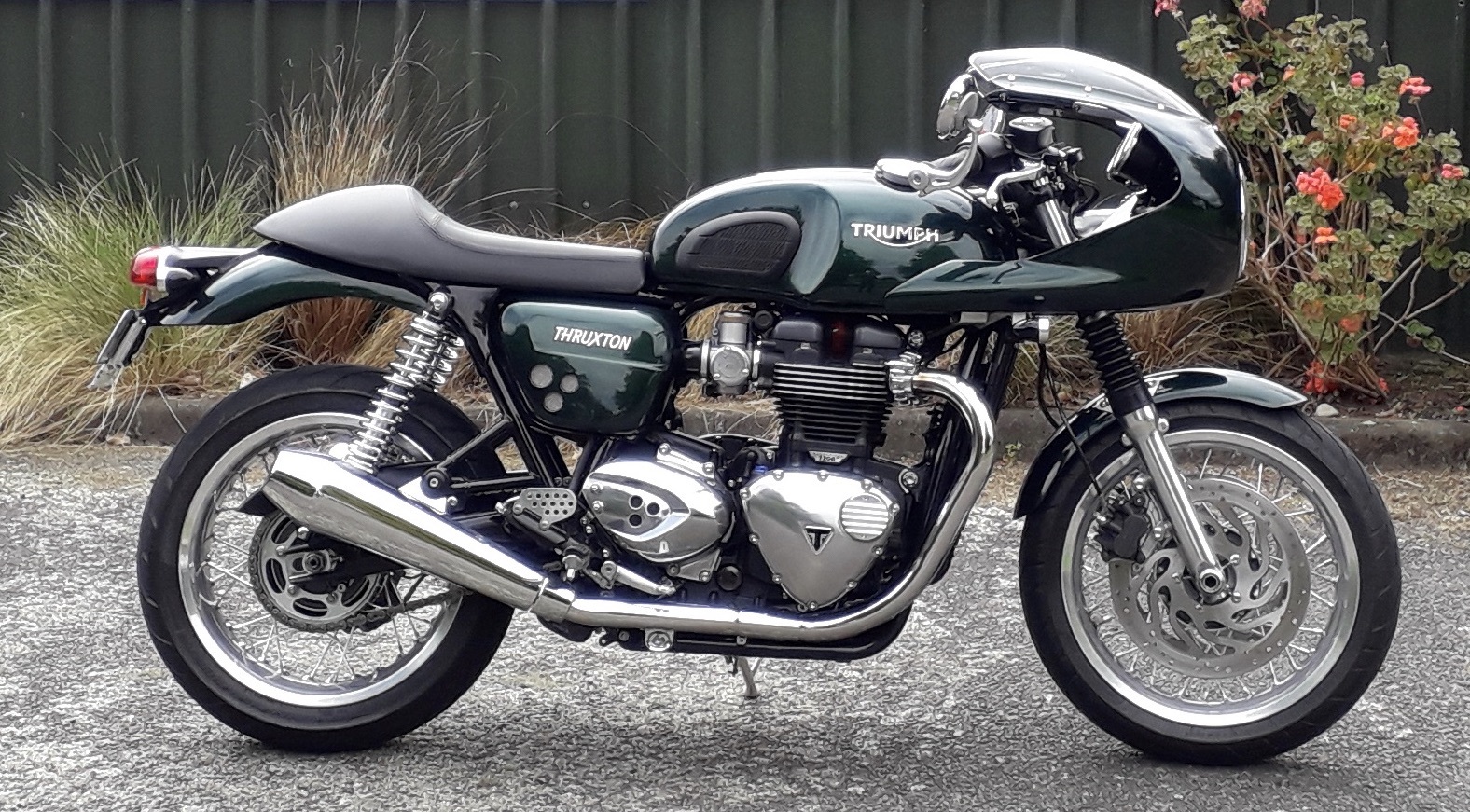

    Not an 'R' but I fitted the standard bars to mine just after I bought it in 2017.

    Great its worked for you. Worth noting that the higher clip-ons are also a bit closer to the rider horizontally, and at a different angle both 'for and aft' and laterally, so there are several factors at play when it comes to comfort.

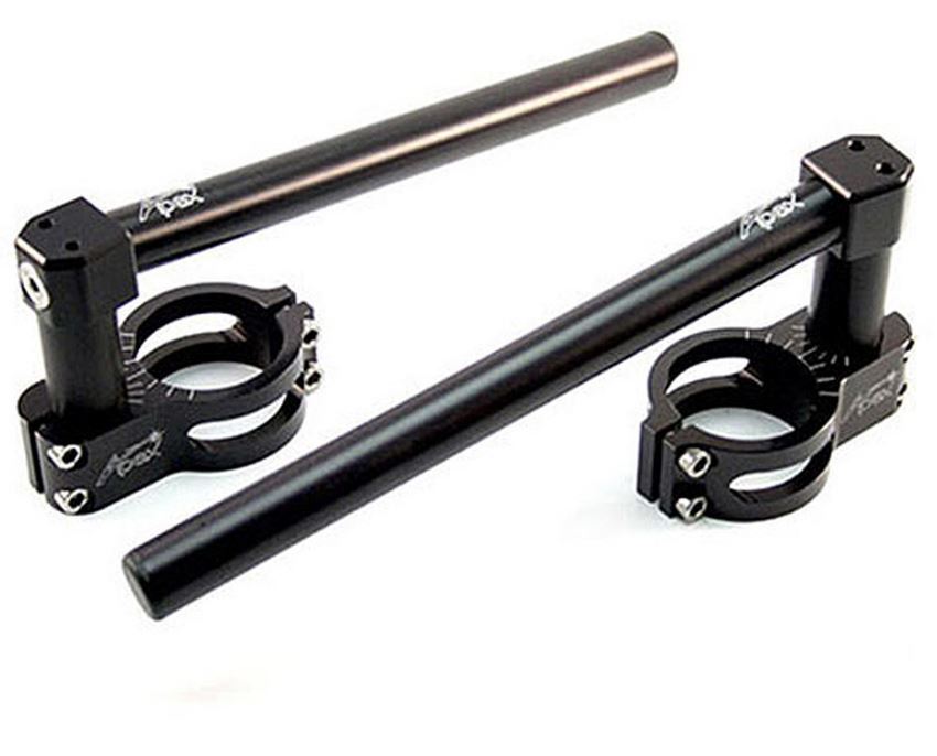

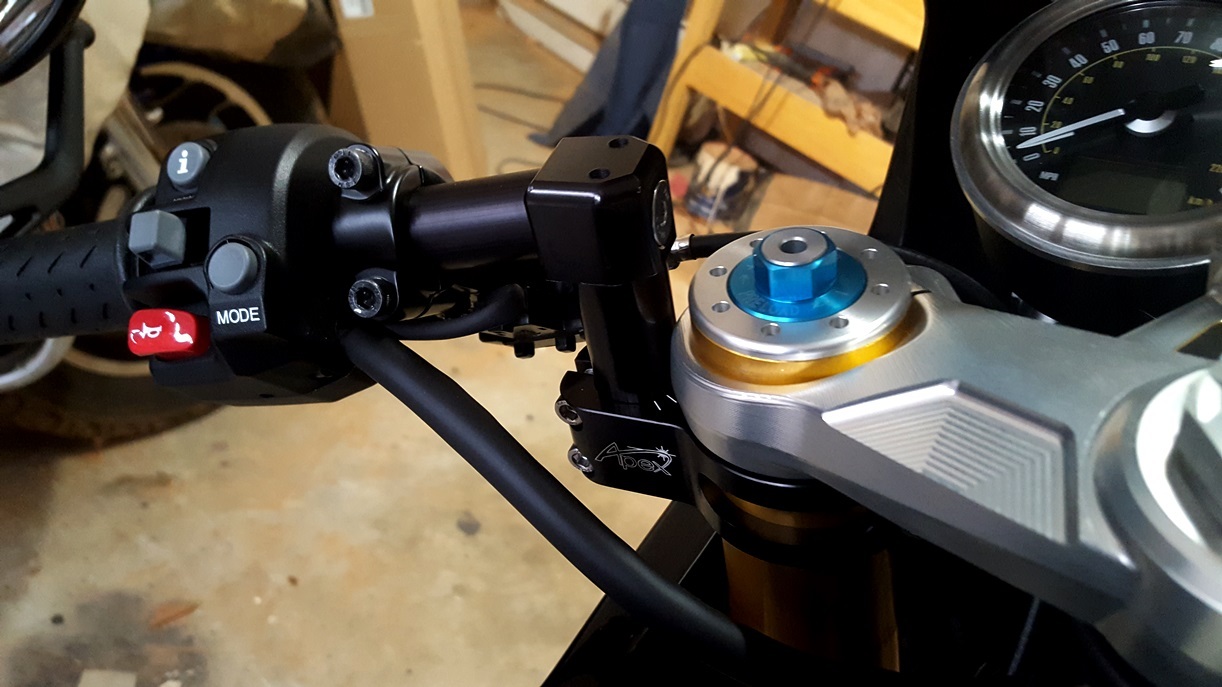

    Apex 3 way adjustable clip-ons with up to 3" rise , stock cables work

    Can you tell me what Apex clamp size you used? I think it's 52 mm but Apex doesn't have a confirmed install for the Thruxton R and other reports conflict. Thanks!

    53mm on the TFC , I believe the Showa's are the same.
