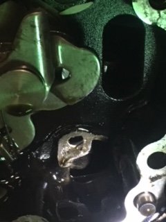

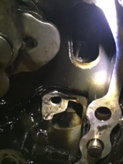

    A piece of the engine case broke off inside. Is there even a way to fix this?

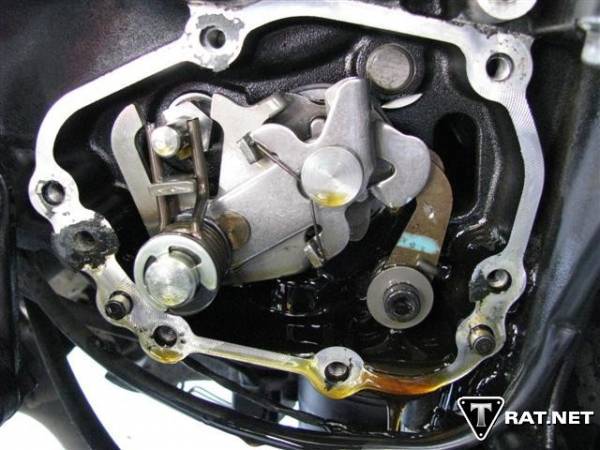

    The damage you are looking at is on the RH side of the engine under the small cover behind the oil level window. The gear selector rod goes right through the casting to the opposite side. It appears to be the lug that supports a pawl that has snapped off.
    It might just be possible to do an epoxy repair but otherwise it is a skilled welding job, a new case or swap out the entire engine. Personally I would go the epoxy route and look for a second hand engine in the expectation a $20 tube of Wurth Epoxy will not hold.....but you could be lucky.

    Either new from a dealer (the $5k CAD route) or from a breaker. The middle route is fleabay in North America or similar where you are looking for a blacked out motor. Bear in mind all the labour costs, unless a useful mechanic yourself, and the replacement motor looks attractive.
    However, if there is enough meat on the broken lug I would get it scrupulously clean and try
    http://www.canadiantire.ca/en/pdp/permatex-cold-weld-metal-epoxy-0383766p.html
    maybe even drilling and pinning with a couple of M3 drill bits much as a dentist uses posts in a crown or big filling. It is worth thirty bucks on materials just trying.
    Once set run a tap to clean up the threads.
    Besides, the aluminium is probably Canadian anyway!

    I suggest you take a deep breath and get it home. You are going to fix it yourself and learn on the job. The broken lug is like a post that supports a sprung detent that rides on an irregular sprocket to ‘fix’ the bike in gear as you shift up and down. The strength of the detent spring will give you an idea of how strong the repair needs to be. Epoxy, done right, can be an extremely strong bond.
    So, get the bike, all the bits and a manual. You’ll want to clean off the mating surfaces - final clean with something like acetone on a fine paintbrush to leave no residue. Work out how you can clamp up while it sets then effect the repair. Reassemble the mechanism and check for operation without closing up the sidecover. If it holds you are dollars in, if it doesn’t you can source a new motor at your leisure. By then you may well decide you can swap it over yourself.......and you probably can....you’ve got the manual!
