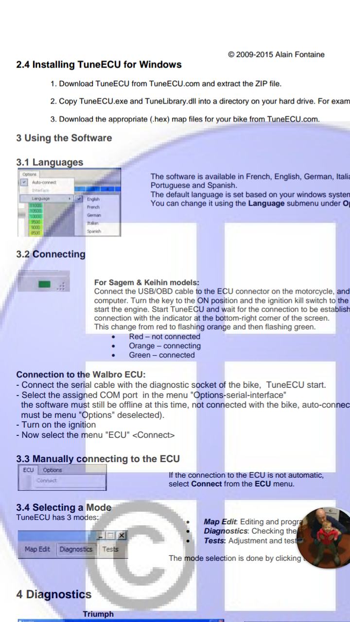

    If tuneboy has TPS reset yes, you need to take following precautions.
    1 hook up battery chargers. Bike & Laptop, in case the download/hook up takes too long !
    2 unplug fuse to headlights see above...
    3 if you have a suitable map installed it GPS will reset automatic on restart
    4. And most important, don't touch throttle on first start up tuneboy hooked up and running. Look for GPS reset light up and then switch off !
    Should be sorted soon then, look @ tuneecu site. Read and get yourself ready!

    The article I read the guy said he took the sensor off and cleaned it.then replaced it.this is a whole new ball game to me.but thanks for the info dude.I 'll order a manual and cable and do sum research. :)

    Yeah that should work for you, GPS was my tablet. Android doing the usual predictive type setting, we were talking TPS weren't we ?

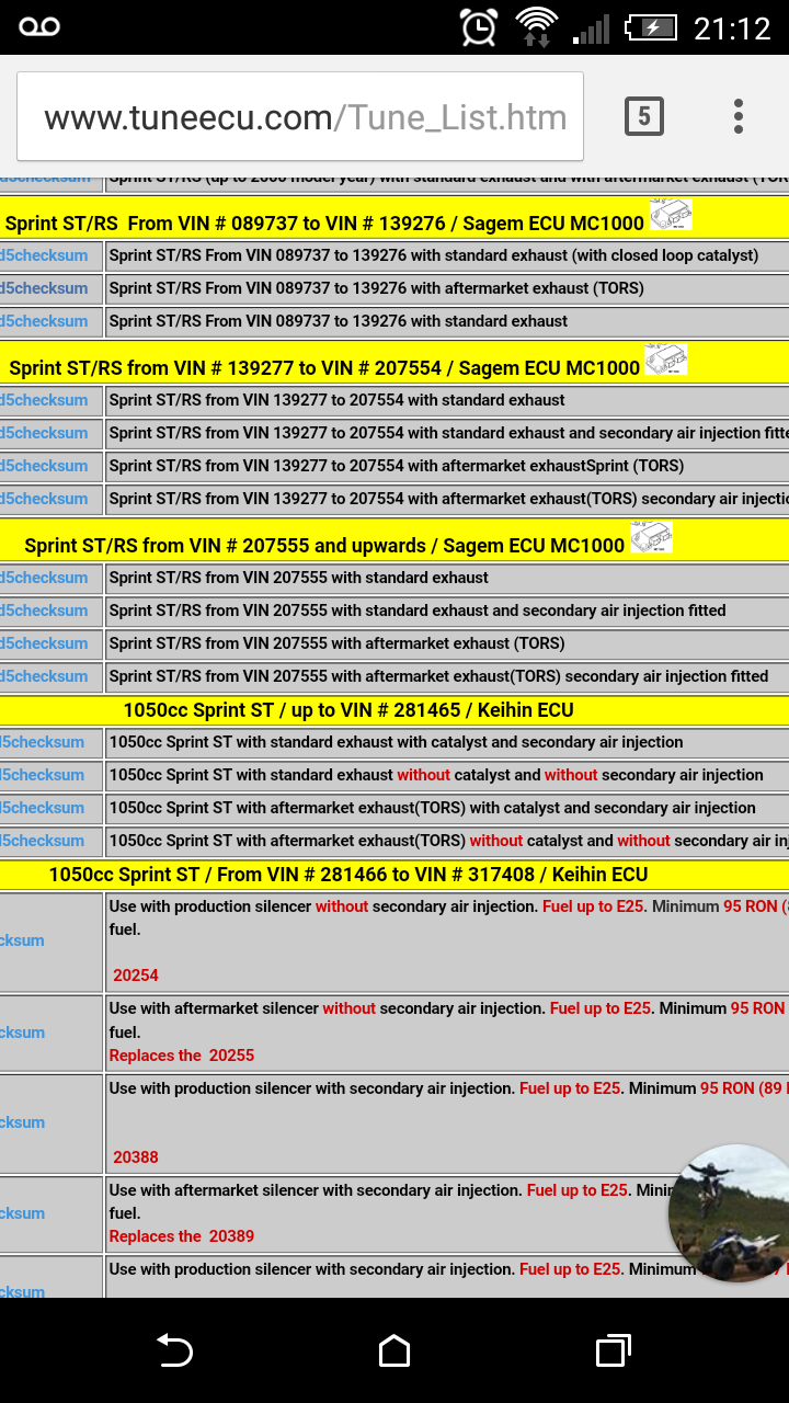

    Any you guys ever set ecu tune up am little bit confused.it says I need install a map to the software there's more than one map :(

    Hi Herbos ,
    Check the Vin number on your bike, look for the map that your vin number falls within, if more than one is listed choose the one that most closely matches your bike, ie pipe or airbox mods, download that one, open tuneecu and then open the map, connect to your bike, compare maps, installed if it has changes.
    Simple really...
    Cheers Mick ( capt).
