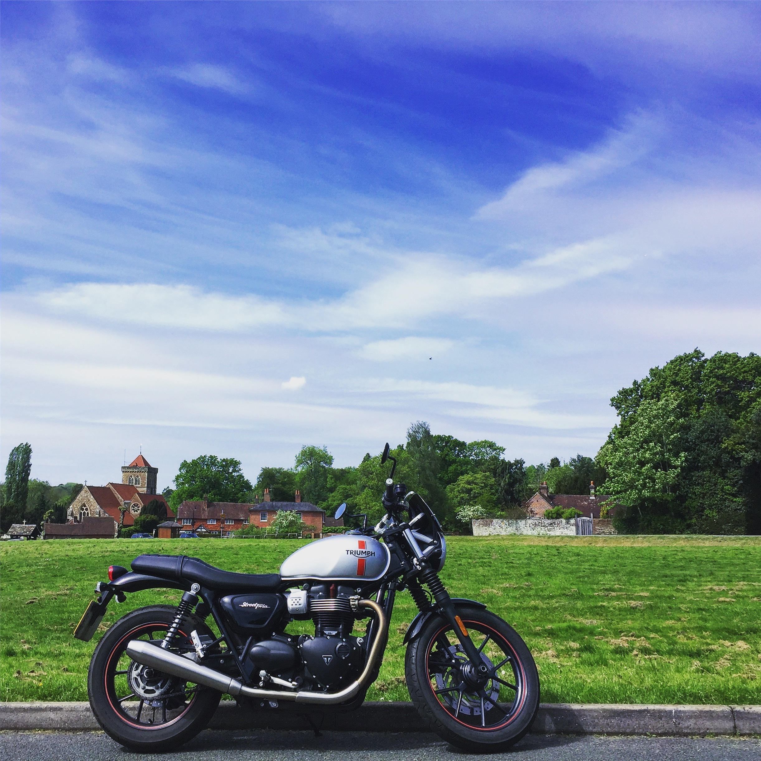

    Quick update, took the ST out for a longer spin this morning and the fuel gauge worked itself out so thanks for the pointers!!!
    The spark plug caps carried on playing up so when I get a chance will pop to Halfords and change them over and hopefully that'll sort all the problems out!
    On a different note...I'd forgotten how nice the ST is to ride, much easier and smoother than my Scrambler!!! Anywho, thanks for all the help chaps!
    I'll update once I've done the caps...here's a pic from the trundle this morning...
