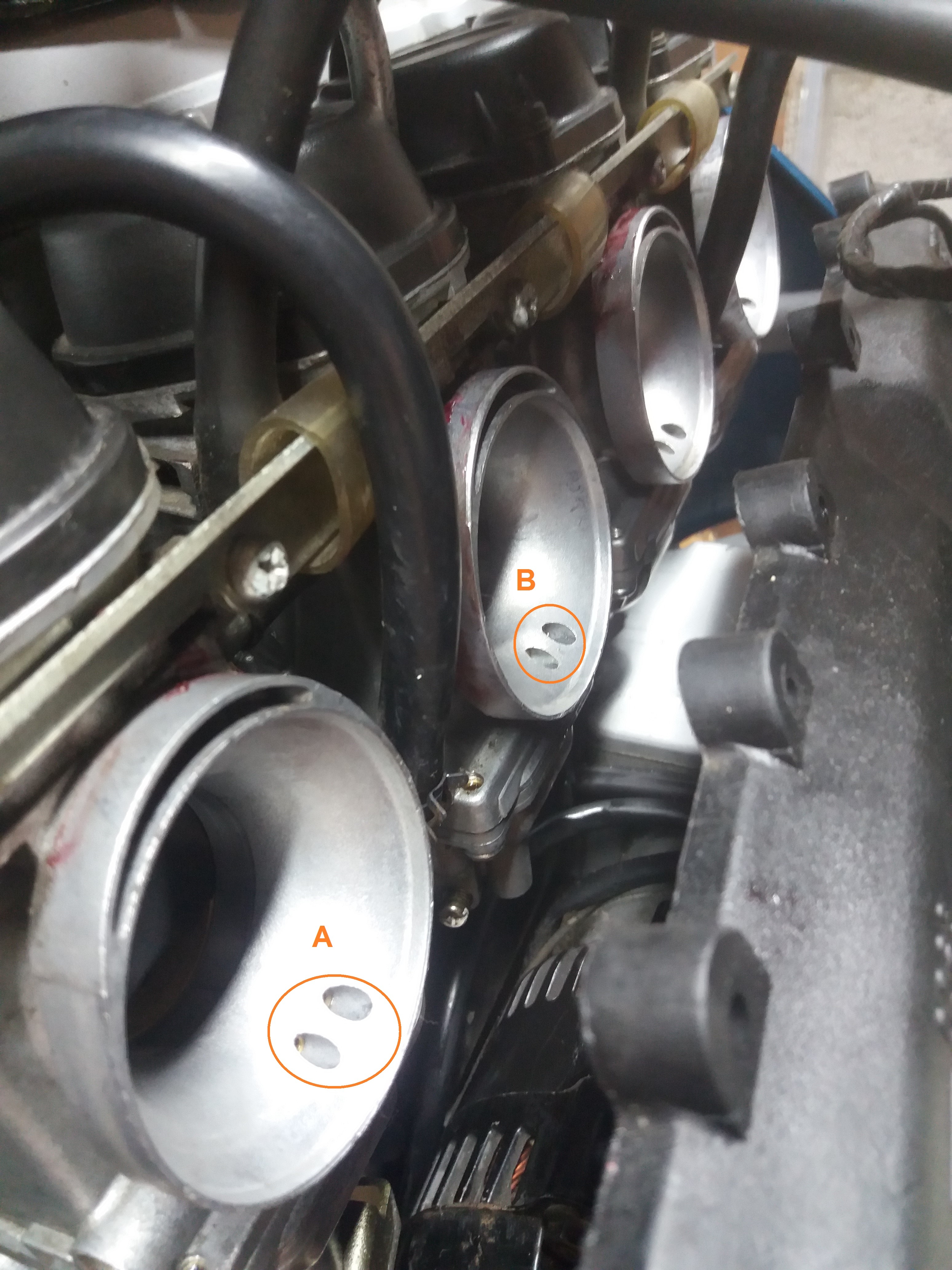

    All four emulsion tubes out and cleaned but to be honest they were clear – looked like new really. Put it back together and got ready to start her up when fuel began appearing from 2 carbs - from points A and B shown on the attached. Turned off the fuel supply and sparked up a fag to help me think....
    This is my latest theory which ties up with the fact that whatever the problem is it is affecting all four carbs.
    The tank is off and I’m supplying the bike with fuel from an old plastic mower petrol tank. This is suspended out of the way just below my garage trusses – say 8 feet high. With the fuel falling so far is gravity forcing the fuel passed the needle valves, over filling all four bowls? With over full bowls the bike will work on the choke but just cuts out with any revs?

    Got the carbs off (getting good at this at least) and back on the bench. The float bowls fill to the correct height and no fuel emerges from points a and b.
    I know that when I fit them back on I will still have the original prob.
    Need to get an adult involved as I have given up. Any recommendations for where to send my carbs?
