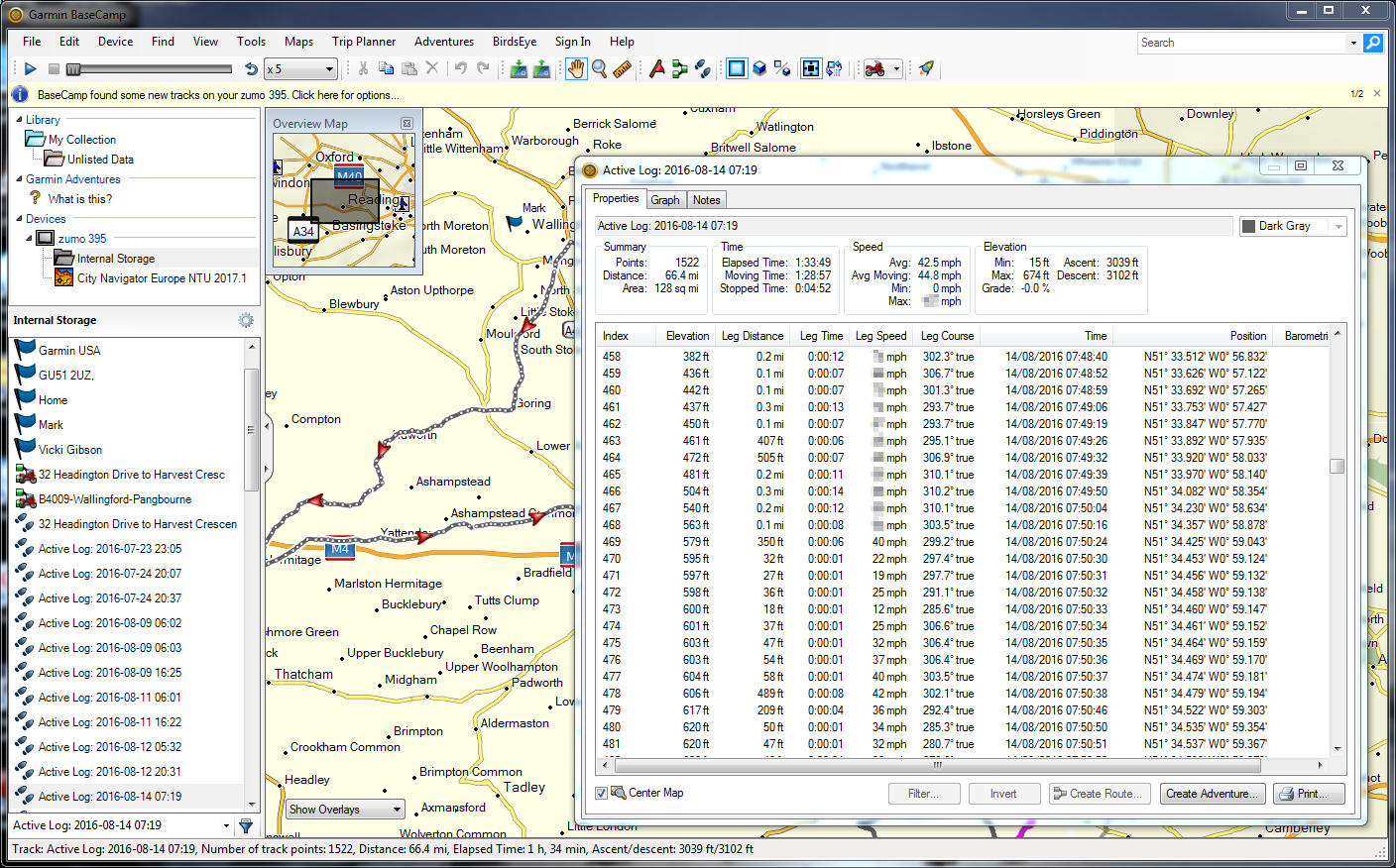

    Something I've found on my Zumo:
    Settings->Device->Clear Travel History
    doesn't actually clear the tracks from the device.
    They don't show up in the Track 'app' on the device's GUI after doing Clear Travel History.
    But if you plug the device into a PC and stoke up BaseCamp, all the tracks are still there, including all the (cough) speeds you'v been doing. Don't know if such info can be used to make a case in court, or used in insurance disputes...
    I've moaned to Garmin about this, and the 'solution' they offered was that I should do a device reset. Which removes all the settings, favourites etc. Not a solution at all IMHO.

    If the zumo's Settings->Device->Travel History tick box is ticked, the zumo records a new track for each new journey.
    Later, you can turn this track into a 'Trip' to ride the route again, or us it for the 'TracBack' feature to ride back the way you've come. Or you can share it with others using BaseCamp (or maybe some other PC software - I don't know...). All if which are good reasons to allow the zumo to record travel history (aka tracks).
    My concern about this isn't that BaseCamp displays this stuff. My concern is that you can't delete it from the zumo itself.
    So if you have an unfortunate incident, someone (maybe Mr Plod, maybe someone else) could grab your zumo, and find out your entire travel history. Where you've been, when, how fast, how fast you were travelling just before the incident, where your empty home is while you're recovering from the incident, where you work, which establishments of ill-repute you visit, etc, etc.
    Here's a screenshot showing the level of detail the zumo records - a small part of which I've obfuscated :)
    BTW, this shows a track on my zumo, that is supposedly deleted. I can't see it using the device's GUI (the Tracks app). But hey, there's the information, still on my zumo, ready for some curious person with a computer to rummage through...
