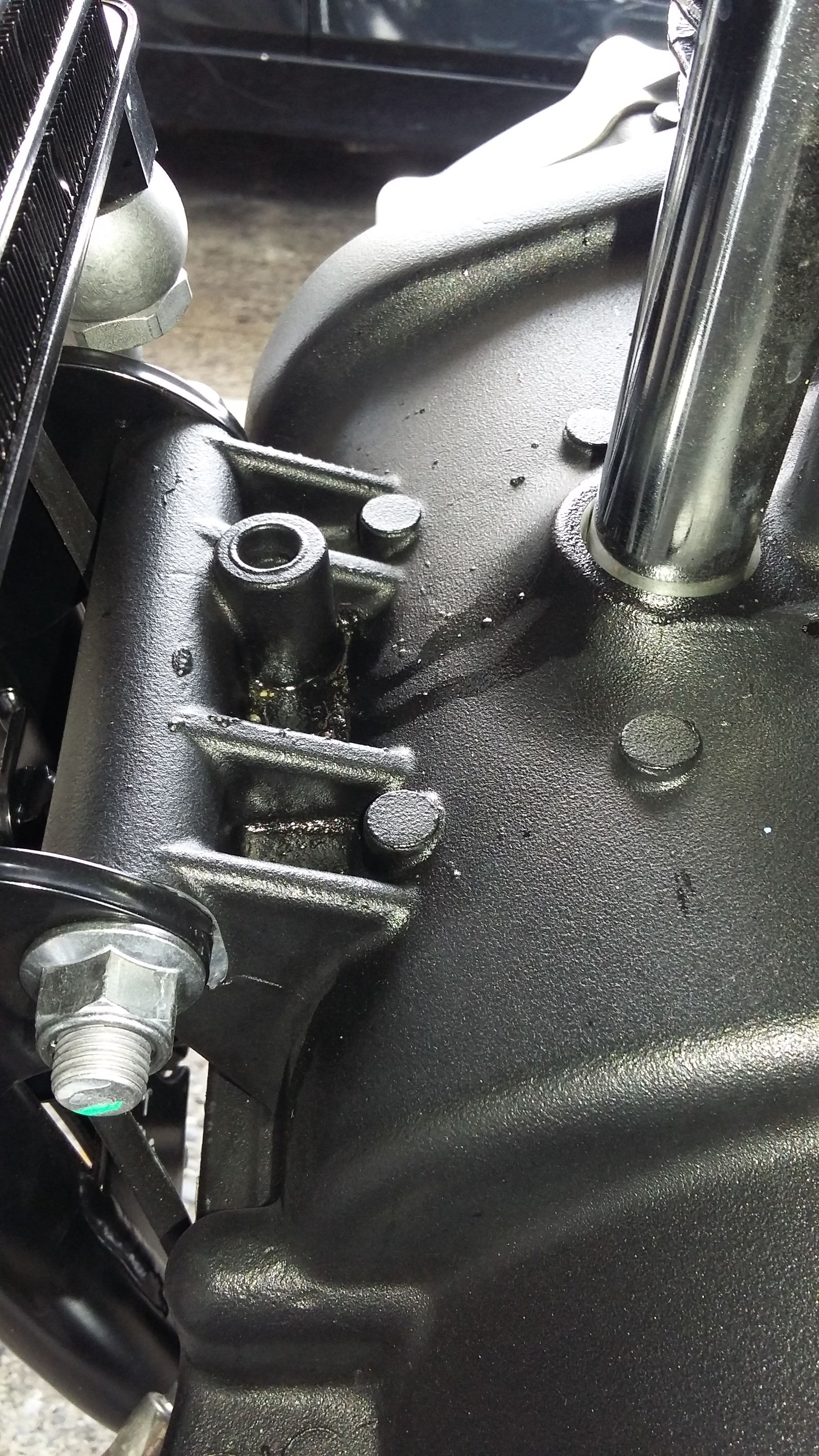

  11. Peter, sorry for the delay. Dealer said it changed the head gasket, but I think that just set. But now this oil leaking from the engine lock - I do not know the name in English.
  12. Peter. See where is the leak. It leaks by this piece chrome and strain the oil through the engine, leaving a puddle in these spaces.

    I think the word you are looking for is cylinder block (just below cylinder head), Is it a Triumph Dealer that is doing work ??

    Can you take a picture a little further away so i can see where this tube is on engine.

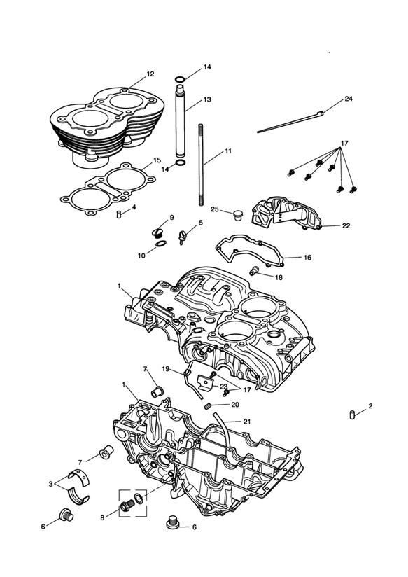

    Here is a breakdown view of whats leaking it a engine breather tube from crankcase to cylinder head, it has seal 100067198-0-2.jpg
  17. Of course. In this photo he is right in front of the engine. My finger points to it.
  18. I believe it is a defect in the number of o'rings - Nº 14. According to the mechanic Dealler.
