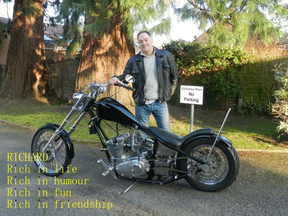

    Hello, my father went off to heaven before his time last year at 55 and I've inherited his t160 chopper. As I don't even have a licence yet I'm planning on storing it for about a year. What precautions should I take to prevent damage from it being idol. Any advice much appreciated

    Sorry about your loss, it would be best to store the bike in a warm dry place if you can. A good clean followed by waxing to protect it, if not you could buy a vacuum bag to put the bike in.
  3. thebiglad
    5,072
    Hi JBaker, condolences on your loss. Losing a parent is a big blow but at least in the future you'll be able to ride your Dad's bike and hopefully bring back good memories.
    Re storage:
    1. Remove the battery and put on a battery tender (keeps the battery in good nick)
    2. Inflate the tyres to 35psi and then put the bike on blocks so both wheels are off the ground;
    3. Give the engine an oil and filter change;
    4. Empty all the fuel out of the tank and carbs to prevent them getting gummed up.
    5. Storage somewhere dry but well ventilated.
    6. As BM suggested give the bike a thorough clean and then wax it. Scottoiler have a spray-on protection product which would be ideal in these circumstances. It's called Scottoiler FS365.
    Now go get your bike license passed, then you can enjoy your Dads gift to you.

    All of the above but if it's going to stand for a while it might be worth taking the spark plugs out and putting a bit of oil on top of the Pistons and kicking her over now and again
    What a classy looking bike!
  8. darkman
    7,658
    Wow that is very trick :)

    Thanks, I have cleaned and polished it each month or so and started it up every 6 to 8 weeks but as it air cooled I didn't leave it running for long.
    It was in my friends workshop where it was easy to work on but after 6 months it started to get in the way of his jap bike projects so I've had to move it somewhere less accessible. Also it only started on two cylinders before firing up the 3rd after about a minute the last time we started it.
