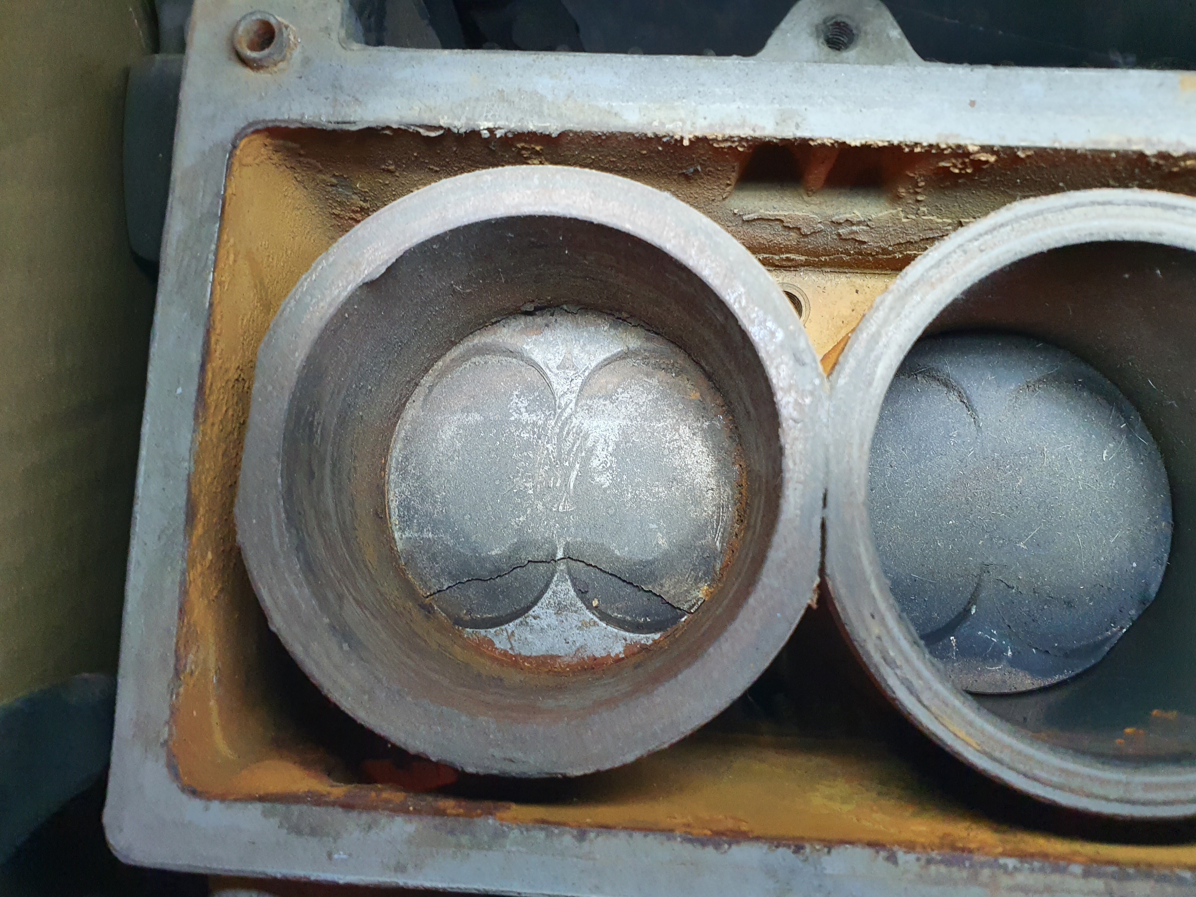

    But I was referring mainly to the engine, the one on my motorcycle is broken.
    I have been looking at the market and I have found a couple of motorcycles for under 2000 euros.

    Ah, OK. Then the engines are, I think, fundamentally the same across the range of 900s (excluding Thunderbirds) except for the Super III. The only outward difference is likely to be whether it's black or silver finished .... it's not 'paint' as such, though, obviously, you could use engine paint to achieve an alternative colour if necessary. At under 2000E you could quite probably get much of that investment back in selling unwanted parts - if they're good enough to sell!!
