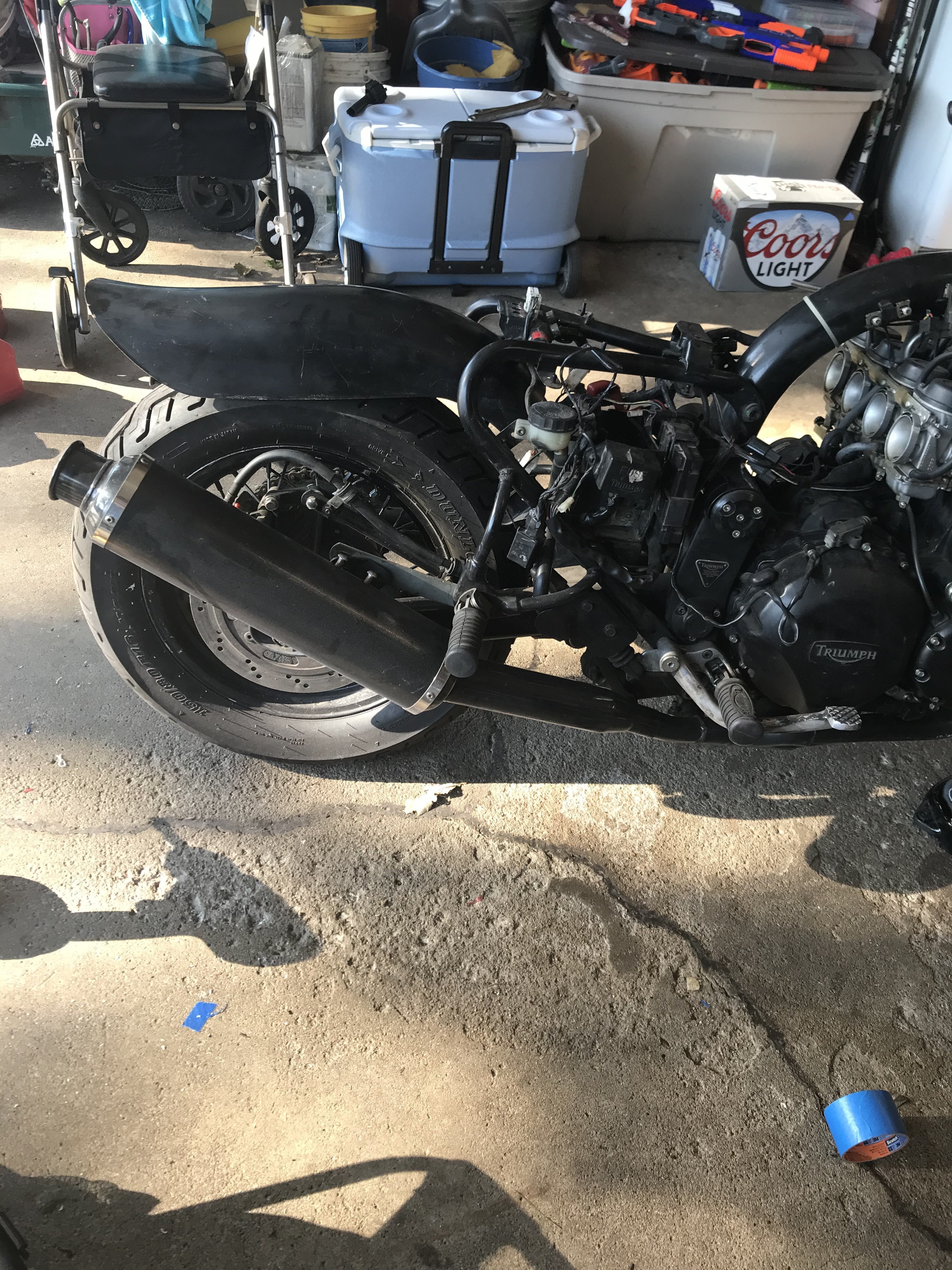

    Found a bobber style rear fender, decided to chop it a bit and test for it before sanding it down to repaint. Thoughts? Supposed to be tighter above the wheel?
  15. Hobnail
    Hobnail Senior Member
    Jan 4, 2020
    1,245
    USA
    Have to check maximum travel on suspension for clearance. Otherwise I think you are golden.
