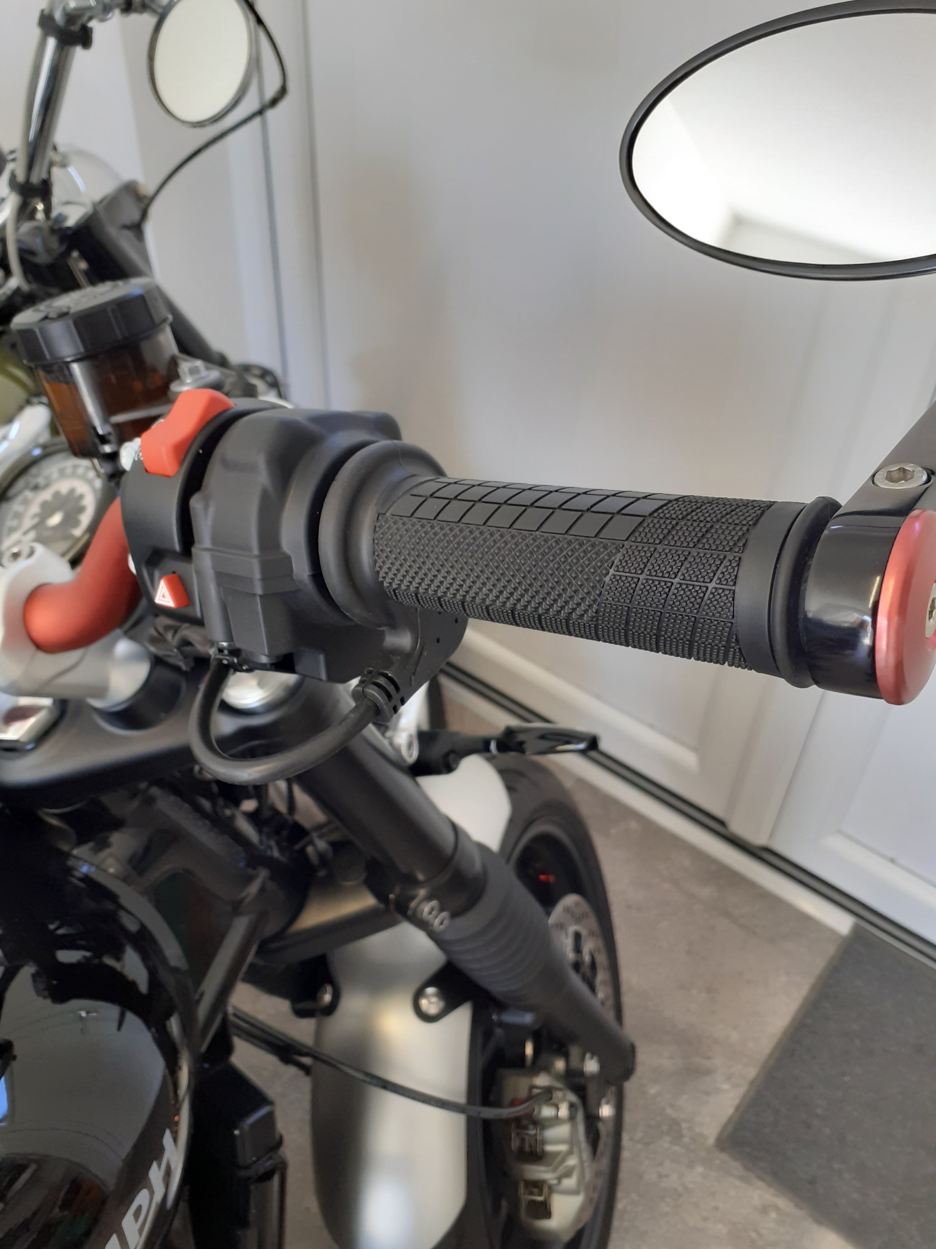

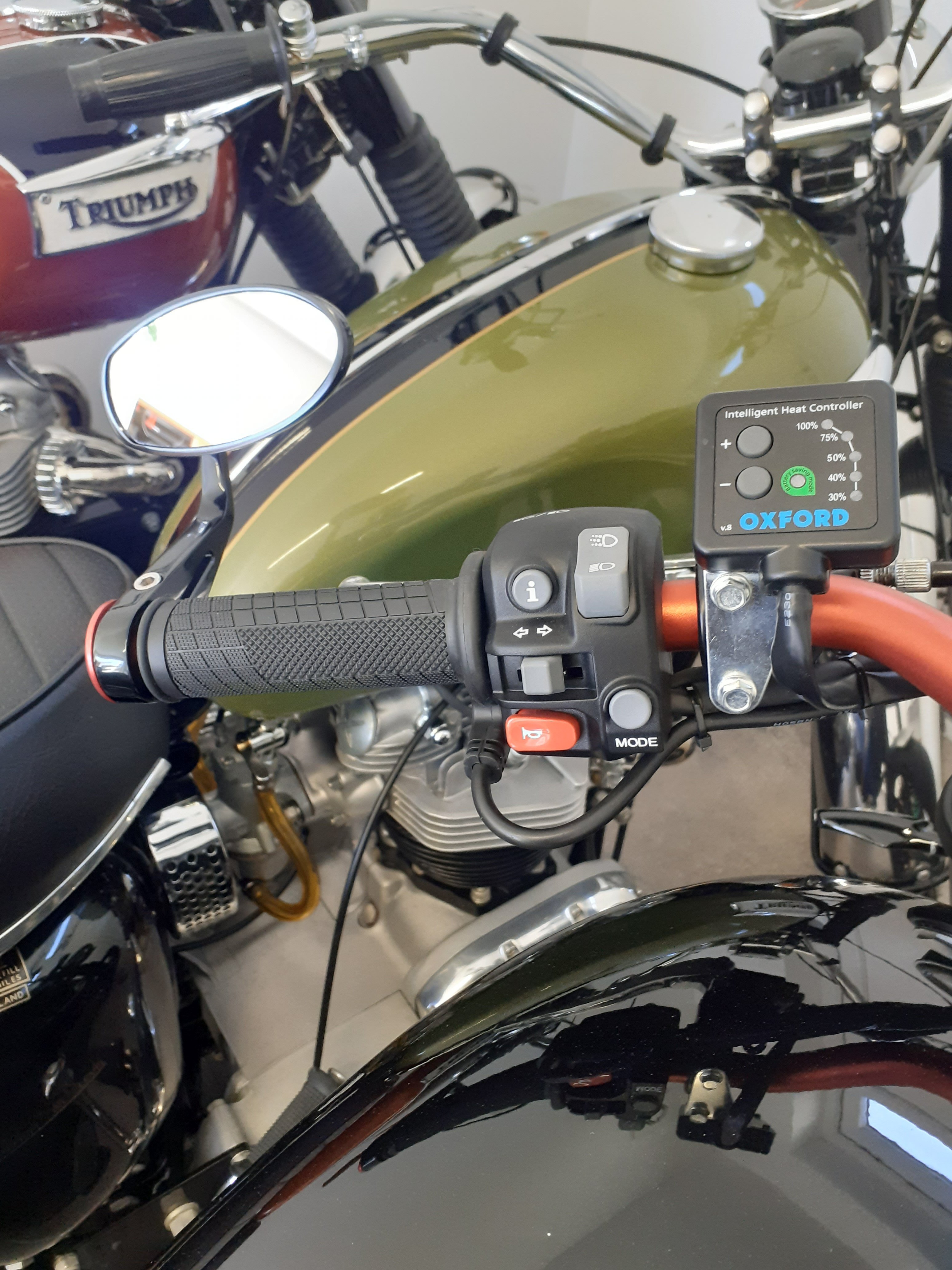

    Fitted both bikes with heated grips today as the cold weather will be here soon :) under 2 hours and just over £80.00 for both, job done.

    I just routed the wires n plugs up under the tank and used that electrical grease in the connectors and secured with cable ties :)

    Which model of grip are they? Seems to be several different ones on their website. :cool:
  10. darkman
    7,648
    Hi Steve, i used the premium touring set based on price and that they were the same length as the original grips as i have wide hands.

    I'd like to get some of these on my bike but with clip-on bars, bar space is non-existent :( Can't think where the controller would go.
  15. darkman
    7,648
    You get a sticky pad to fix it any place like :) No excuse now :)
