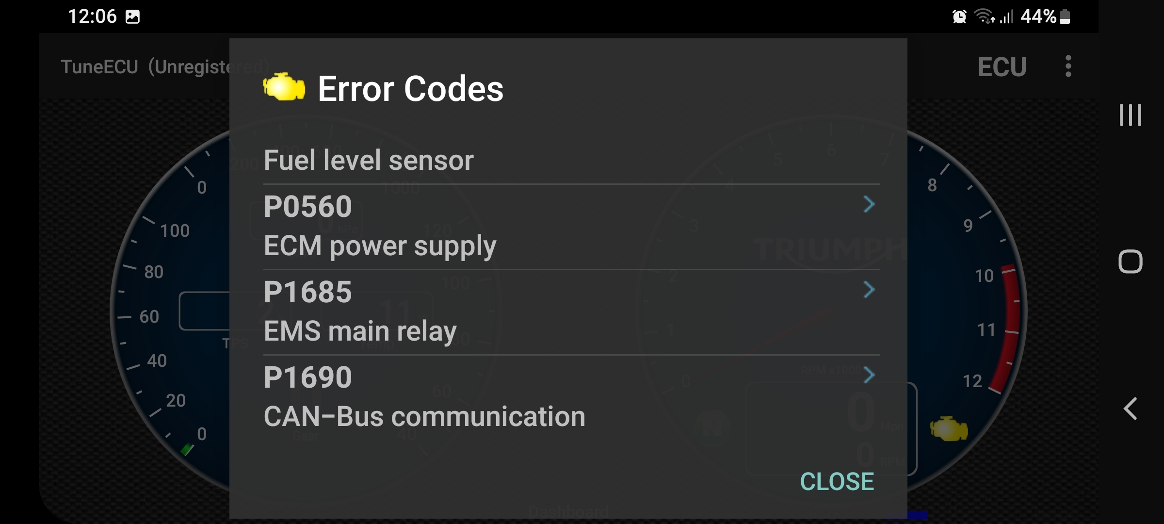

    I would start by checking the EMS (Engine Management System) relay located under the seat alongside the battery.There should be 3 relays together and I think the EMS relay is the outer one opposite the battery negative earth terminal. If this relay is faulty there will be no power to the starter motor.

    Oh man I'm so excited to report IT Starts .
    So I pulled the battery back out to gain access and the ecu fuse supply had broken. Quick job with the iron and she's alive.
    I'm so grateful for every msg from this group as always a little help goes along long way.
