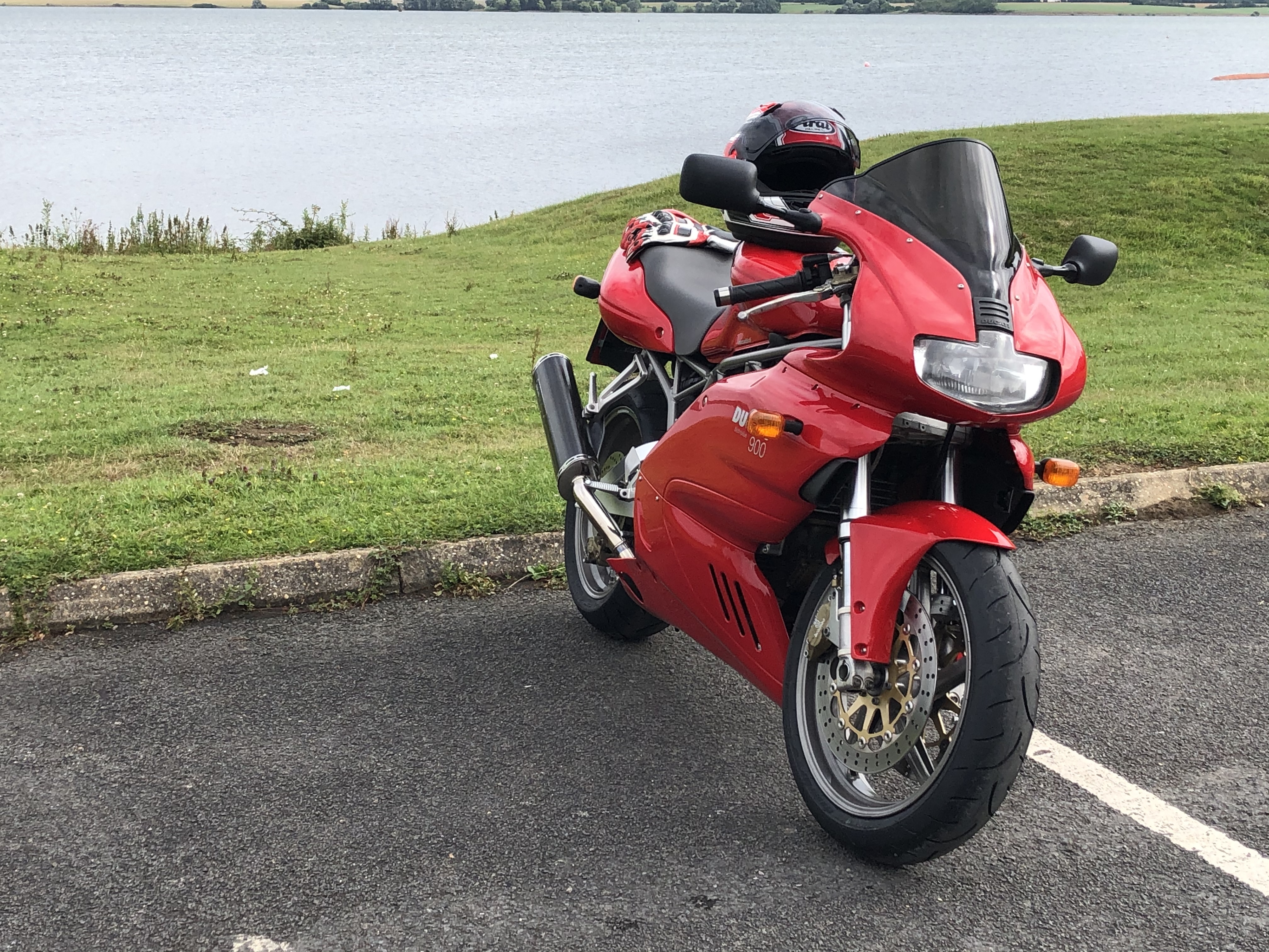

    I have replaced the H4 halogen bulb in my Ducati with a similar unit but because the light source is not as concentrated as in the H4 unit or even in the right place I find that for daytime riding the result is great with a very white light output that is more noticeable than the “warmer” halogen unit. However, when riding at night there is virtually no difference between main and dipped beam. This could be exacerbated by the fact that my head lamp shape is not the traditional circular unit as you can see.
    I have yet to try the OE LED lamps on my Street Triple at night.

    As you can see I don’t have that option as the headlamp lens and shell (reflector) is one piece and not round.
