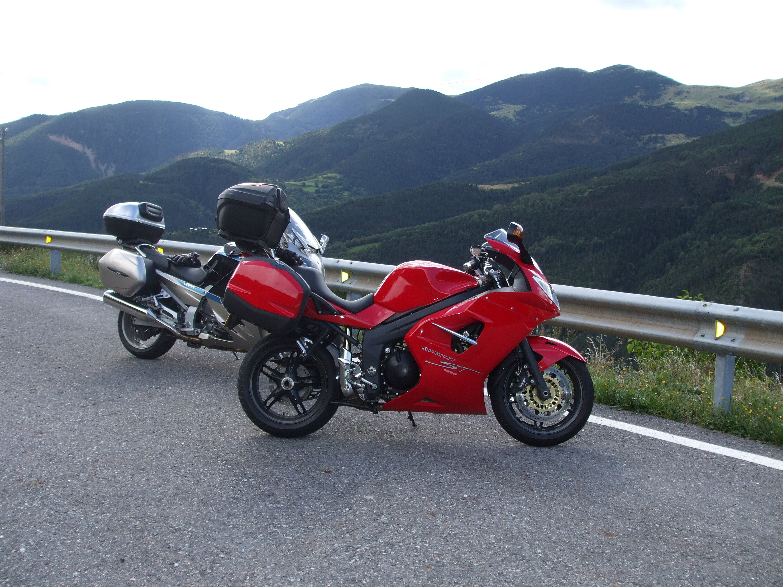

    Not sure if this helps, but I had my seat scooped on my ST. Here is a picture where you may be able to compare the seat hieght/thickness?

    Cheers @Wessa. Good backdrop there too. where was that taken?
  7. Wessa
    11,693
    Pyrenees mate....
